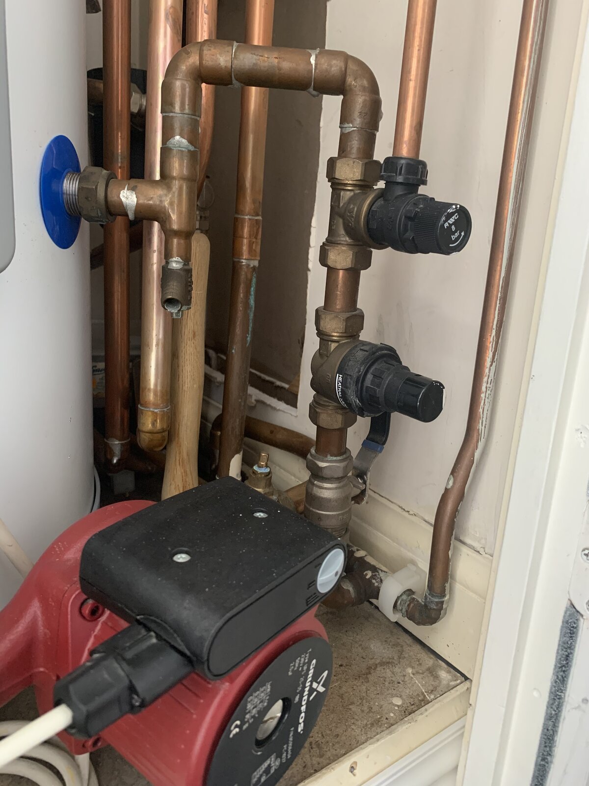

I’d like to carry out maintenance on the combination valve strainer. I’ve seen some videos, but have a question on the low height of combination valve relative to height of the T&P release valve. After draining from the T&P, does it matter that the combination valve is so low? I’m concerned that since it is lower, then water will flow out when I open the valve.
Unvented cylinders are non user serviceable, it needs a qualified engineer to perform any service work. The only work that a user can perform is to replenish the internal bubble if it has one.
I think I'd be more concerned about the D1 pipe from the PRV, I need to check but I certainly wouldn't have it installed rising vertically, if the picture's the right way up?
As Madrab says, you can't service that yourself, you need to be G3 Registered to work on these. The T&P valve should never be used for draining either. Also, it's installed incorrectly - the cold supply pipework needs to be extended up to near the top of the cylinder, and the pressure reducing valve and pressure relief valve fitted up there. It's not permitted to fit the pressure relief valve with the discharge pipe running uphill. I'm sure your G3 engineer will be able to correct this when they carry out the service.

Thanks for calling out the upward pipe direction. Please point out where in the Megaflo doc that says where the mains, PRV and PRV need to be at the top of the cylinder and the reason. Genuinely want to understand.
Back to the original question. If I follow the directions in the Baxi video, is the only water that will spill be from the bit of pipe between the PRV and the shutoff valve right below the combination valve?
Invariably the combination valve is located above the level of the HW outlet, it allows maintenance of the valve and it's components and attachments without the need to drain the cylinder down etc. Not sure it's actually part of the G3 requirements or specified by the installers but it's certainly best practice and promotes energy efficiency and minimises the waste of water etc.
Given where the combi valve is, if the video is followed and drained to the level of the T&P valve then there's still the water from the T&P valve down to the combination valve to go. Depending on what side the NRV is in the combi valve ..... but even then it's not worth the risk ... if the top of that valve is opened then there could be the other half of the cylinder on the floor. That's why the combination valve is best placed at least above the level of the T&P valve, so that's all that's needing drained.
As far as the D1 relief pipe is concerned then again I'm not sure if it's in the regs, when I get back I'll need to check. The whole point of a relief pipe though and the D1/D2 runs is to allow a free and easy path for the vented/relief water to exit and an upwards outlet is certainly not that.

The T&P valve is much higher up on the cylinder, so that isn't sufficient. Without an isolation valve on the cylinder CW inlet, you'd have to use the drain off valve to empty the majority of the cylinder out and then be left with a small amount of water sitting in the pipe above the pressure reducing valve.
As these components are for an unvented cylinder, they fall under the G3 regs. However, if you didnt have an unvented cylinder, a pressure reducing valve, pressure relief valve and expansion vessel would all be perfectly DIY-able.
