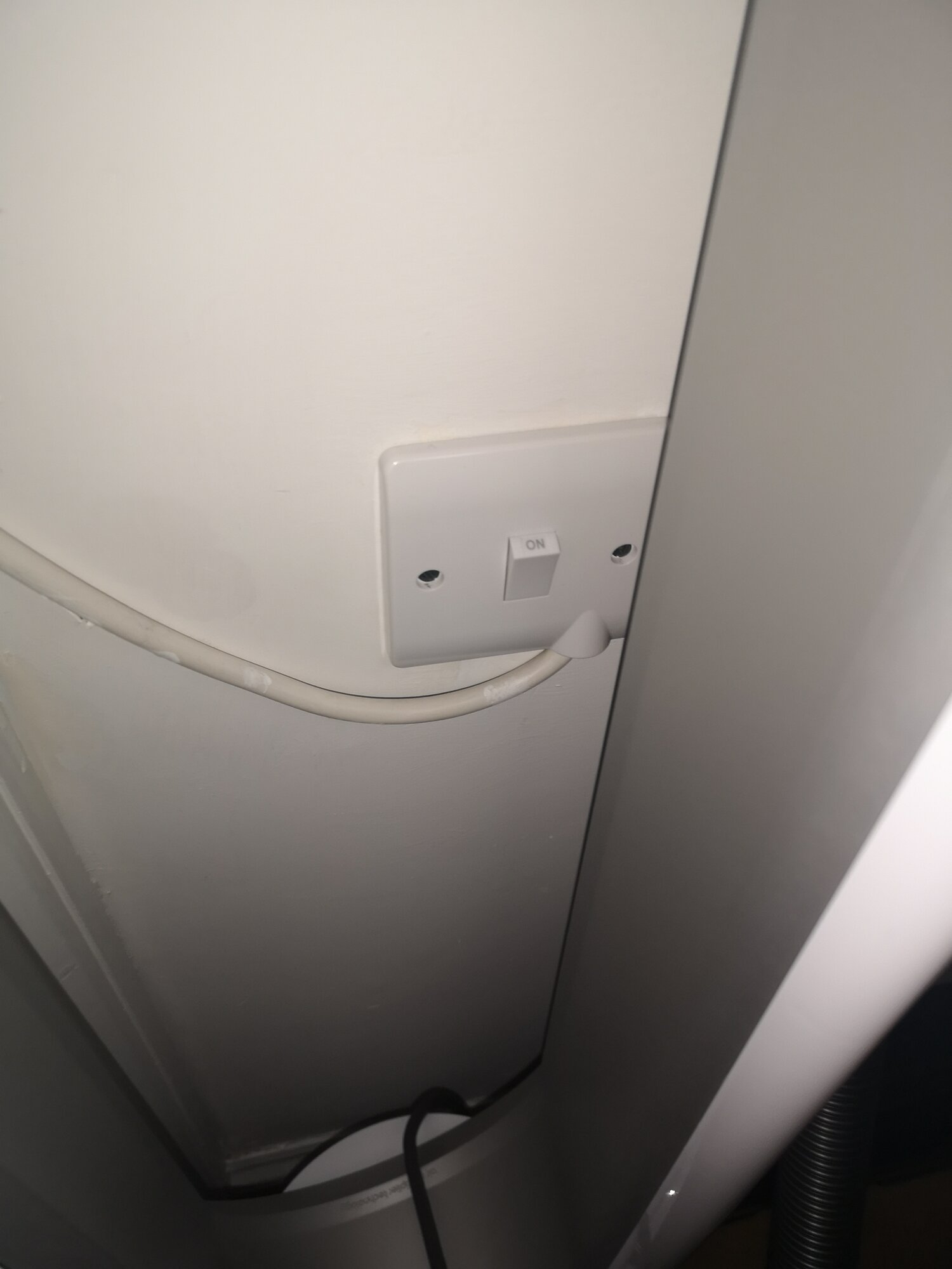

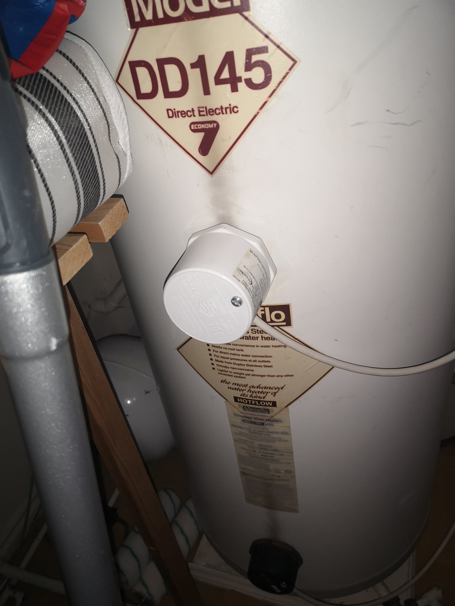

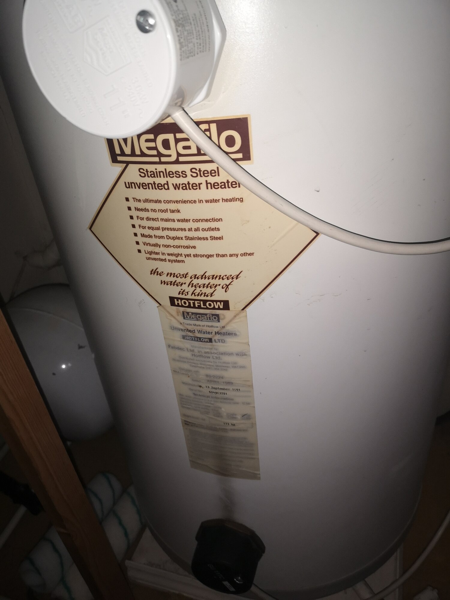

Hey all.
I've just moved into a new flat with economy 7 so we have night storage heaters and a night heating water cylinder. It's 145L, but we only get half, maybe not even that before the water is freezing. The whole tank seems to be heated in the morning as it feels slightly warm on the outside but it will run out very fast, and by the end of the day feels cold other than right at the top. When we have got water it's really hot, so it's definitely heating to hot enough, there just isn't enough of it. It ran out the other day after two extremely shallow baths, as in water just covering legs, and they weren't run really warm either. We hadn't used any other hot water all day purposely to test it. We leave the night heating switch on the whole time, so I know it's heating for the full amount of time every night when we get the off peak rate. We have an immersion boost but that's charged at day rate and we can't afford to run that every day. It's a very old cylinder, over 25 years, but has apparently had the elements changed before. Will Changing them again fix the issue? I can't see how it would because it is heating water, it just seems to heat a bit and not the whole lot for some reason. Does this sound like an element issue?
Please post a photo if the cylinder, and the two cables coming out if the immersion heaters, and the switches or timers that control them. It may be that the lower one is not working.
Sometimes people wire the upper one to the night supply.
A bath holds around 100 litres.
Thanks for replying!
So I'm pretty sure they are wired the right way around. When it is heating overnight I can feel warmth from the cable for the night heating and at the bottom where this cable attaches to the bottom element. When I switch on the day rate immersion I can feel this cable become warm and the area around the top element becoming warm.
I ran the baths probably 1/4 full, so maybe using 20-30L of hot water. I could do this twice and that would be all of it gone. I've just done the same and can feel that about half the tank has gone cold now but there's no way I used half of a 145l tank.
Sorry meant to add - there's no timer. With the night heating switch on it automatically just heats during the economy 7 off peak hours, something like 1am-6am.
