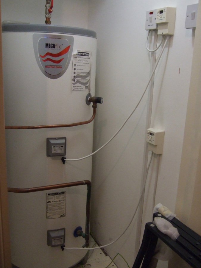

Heatrae Megaflo type with 2 heater elements and 2 separate programmers. After a thunderstorm (coincidence?) last week the megaflo water heater stopped working. The circuit breaker did not trip out but the light has gone out on the 20A water heater switch. However the lights are on on both of the programmers. I tried putting the programmers to boost but not working. Could you please suggest what I should check first? I am a careful DIY'er and am particularly cautious around electricity! Many thanks.

The first thing to check with a Megaflo is that the thermal trip in the thermostat head hasn't activated.
You need to turn off the juice, remove the cover and see if a small pin is sticking out of the thermostat. If it is, reset and turn the temp knob down slightly.
Failing that you need to measure the impedance of each immersion element, across the spade connections, with the power disconnected. You should be looking for around 20 Ohms. If it is greatly higher or lower, you will need a new element. Often one element goes open circuit, and it is not noticed until No2 goes. The bottom one is normally on the cheap tariff.

Thanks to everyone for helpful advice. Update - I finally got to check the system. There is power at the switch and to both controllers. The thermal cut out had popped on the top thermostat. I pushed it in and lowered the thermostat a bit as suggested. The body of the thermostat got hot, as did the wiring to the timer, but the immersion was not working/heating water. Checked both immersions and they both measure about 19 ohms across the terminals. It seems both thermostats are defective. When I put both on boost, there was no water heating from either immersion. I presume I should change both thermostats.

The supplier only sent one thermostat instead of two. I fitted it to the lower immersion. Water did not heat. I noticed that the wiring from the fused switch to the immersion was warm. Half an hour later the switch was almost too hot to touch. I checked the wiring inside the switch and that all looked good, no loose connections or signs of hot spots. So I've left it with the circuit breaker switched off.
Tested immersion heater impedance and it was 19 ohms, to both immersions.

There is 240 volts at the immersion but it doesn't seem to be working. The thermostat is the new one, and the button is in. I couldn't wait any longer for the element to heat as the switch was very hot after just half an hour!
The end of the live cable at the thermostat end was heat damaged, so I cut that bit off before connecting it up. There was no sign of heat damage in the switch, and all connections were tight inside the switch.
The only way the switch can be getting that hot is if either the contacts have had it or the wiring connections are loose/not properly made.
Conclusion: Had to get a Megaflo engineer in. Both thermostats were faulty and the immersion elements were heavily scaled. Once they were de-scaled they worked properly and no more over-heating of the wiring. Incidentally the cables to the switches were replaced with silicon cabling which apparently is what should be fitted to these units.
