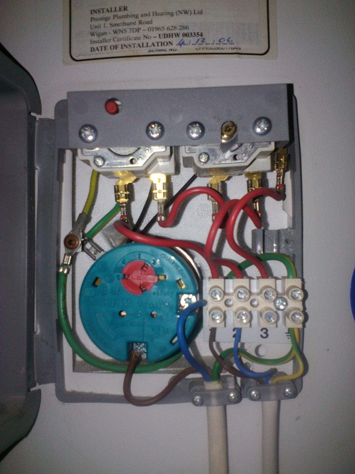

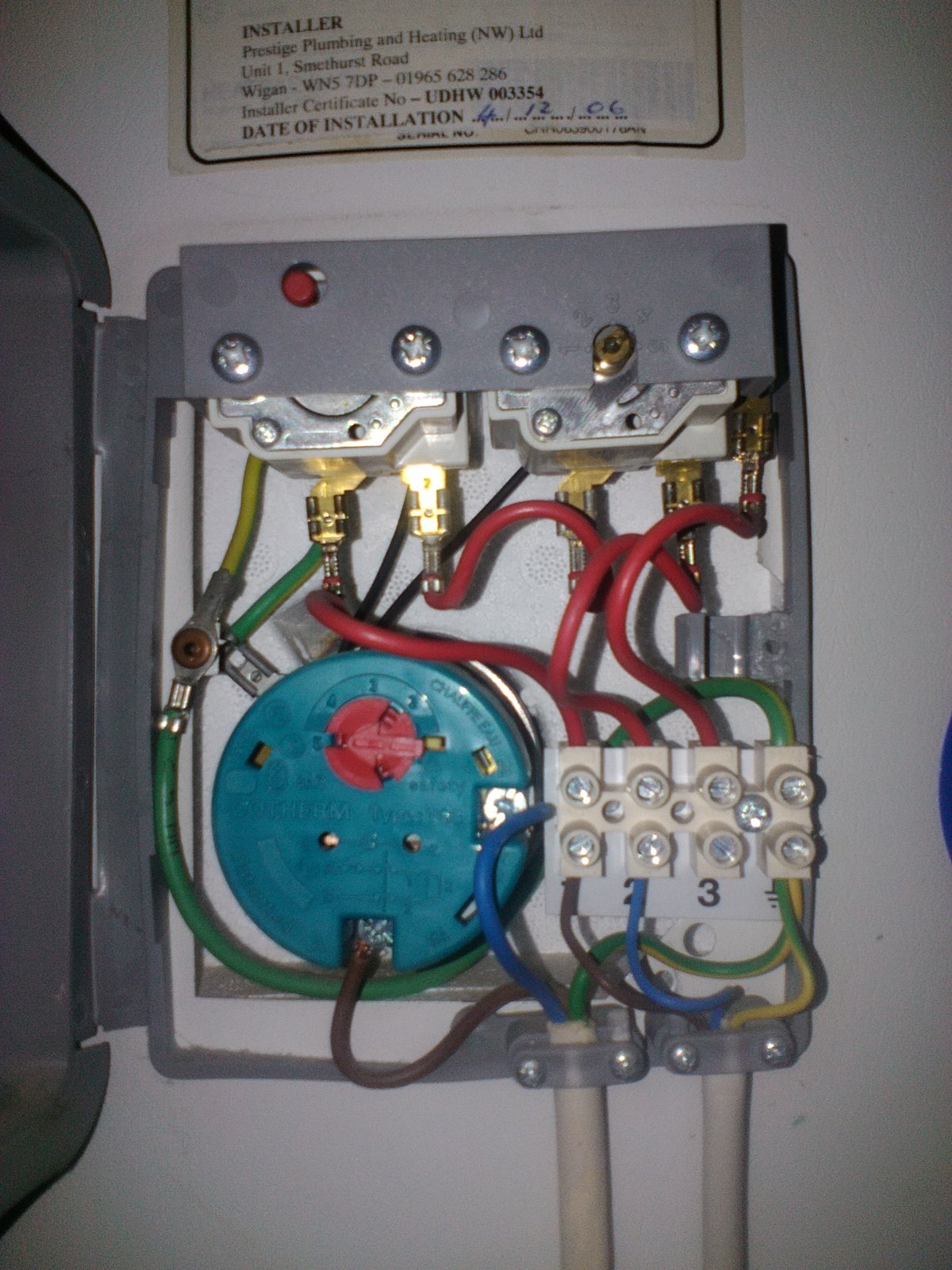

I also have this problem. There seems to be two dials 1-5 which controls the temp?
The red dial controls the electric immersion heater, the brass one the temperature when heated from your boiler.
You don't often need them above 3 in either case. The immersion is usually dearer to run and slower to heat. Best to use your boiler.
The immersion is handy as a back-up option if the boiler fails.
