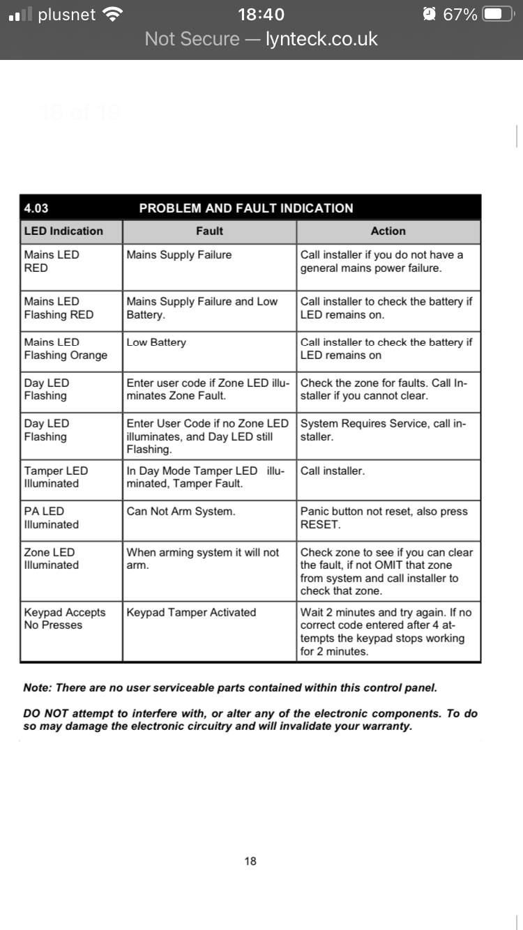

I have moved into a new house had to do electric work turned of electric know my melcom st6100 alarm is flashing mains supply failure flashing orange
How to fix ? Please
Do I need a engineer I only turned the electronic of and it does look like the battery needs changing
Changed 2014 ?
From the information sparky posted,then you need a new battery.
If you feel confident you could change it yourself, open control panel,disconnect battery spade connectors, fit new battery to spade connectors, close panel code and reset.
