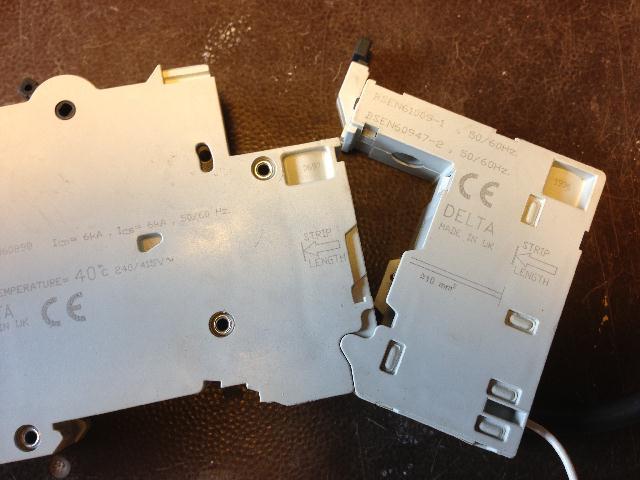

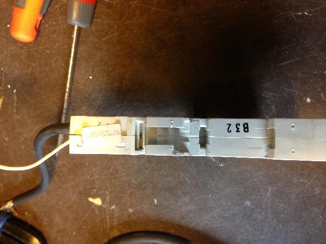

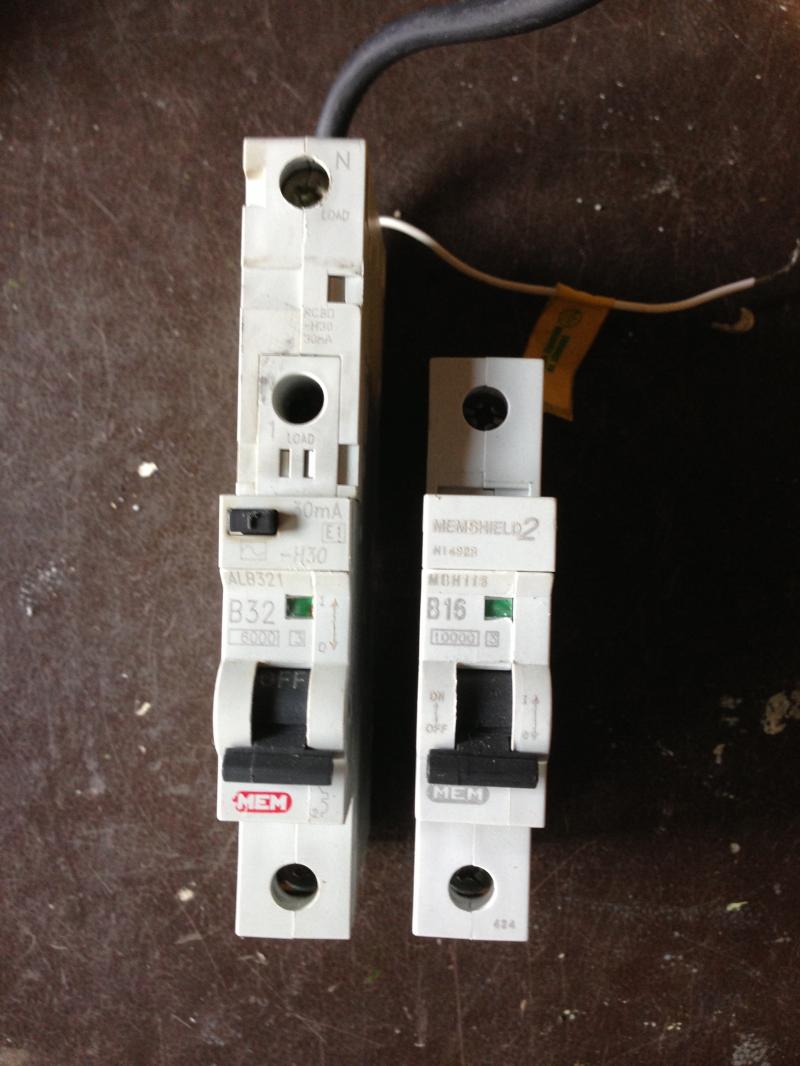

Hi, I have acquired the following two units and want to swop the pod from the B32 to B16:
I'm not wanting to break anything so am after some advice on how to go about removing the pod from the B32.
I have read this old thread //www.diynot.com/forums/viewtopic.php?p=355536#355536 which helps a bit but does anyone have any photos of how the shoulder bit holds it on?
Cheers
Peel of the plastic around the test button - there is a grove for your flat blade to prize it off. Do the same with the non RCBO one.
Remove the rear black din rail clips by gently tapping them at the top until they vanish into the MCB, you can then pull them out the middle.
Re-assemble in the reverse order.

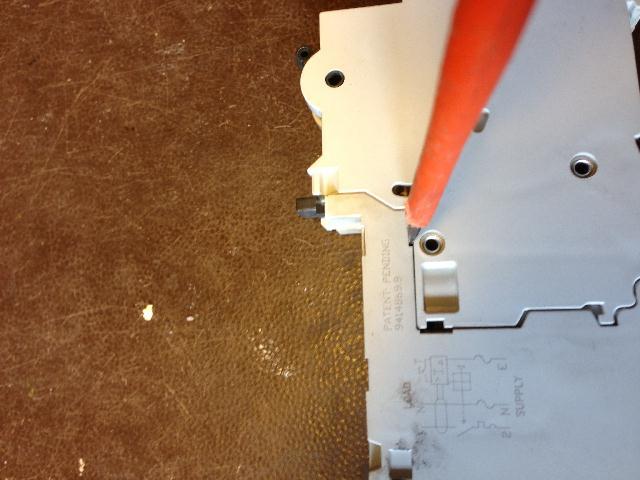

Removal of the DIN clip
Test button with cover on
Test button cover removed
Insert screw driver into slot, one on either side
Voila!!
