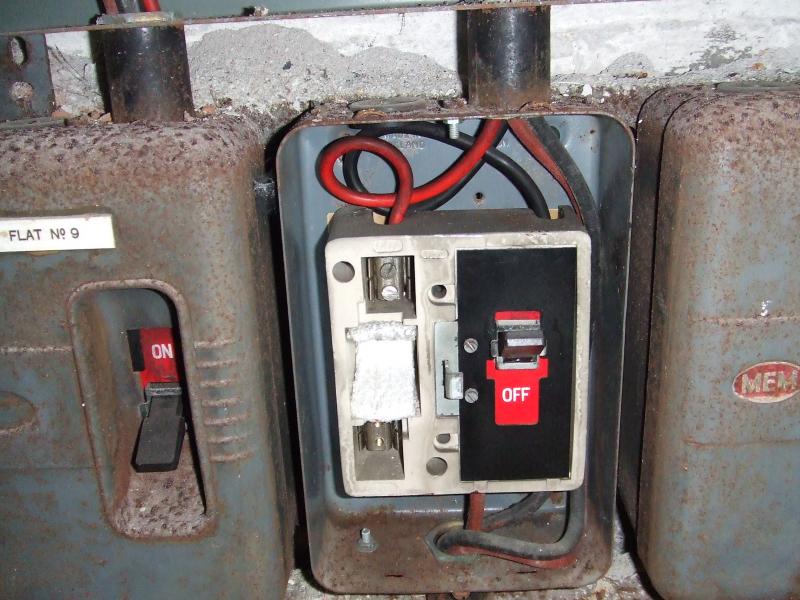

MEM switch fuse asbestos??
Yep-asbestos flash pad. You wouldn't want to pull them out regularly as some exposure may occur. Do not treat exposure to asbestos lightly !
It more than likely will be. You should certainly treat it as though it is.
Yes, it is a low-risk, coated, non-'flakey' asbestos mat - and pulling the fuse isn't likely to 'disturb' it.
