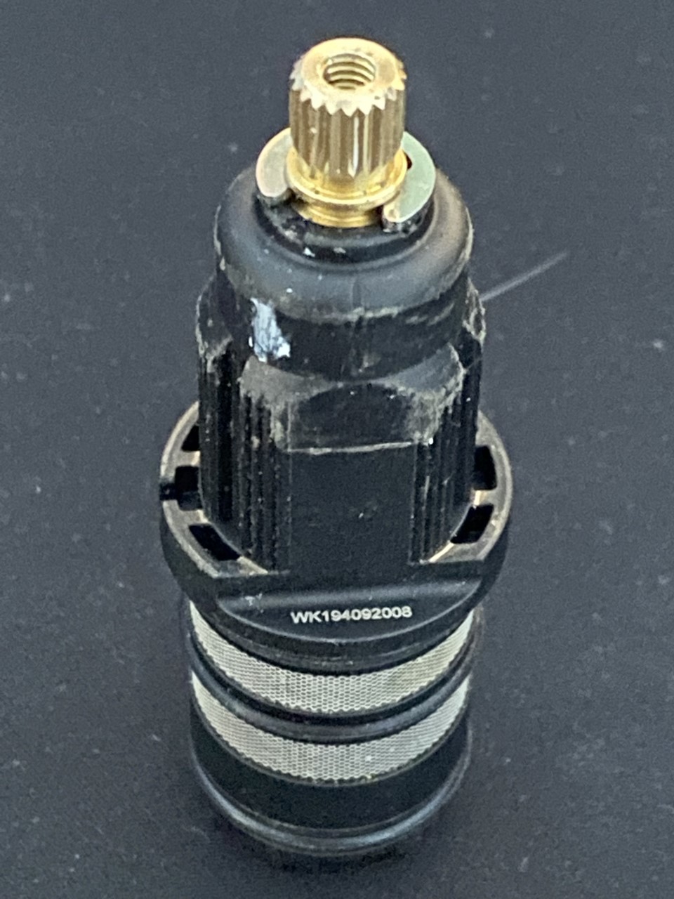

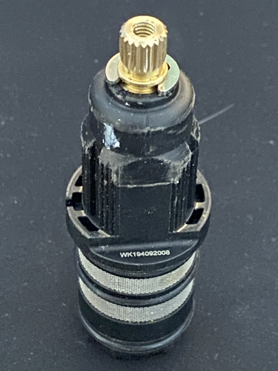

Merrano Square shower bar from Plumb world (Mrs wanted it) Was running tepid after 12 months. You can remove the brass collar using a pair of needle nose pliers. Nearest online picture to the one out of mine is the Vado V-001 (slight difference though as the one I have has a plastic nut on the back end, the Vado doesn't appear to have it.
. Since taking it apart and reinstalling it the shower warms up but its goes from tepid to too hot within a mm of adjustment and is almost impossible to calibrate. Still trying to find a replacement. If anyone can identify the attached picture. The WK number on it doesn't bring up any results either.
