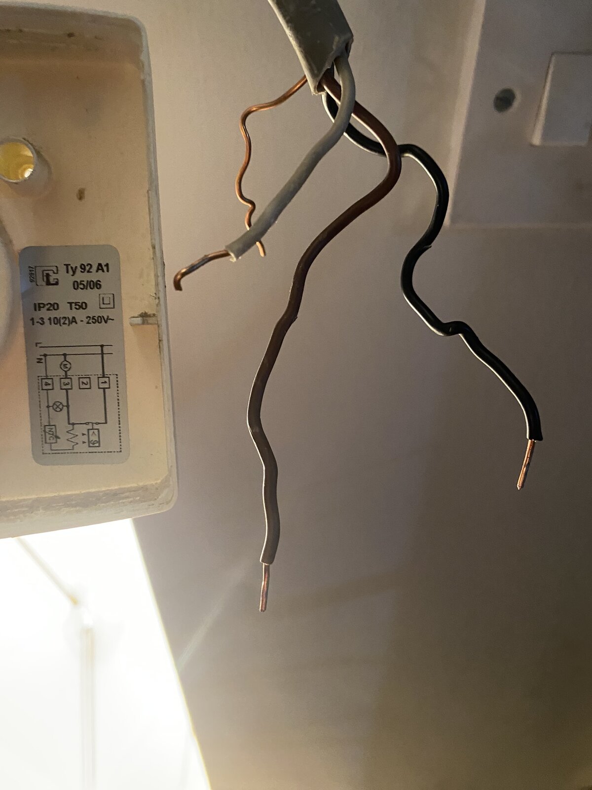

Hi all, I have been through the other posts on this but they don't appear to be resolving for me. I have purchased the Meross MTS200 thermostat and connected, but it does not switch the heating off. The boiler remains on constant, supplying heat. Does anyone have a thought as to why this may not be switching off?

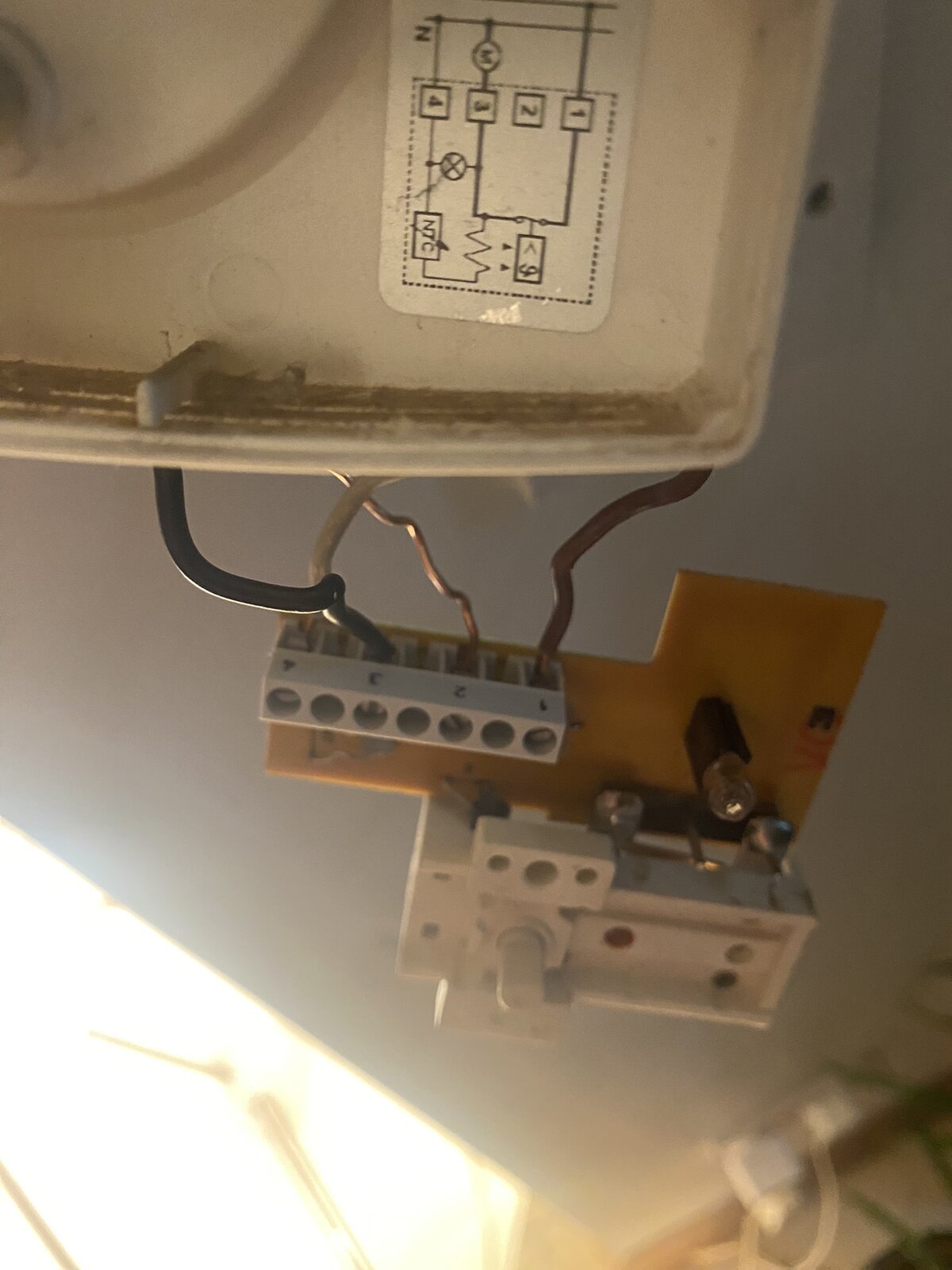

This is my old thermostat with a wiring diagram.
Showing it connected and this works as expected.

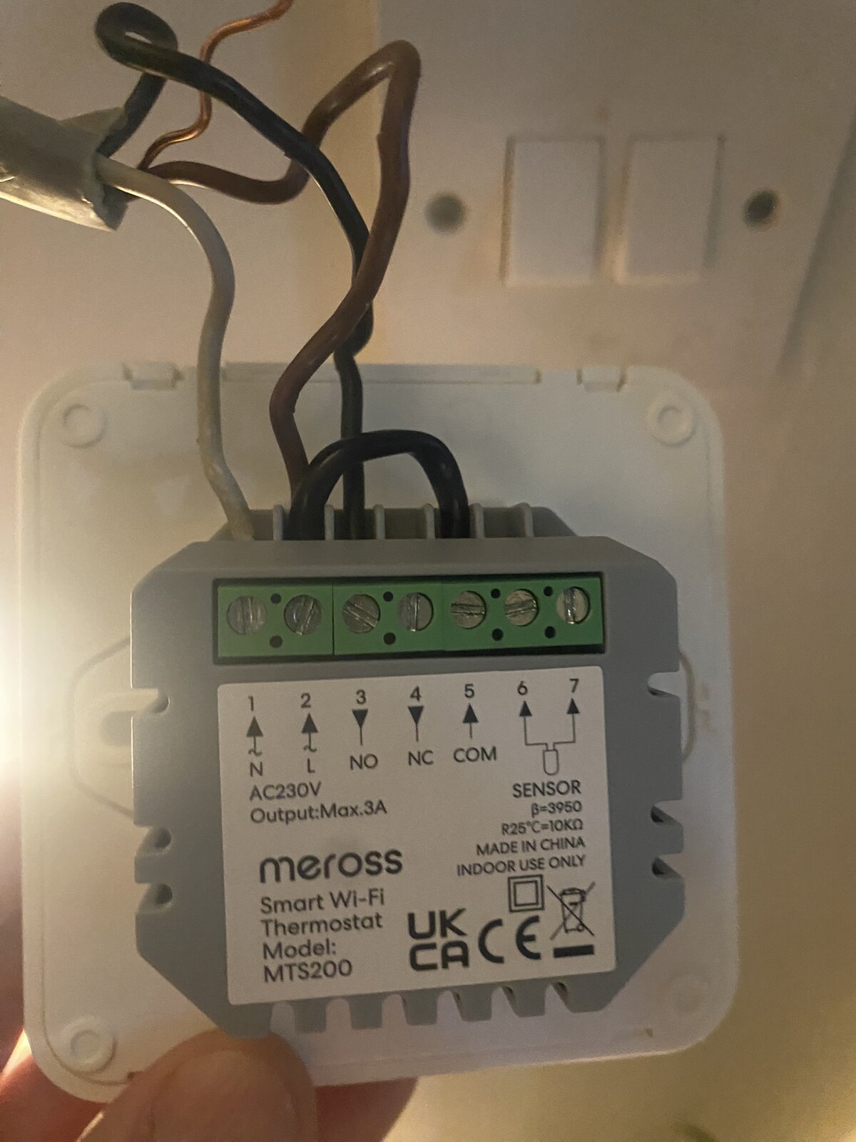

And the Meross effort.
I have tested this with and without the bridge from com
Any thoughts would be helpful! Cheers....
Thanks for getting back! If I remove the black wire from NO, the thermostat no longer powers up.
I wonder if Live and Switched are the wrong way around. Try black wire in L and brown in NO.
Sorry @EFLImpudence my mistake. There is power to the thermostat with just L & N connected. I did not connect N correctly when testing. Been back and forth with this a lot so missed that. The heating is still constantly on with just L & N connected. Cheers!

For sanity's sake, I wired the old thermostat back up and works as expected. Turn the temp down, boiler off.
You seem to be without any sensor connected to pins 6 and 7. It suggests the component needed is a thermistor, specced to be 10K Ohm at 25C.
Thanks, I have tested this with and without seeing the same outcome. My understanding is that it is optional though.
From the Meross site:
you can use the internal sensor to control the temperature and the external sensor to do the floor overheating protection(optional)

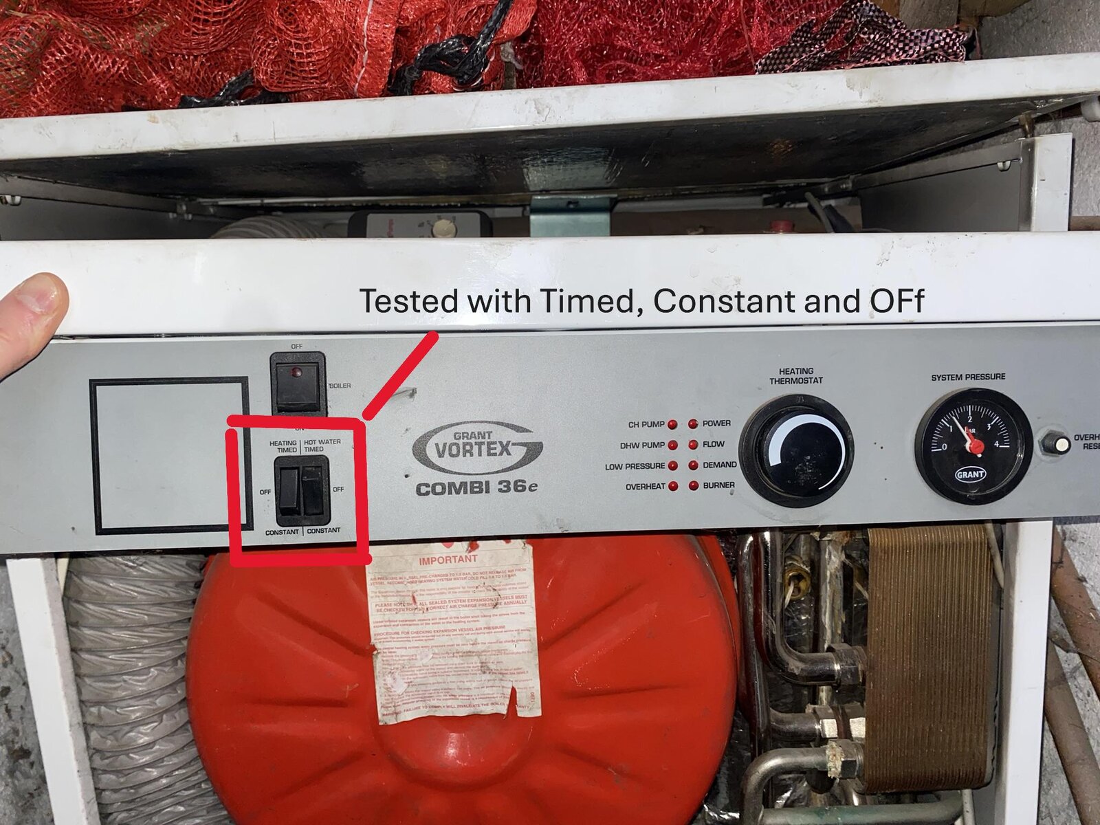

This is the boiler.

Do you have two blacks?
Anyway none of this explains why the boiler works with one thermostat and not the other.
All both of the thermostats do is connect the brown and black for heat.
