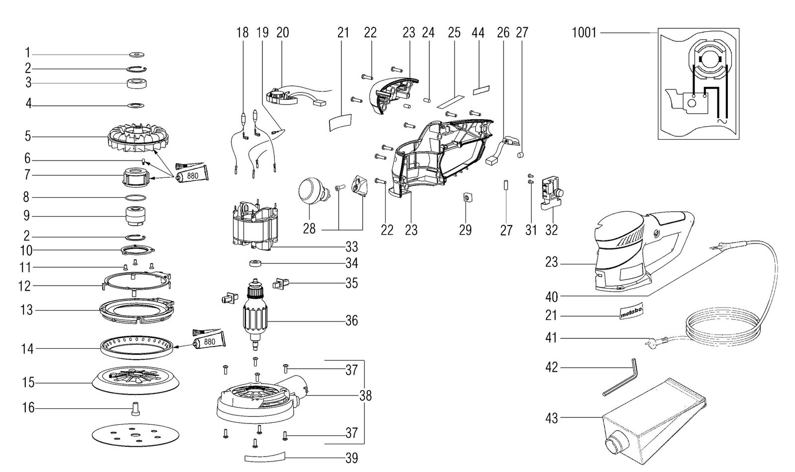

I bought my Metabo SXE450 orbital sander (240v) about a year ago second hand.
I'd like to keep it going because that's why I buy good quality tools, you can get parts.
Last used to sand for a couple of hours but next day it was not starting.
So when I press the power button it sometimes works. There is also power level dial and a Turbo switch for increased power. Testing involves moving all these switches to get some life but it's not clear if it's having any effect.
My question is ... is it likely to just be the main power switch button, how can I test to isolate a problem. A switch is about £10 which I'm happy to buy and change but I'd be interested to get some advice from others.
Haven't had time to open it up to try a contact cleaner, I only dismantled the lower sanding housing to clear it up and change the pad when I bought it.
Advice much appreciated though

The date of manufacture should be on the rating plate somewhere (it became mandatory about 20 years ago - and the tool isn't that old unless it's an SXE450 Duo as opposed to the SXE450 TurboTec). These are fairly heavy duty tools, so I'd tend to go looking at the easy fixes first, i.e plug, flex (particularly the ends), brushes, muck inside the casing, etc before anything else. If it is the switch then it will be a fairly inexpensive part (part 32, circa £11) as it isn't a slider type variable spreed switch like you have in a cordless drill (and which tend to cost in the £40 to £50 range) just an on-off type - the speed control is done by the rotary speed unit (part 20, circa £30).

Cheers Guys
Made 2017, (TurboTec) used by me less than a year I'd say and not very much.
Yes that was the site I was thinking to get parts, looked best.
When I get a mo, I'll investigate those flex ends, and dismantle to check the brushes and look for signs of gunk.
