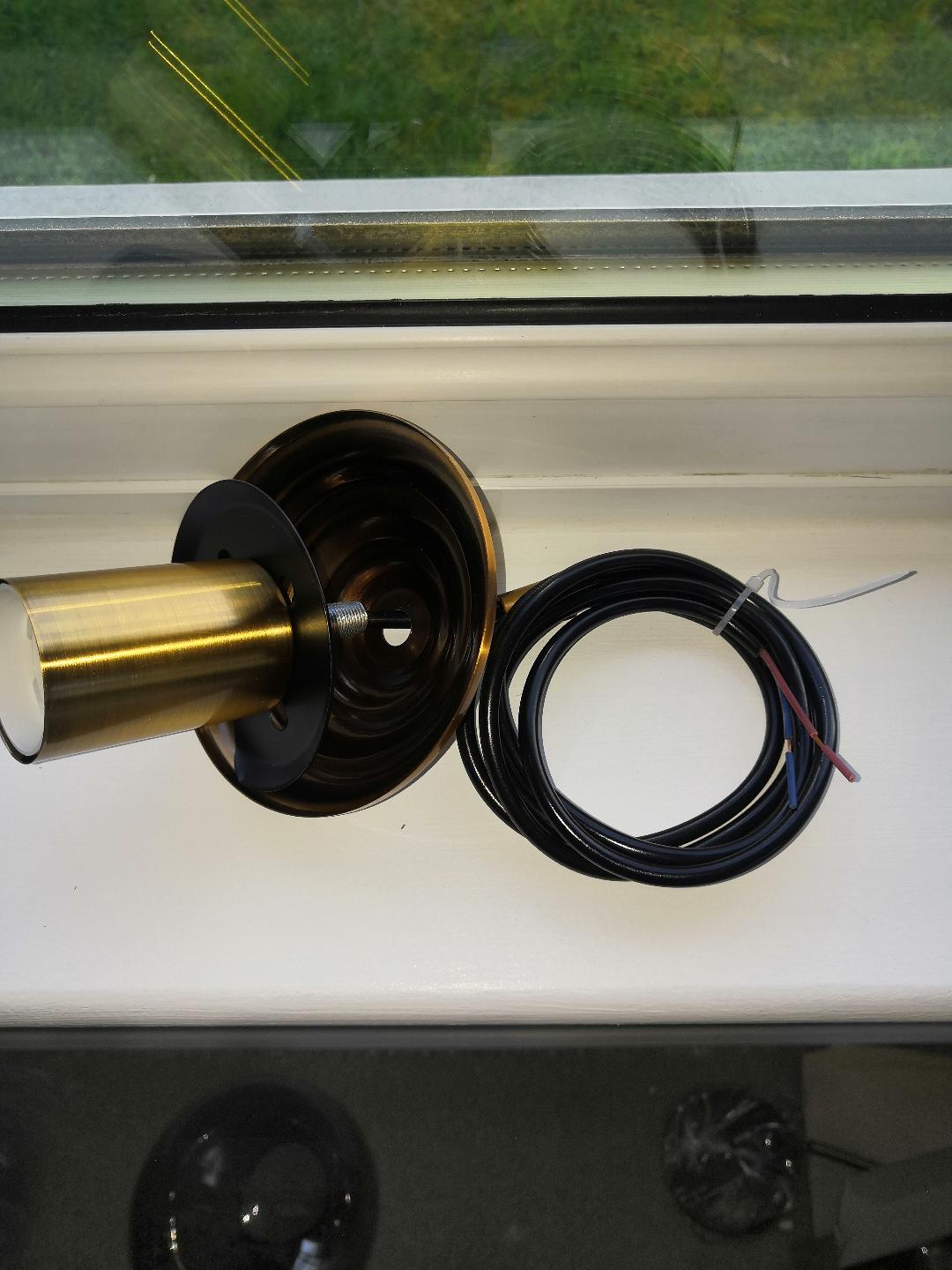

I've some hall lights to fit, with live and neutral only. They don't indicate they're double insulated. Should I connect an eyelight on the existing earth (which is blanked off in the old plastic bayonet terminal block) and attach to the new metal bayonet's ceiling fitting screw? Or just blank it off as before?

A bit worrying that they don’t say if they are class 2
Nothing on the box or instructions?
What does the connection block look like? Is it in an enclosure?
Does the light fitting have single insulated unsheathed wires? Or are they insulated and sheathed?

Just two core cable from the bulb fitting which can be cut to suit the 'drop' of the lamp.

Can we have a picture?
Do I take it that it came with that 2-core cable connected to it?
Are there no markings (symbols or words)anywhere on the fitting? If they are,could we see a photo of them?
Yes, cable's wired to light fitting and no markings anywhere.
Hmmm. The fitted 2-core cable implies (should mean !) that it is Class II - but if it were, it would/should bear a Class II symbol.
