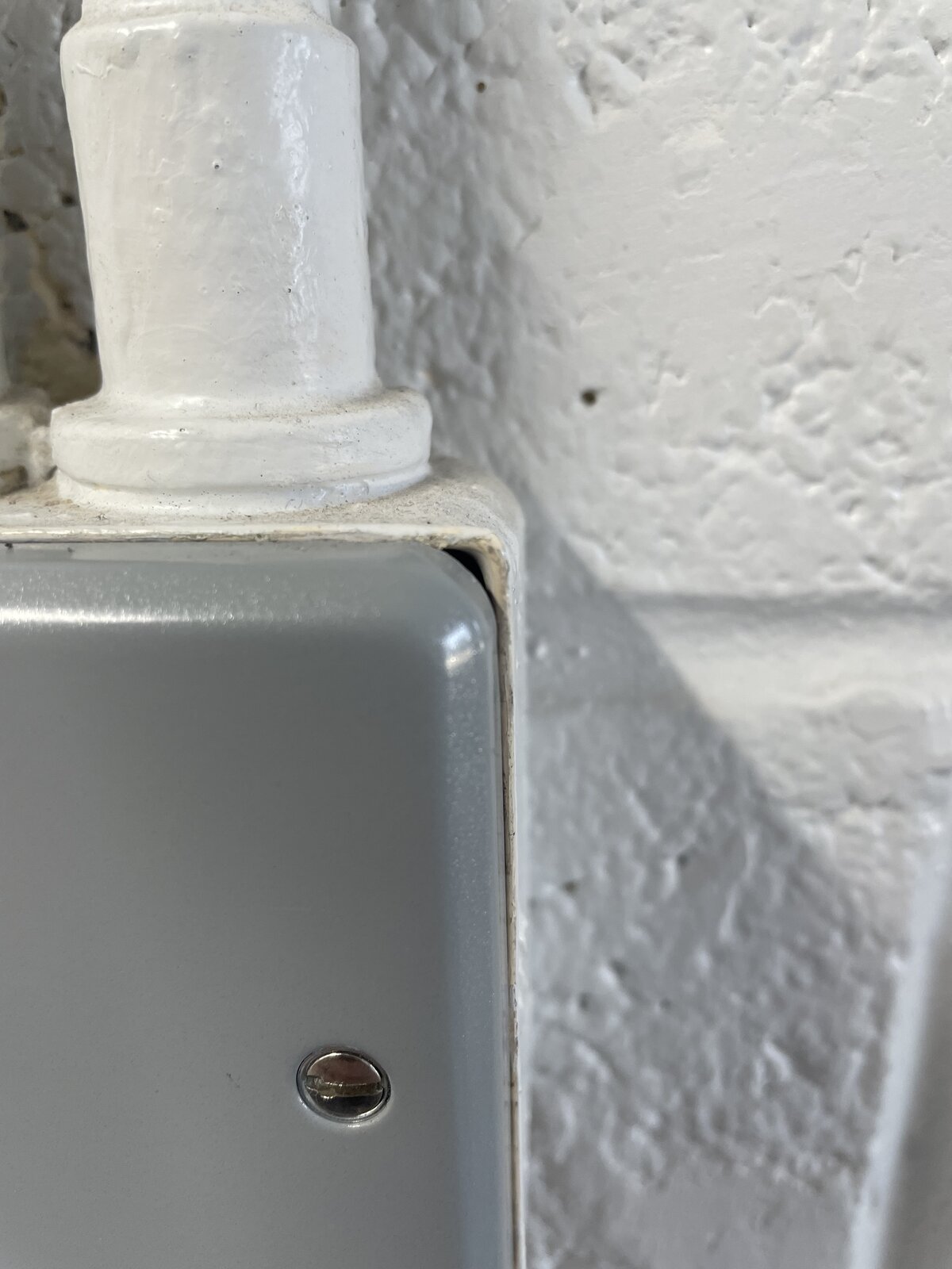

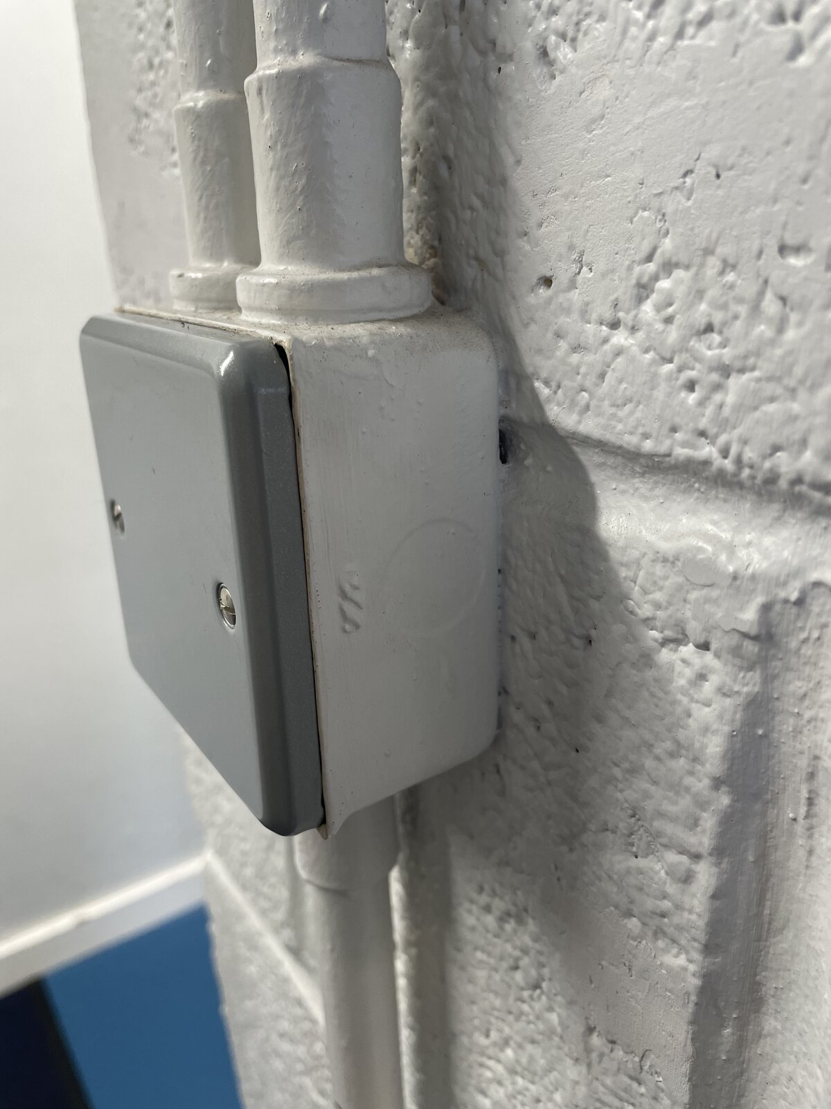

I’m trying to source a metal clad back box with square corners to mount a fire alarm call point on in a steel conduit installation.
As you can see it looks a bit rubbish on a box with round corners, especially an MK box with the flanged lip.
Something like this box with it’s squared corners would be ideal but I’ve drawn a blank of where to source one from.
EC69F6AA-A6B5-45BA-A817-B122A2AAD448.jpeg 349DD97A-4FEE-46FF-8390-D6FE31DDE40C.jpeg

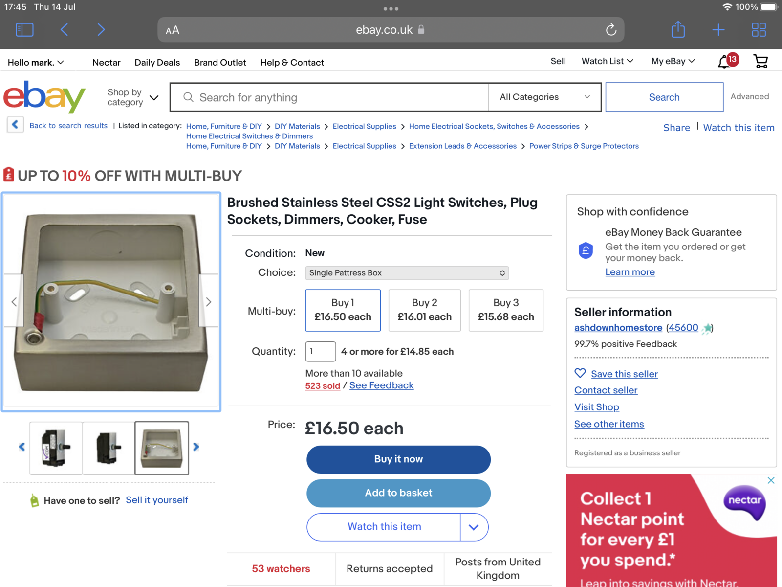

Square corners, stainless steel, priced accordingly.
Almost as expensive as the stainless one....
