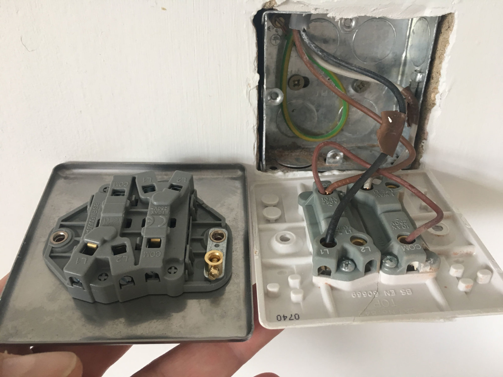

I'm just about to swap out the old plastic switch here for a new metal one.
Could someone please confirm that I need to run an additional earth lead from the switch to the back box, which is already earthed. See pic.
I've seen other posts but I really want to be completely sure before I do this! And I promise to switch off power at the CU before fitting it! :)
Thanks in advance, MM
You could do that - or connect the existing earth wire to the switch.
Ok thanks for the reply - but don't I need to ensure a proper earth from switch to back box, rather than just rely on the two screws earthing the whole lot? I guess I'm looking for a definitive "do it this way" kind of advice!
It is not a requirement to also earth the back box but a lot of people like to do it so it is up to you.
The only definitive thing is the metal switch must be earthed.

Connect the earth conductors to the switch plate earth terminal ,and add a flying earth link from that terminal to the galvanized back box earth terminal as well. Current regulations don't require the link to the galvanized box ,if it has a fixed lug and metal screws. But previous regs did ,and most sparks that I work with still do it the former way ,I guess old habits die hard !!!

I think you will struggle to find a regulation which states that because there isn't one.
The fact is that a buried back-box is not an exposed-conductive part and so does not require earthing.
