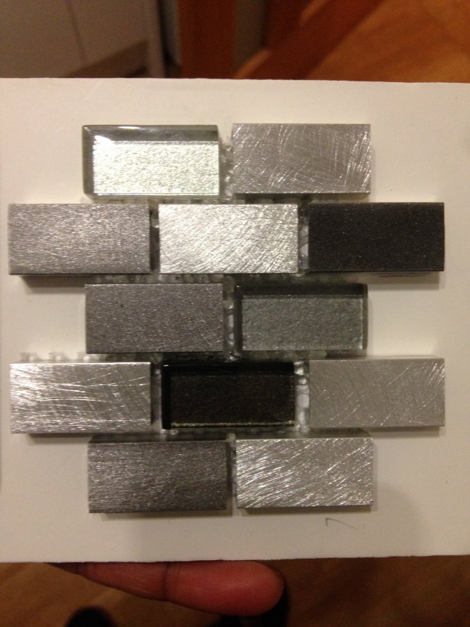

Hello,
Never attempted a mosaic before, so thought I'd seek some advice. Only having used mosaic in the regular tile format (same as tiles, but patterned) around the house, I fancy a go at a "proper" mosaic stripe and column in the bathroom. I've really gone in at the deep end with my first attempt! The metal bricks are not capped tile pieces, but actual solid aluminum section that have been polished. Here's what a sample looks like:
What I planned to do was create an empty space/strip of 10cm between the regular tiles (400X150 stacked white gloss 10mm thick) and edge with metal trim. Once tiling is complete, then fix the mosaic (8mm thick) into the space.
I need to make list of things I'll need (adhesive, grout etc) in order to get the best results I can (for a novice!) I thought I could use a metal cutting blade in a grinder to cut any sections, but unsure about glass, so trying to avoid cuts.
As I'll be doing it myself I don't mind spending a bit extra on materials if I get a better result and make the job a bit easier. Any help or advice would be appreciated.

Again, Lee has it right. Beava Mesh seems to be the most common knocking about.
As per cutting, I would cut the glass with a good glass blade and possibly look at using the hacksaw for the metal depending on how well it would finish up. If tiling vertically then the hacksaws rough cuts would hide at the top. But I'm not entirely sure whether that would be ideal. @vinn could probably give you some better guidance.

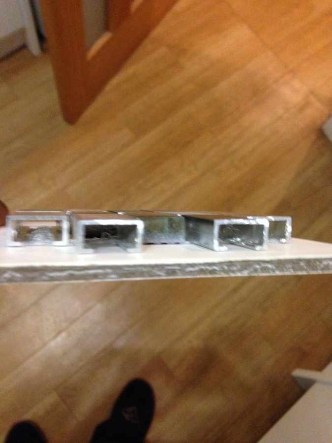

The thing that does concern me is the metal part of the mosaic bonding well. With it being a U shaped profile with only a thin lip to bond on either edge, and a hollow cavity inside, I am worried it will not have enough area to actually adhere to the cement. Especially as I can press it inwards too much with the risk of adhesive oozing through. But then, if it oozed through into the cavity inside the metal that would be good. For this reason I may now thinking mosaic mesh may not be a good idea, as it will mean even less contact between mosaic and adhesive. I know, I know, I am obsessing too much over it, but hey that's me. As per always, any advice is welcome and appreciated. Thanks.
the mosaic mesh is super sticky, so when your glass/metal mosaic is attached, it bonds really well. Id still use MM with these mosaics, IMHO you are using the correct adhesive.
