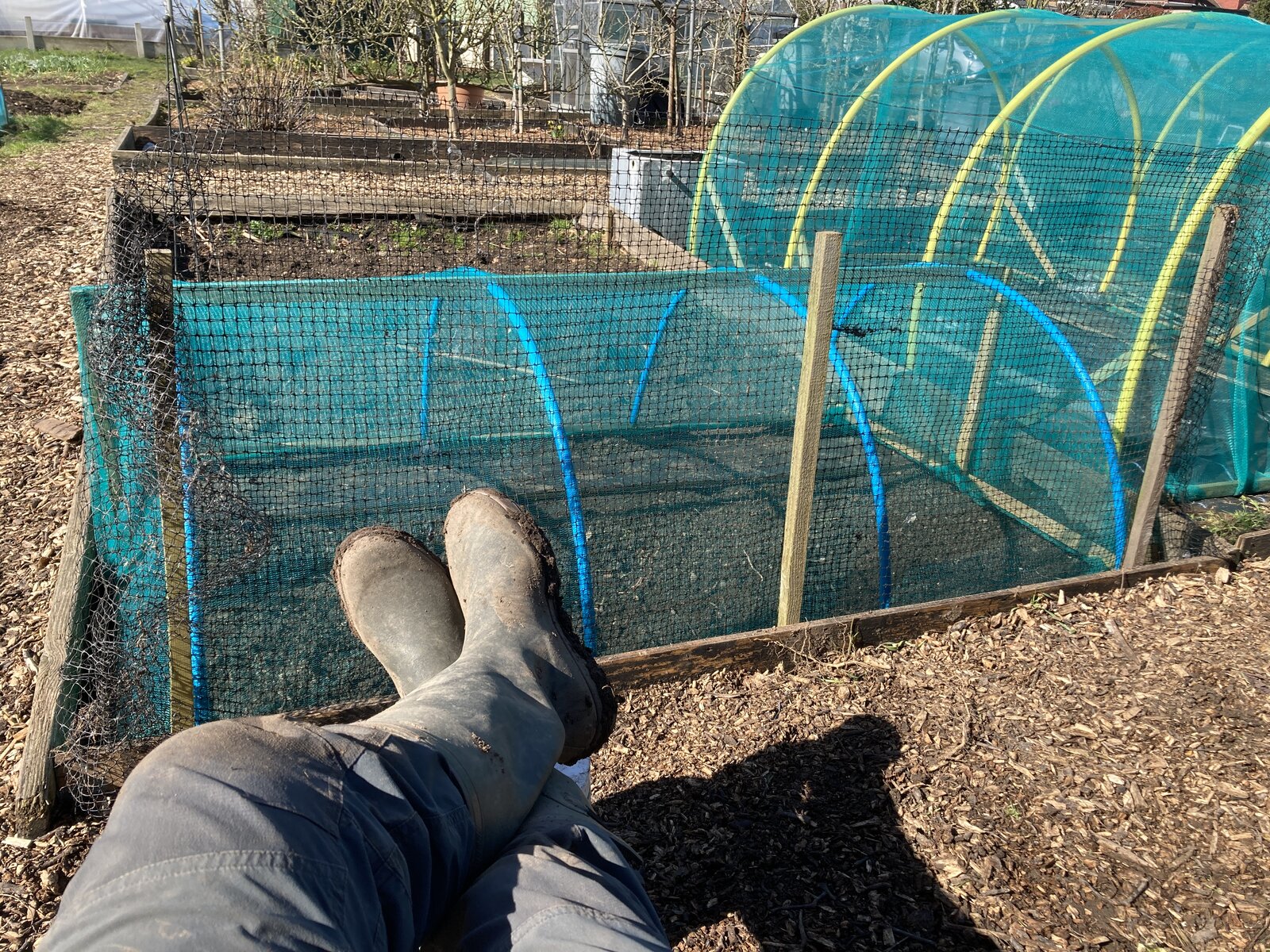

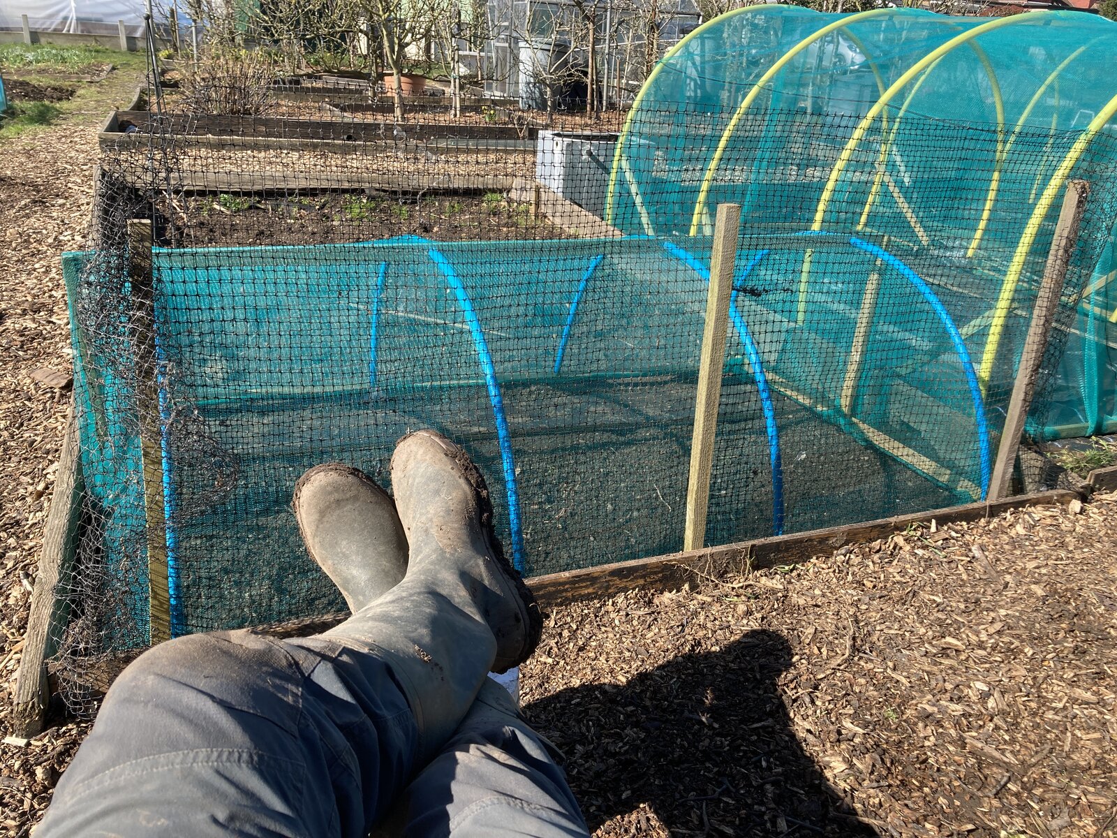

I use poly pipe screwed to a rectangular frame made of roofing battens over the allotment. Very light and you lift the whole frame off to weed/harvest.
