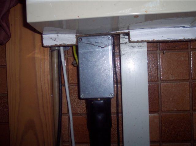

A die cast box into which the SWA is glanded. The cores then go through the top end of the box via a grommeted hole and into the consumer unit
