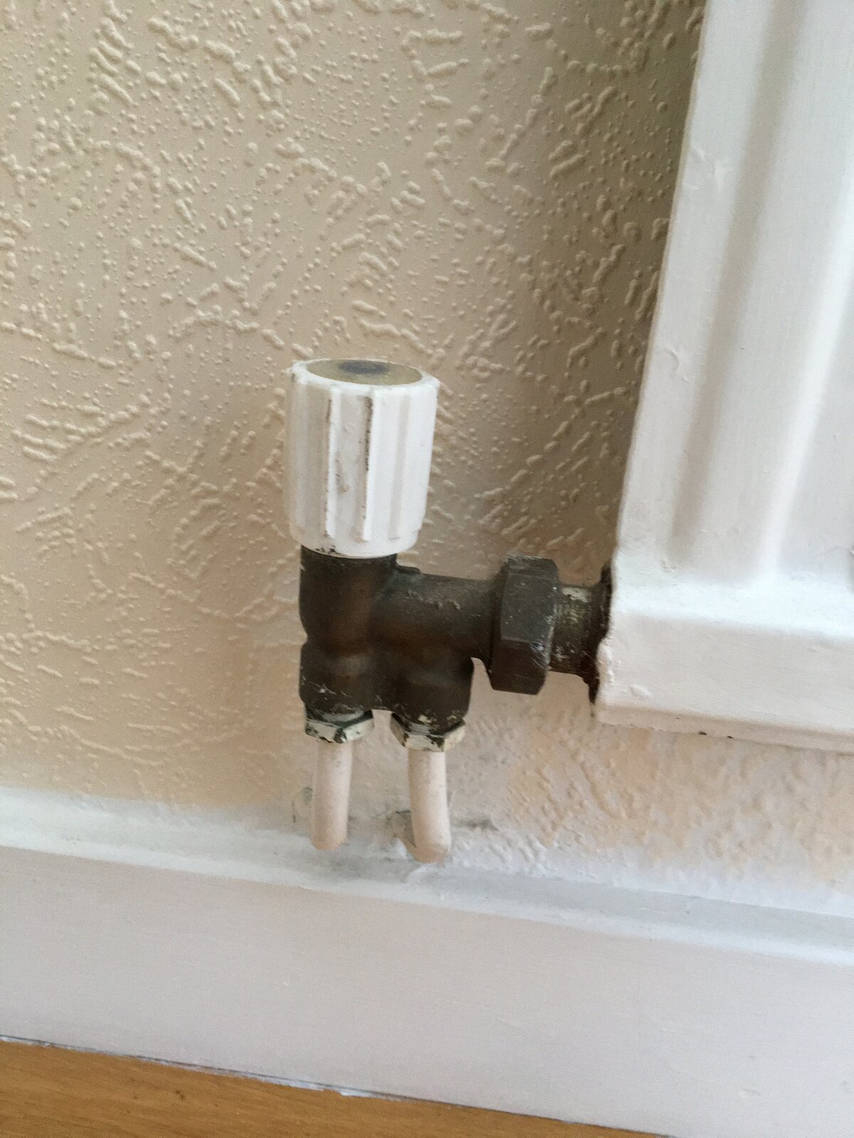

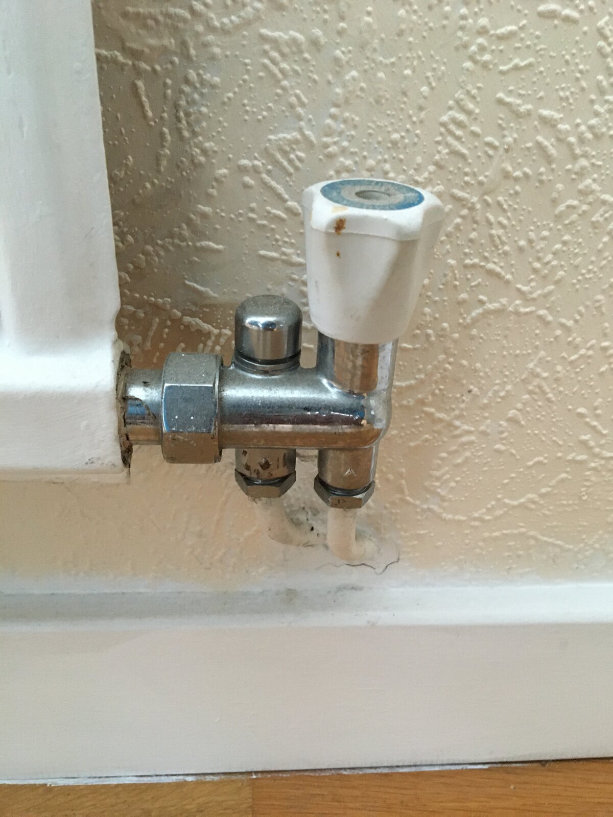

Do these twin entry valves isolate the radiator on flow & return or just one side?
1 old brass one.
2 later chrome one.
If just one side then presumably its a system drain down.

the chrome one isolates both sides , but you need to remove the chrome cap and iside there is a screw that you turn down to close the return, the other one needs a drain down, both have insertion tubes that you will have to re-attach or the rad wont work when you put it back on
If they haven't already corroded and snapped off inside :cry:
These were on another post earlier too - danfoss do thermostatic replacements now - RA15/6T's
Rab lots of beer plastic tubes were used here years ago and some hard plastic brown tubes not sure what they were, havent seen these valves for a long time, hopefully never see another one
Not alone there Ian, hate it when I see them. There were 2 of them down in ayrshire tail end of last year, luckily the whole system was being ripped out, all nasty 8mm.
I always advise the customer to straight off replace them, only ever had one come out intact, that system was squeaky clean though.
