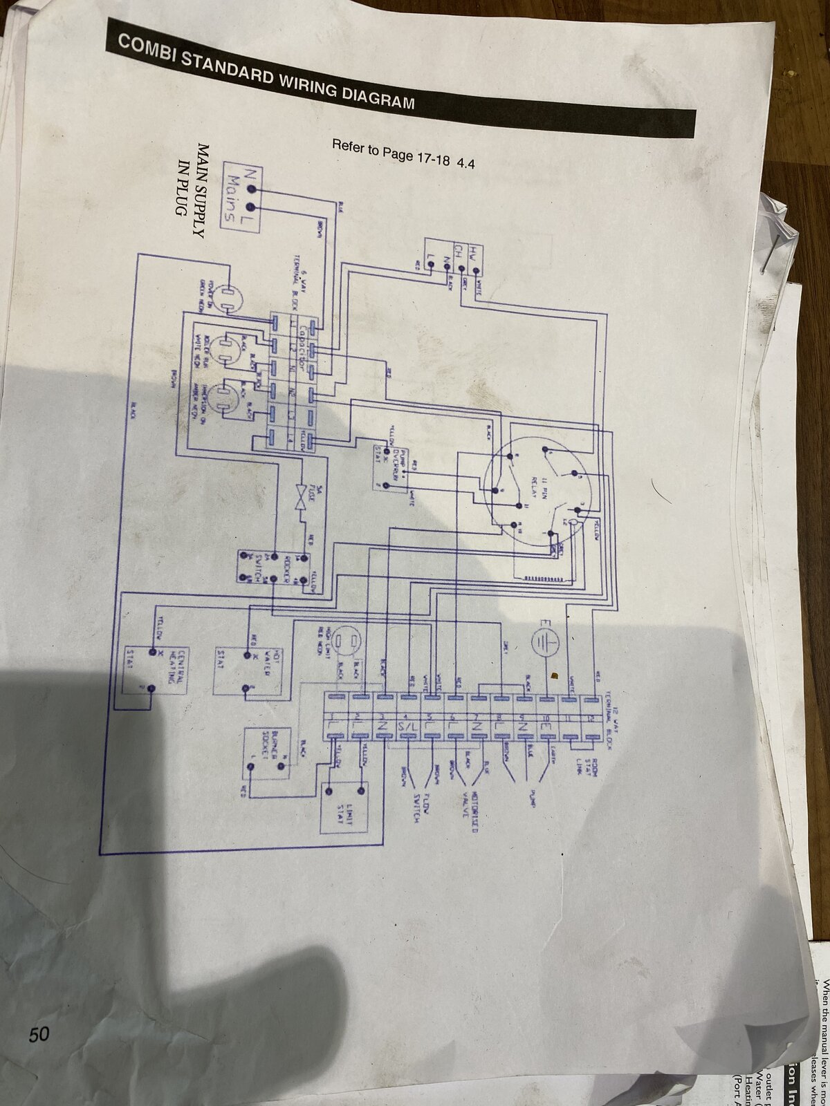

Just bought a property as a project. Has an old oil fired (no gas here) mistral combi.
All was good now no hot water.
I’ve just given it the once over and ch heating works fine.
There’s no room stat ! (Not yet anyway) Just a timer control panel. And there’s no water cylinder.
I’m presuming the hot water is heated by a valve diverter in the boiler pushing circulating water through the thermal store and up through the heat exchanger.
There is a flow switch on the hot water out flow pipe from the heat exchanger, which appears to be working .
When hw demand is triggered by control panel and flow switch the boiler fires and heat exchanger is getting warm but cools quickly with cold water flow through. The thermal store also doesn’t appear to be getting very hot either. Just warm.
I’ve stripped everything down and all seems fine with the exchanger. Store and pipe work.
This leaves the 3 way diverter valve as the main culprit, which is located below the pump in front of the thermal store. It’s an old Honeywell 3 wire 3 way diverter.
The ball valve was freeish, but a bit sticky and perished, also the cogs on the motor mech were knackered, worn and almost stripped.

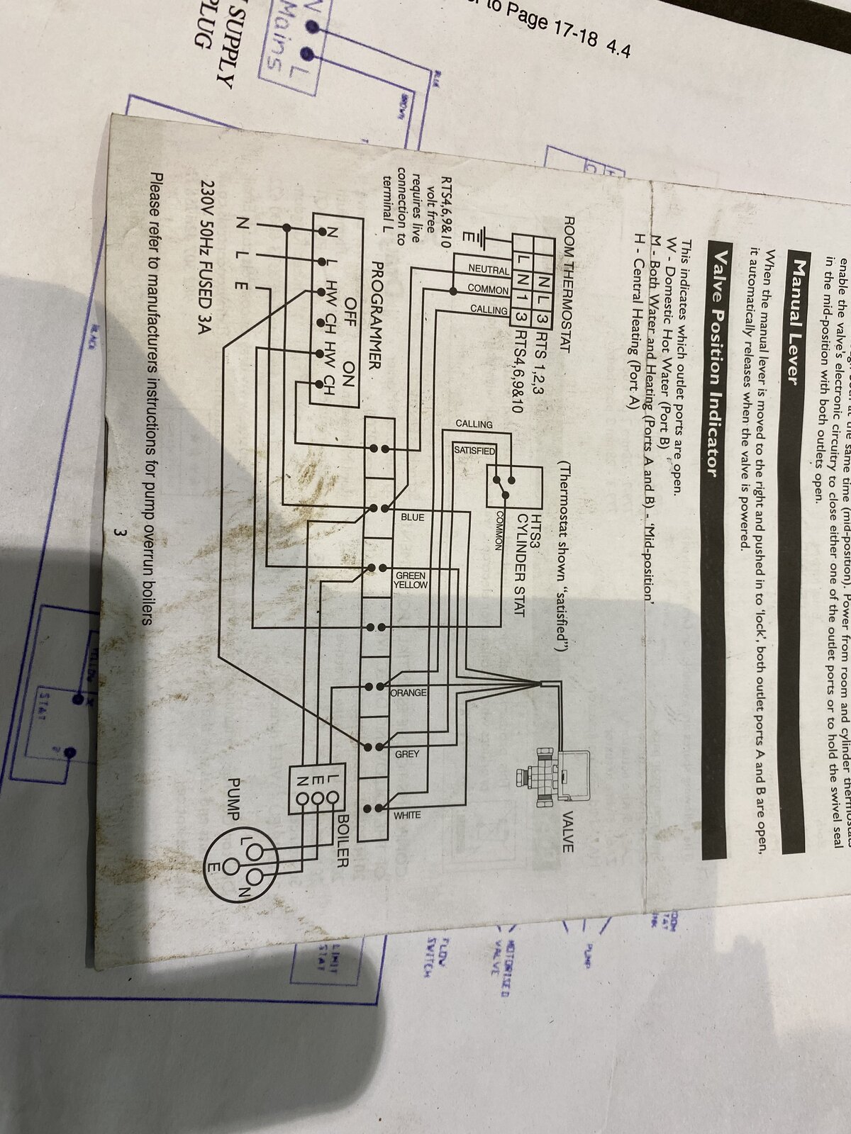

I’ve gone and bought what I thought was a replacement but isn’t ! . I’ve bought a Drayton MA1 mid position ! 5 wire. Rookie mistake.
Is there anyway to wire it to work as a diverter until I can get a replacement? Which is looking like a week !!
Bearing in mind I cannot take a feed from cylinder stat satisfied circuit to the grey wire because I don’t have one, just a stat dial on control panel. (I believe the grey wire needs 3 connections)
Can it be done ?
I’m an ex component diagnostic engineer so I know my way around a circuit diagram. But I’m wary that some of the connections on the valve become live depending on valve position so I need to know where to tie in.
Any help appreciated.
I probably need a new boiler but this thing is built like a tank and probably has some service to give. That I haven’t got seven grand for a new one.

So, you just require a 230V signal to open one port only and then the spring return will return the valve to its original position (port B on a mid position valve). Suggest connecting the mid position valve grey&white wires together and connect the switched live to them, the valve will (should) then move fully over to open port A.
For safety, put a connector block or tape off the mid position valve orange wire as thats live when the valve is fully over.

One of your schematics shows a mid position valve and a programmer with a HW OFF contact??.
Is the DHW supplied from a PHE (plate heat exchanger?, you should have a separate circ pump started by the flow switch for this which circulates primary water from the Thermal Store.
What controls the TS temperature?, does it run at the boiler flow temperature.
Post any details of the PHE.
