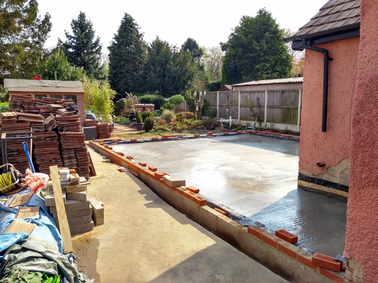

update....
My criticism is; why have you built the remaining 300mm, up to ground level, in block and not (engineering) brick?
Full marks for tamped sub-slab though.(y)
