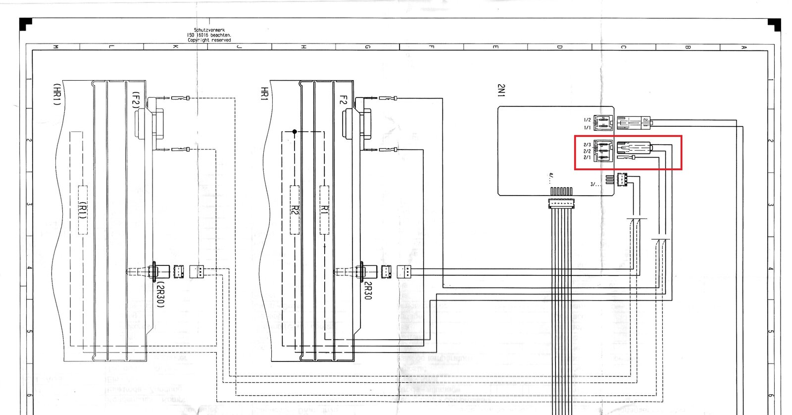

Update on tests following your advice.
Please see attached diagram for reference. Measurements from connectors highlighted are as follows-
2/3 to 2/1 showed continuity and measured 24 ohms
2/2 to 2/1 showed no continuity and 69 ohms
2/2 to 2/3 showed no continuity and 100 ohms
You are correct about the two elements and your initial thought that it is a heater problem would seem to be confirmed?
Look forward to hearing your thoughts on these readings and thanks for the help with this.
Your tests do confirm one of the coils is dead

On a practical note I thought I would examine the heater box just to see what £250 would get me. It is a simple two part case of thinnish metal held together with 6 tabs. Loosening these gives access to the innards which are two sets of simple coiled heater wires. There is no extra expensive technology included. On Ebay I see other brand dryer heater assemblies available for less than a third of this. I looked again at the coils and can confirm that they are not made of pure silver nor is any part of the casework precious metal.
There was very little fluff on the coils which was easily remove with gentle compressed air. I then checked continuity and no surprise it was fine for the main, larger coil, but for the smaller secondary one it was erratic. This coil looked okay ie there was no obvious break and it was possible to continuity check each coiled row. I had hoped that this would reveal a break but oddly I kept getting good continuity on a row by row basis but when I measured across the entire coil element it was very hit or miss (mainly miss). I carefully reassembled and reinstalled. Re-measured all values and these were almost identical to those given above. Thus confirming the faulty heater conclusion.
