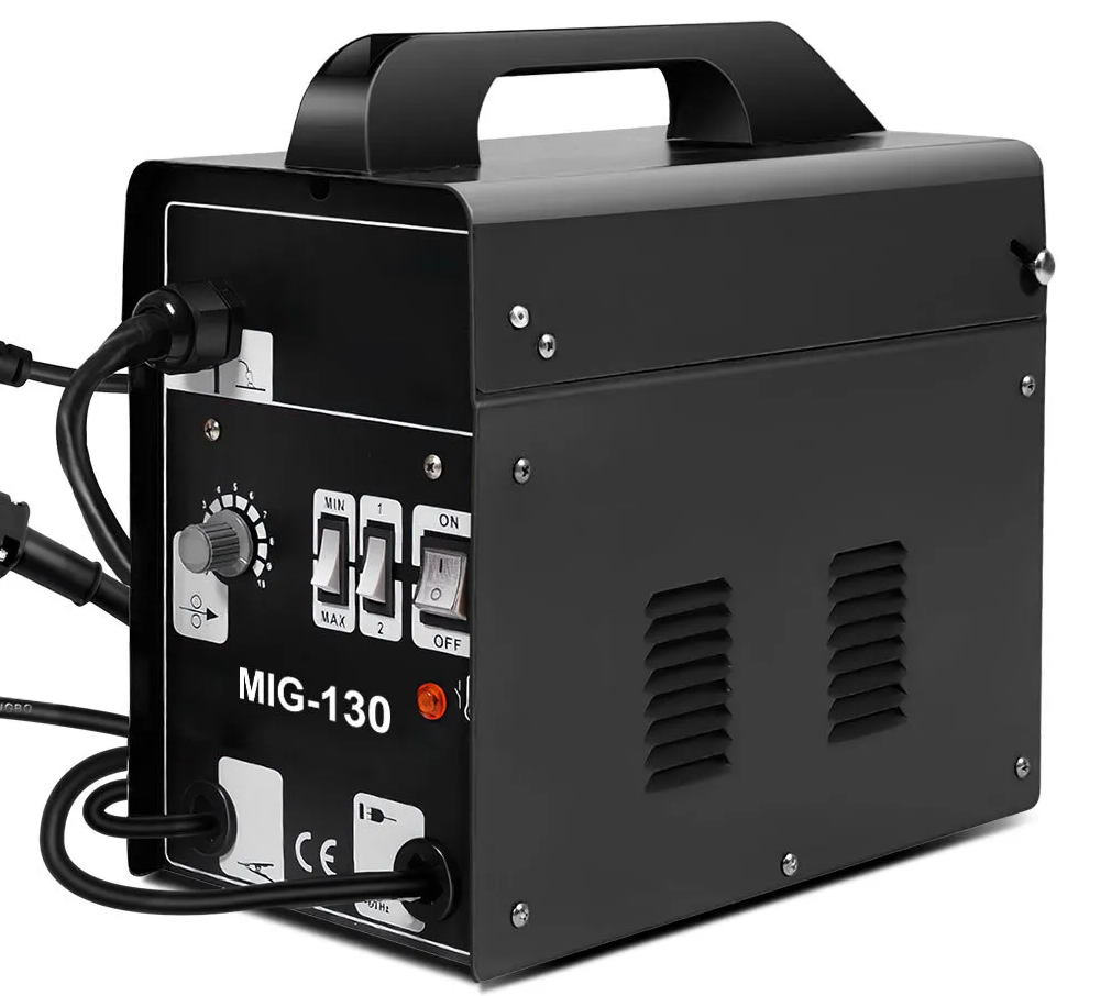

Can someone explain the 1/2 and min/max switches in the attached picture please?
The manual implies they control the wire feed speed but there's a separate rotary dial for that.
I'm attempting to weld some 50mm body washers to the bottom of the 30mm tube feet on a steel frame garden swing seat.

The knob on the left is the wire speed.
The other switches are current parameters so for maximum current set to 2 and Max, for minimum current it’s Min and 1, with other variables in between.
A bit haphazard I agree but the cheaper kit is like that. You have a Max current of 130 A but to measure that is almost impossible.
Kick off by using middle current settings, and maybe 60% wire speed to practice with.
For gas pressure, try 3 psi.....a good draught on the hand. If you use too much gas pressure the weld gets cooled.

Job done!
Set the Mig to 1, Min and wire dial to 7. Welding was a bit spluttery so switched to Max and it seemed better. Switching to Max also sped the wire up. Got the washers tacked on to the tubes and painted so all is well.

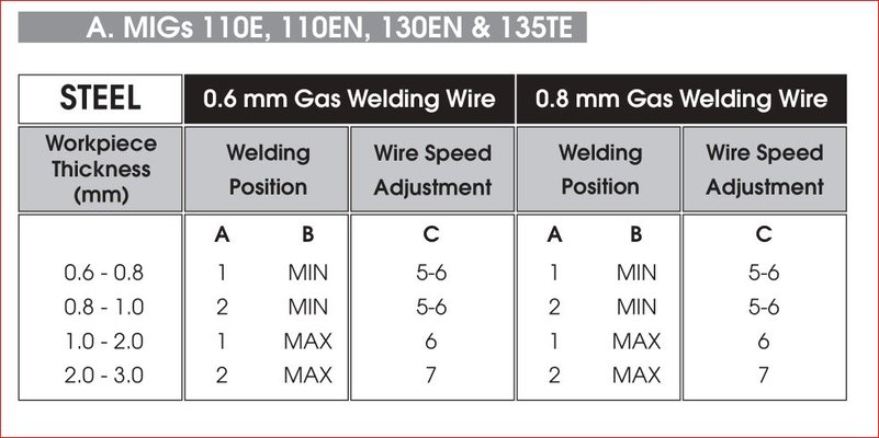

I've a similar welder and I use this table to give myself an idea:
.. though on mine the wire feed speed is generally a whole number less than the table. Make sure your tip and drive roller are right for the wire diameter and use lower powers when using flux cored gasless wire

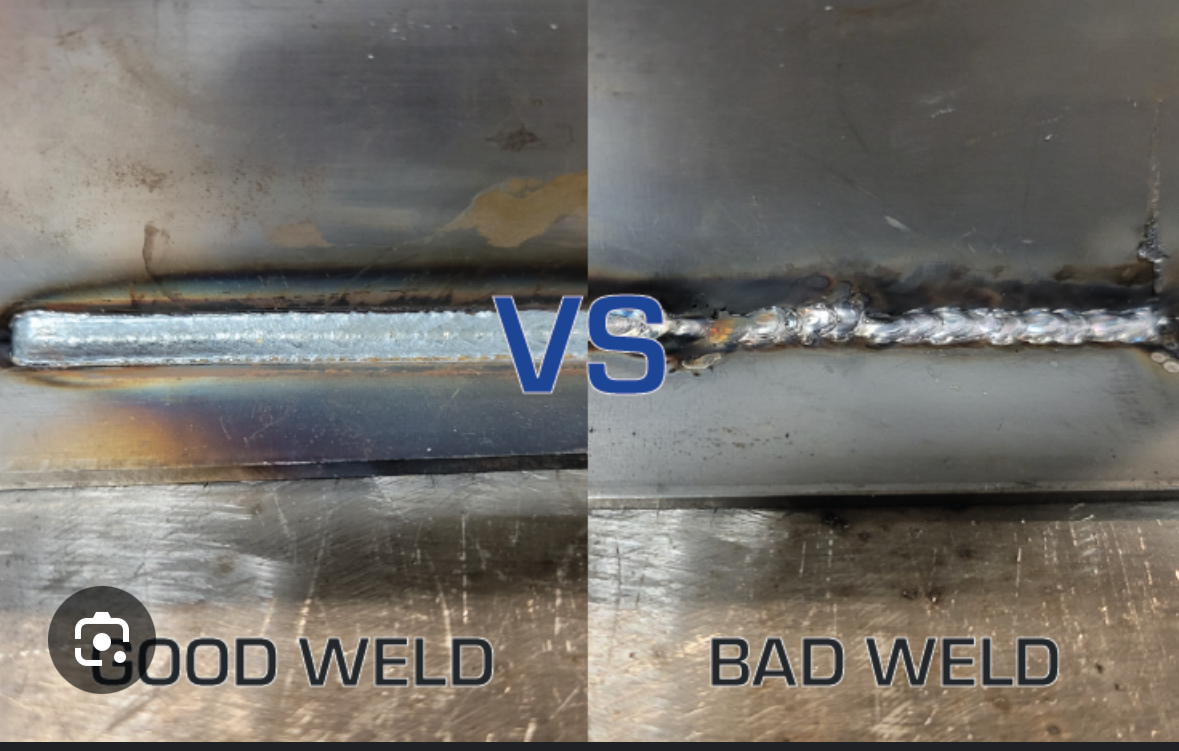

Then stop and look at the weld you've done; here's the difference between a good and a bad weld, in terms of fusion between the weld bead and the substrate:
I mean, no critical parts to your job so if it's a bit "perched on top" it's not a train smash .. but if you're finding it looking more like the one on the right, you may need to up your 12minmax settings so you're running hotter - this is where the thickness comes in, as thicker metal sinks more heat. If you go too high you'll probably burn a hole in the metal substrate if it's thin. Easiest way to fill it in is to spot on and off to give the metal time to cool otherwise the weld pool will just flow away from you
