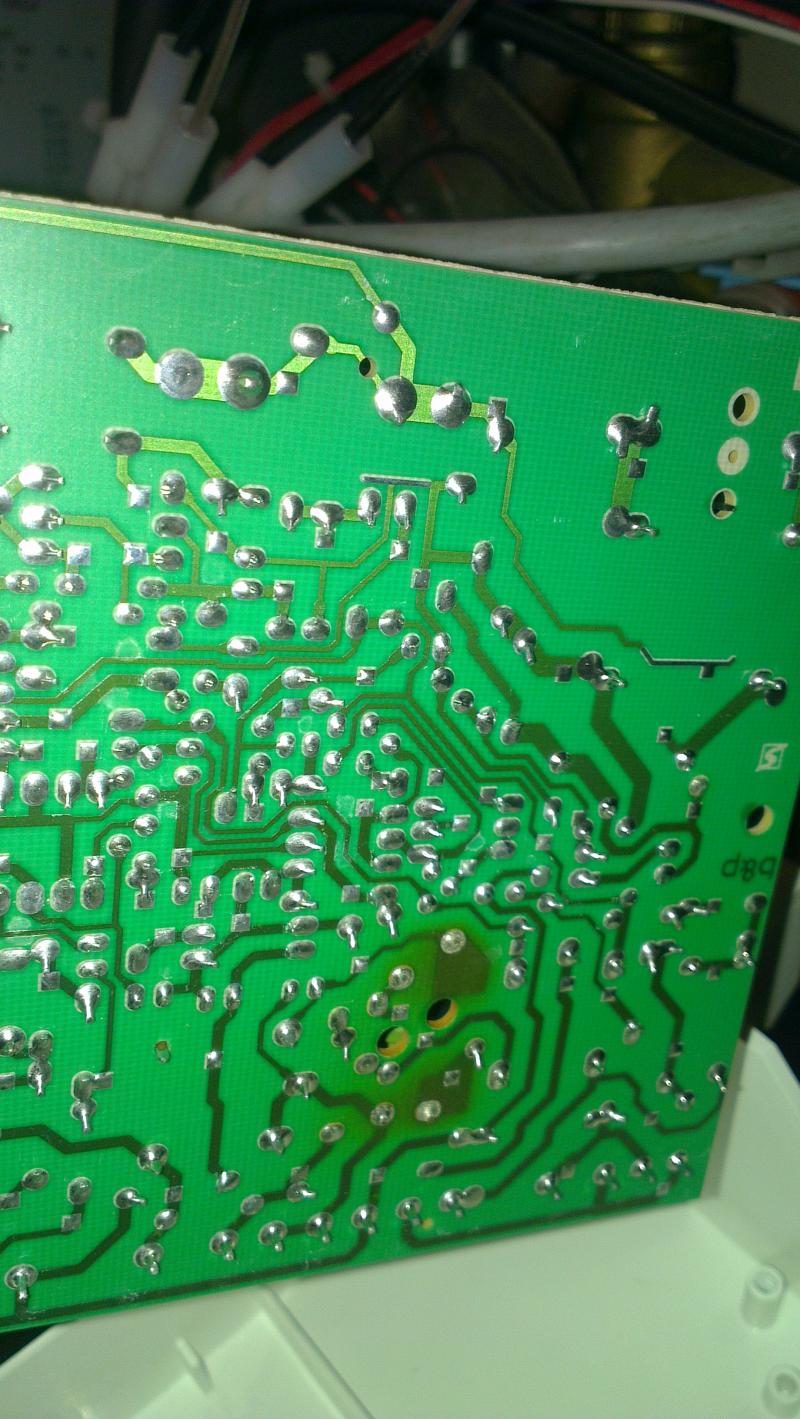

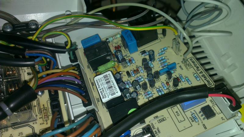

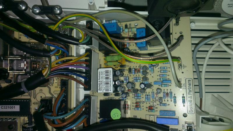

Is this a fault with pcb 2 board on the right?
I have photos below of the front and back which looks like some heat damage to the resistors, so when they heat up they are breaking the circuit and causing the sequence on the board to fail.

So why do you think the resistors are breaking the circuit?
I may be totally wrong and irrelevant, but was just trying to be logical, had a similar problem on a tv circuit board once, the tv repair guy, showed me back of board which when the resistor connection got hot the connection got broken, applied new solder to bridge it and it worked, cheap fix and tv worked for years after.

I very much doubt that resistor is causing the problem.
But you could reflow the solder to be sure. Look at other joints closely and see if you can see any cracking of the joint particularly on the relays.
A way to see if a joint is going faulty is to measure the voltage across ir or easier to chassis from each end. But usually a faulty joint is visible.

I couldn't see any problems with pcb 2 on closer inspection but have touched up the connections near the discolored area.
I will try pcb 1 too, if this does not solve the issue.

I know its difficult to get people to understand this but the discoloured PCB substrate is NORMAL and not an indication of a fault location. More likely to be on the fan relay connections!
Not likely to be a joint on the control PCB.

Problem solved from resoldering several dry joints on back of pcb 2. Simple fix took less than 10 mins.
