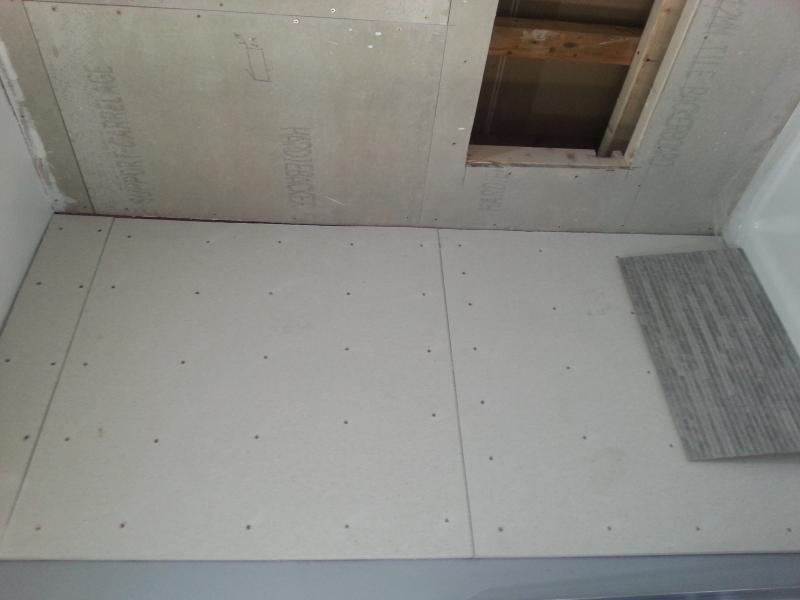

Alright fellas,
I installed a Hardibacker equivalent (builders merchants have stopped stocking Hardibacker but now carry an alternative) on the last wall to ensure its sturdy enough to hold the tiles without any issues,
I know I need to join the backer boards on each wall with scrim tape and some tile adhesive which leads me on to another few questions.....
1) Can you recommend a good adhesive for porcelain tiles? I'm guessing a rapid set cement adhesive would be best,
2) Where the two planes meet in the corner there is a gap of about 5 - 10mm should I be looking to run scrim tape down there with tile adhesive to join the two planes or leave them independant of each other?
3) Despite my best efforts, the wall on the left isn't plumb, when using a straight edge the center bows in against the wall by about 5-8mm, can I use adhesive to build out this area? Should I do that now so it cures or at the time of tiling?
4) Finally Tanking, what tanking product would you recommend using with these types of tiles?
Incase anyone is wondering the gap in the wall is for a granite/quartz/marble recess to be installed. Unfortunately I hadn't anticipated how expensive that choice of material was going to be so I'm flat out haggling for a decent quote......
Thanks gents

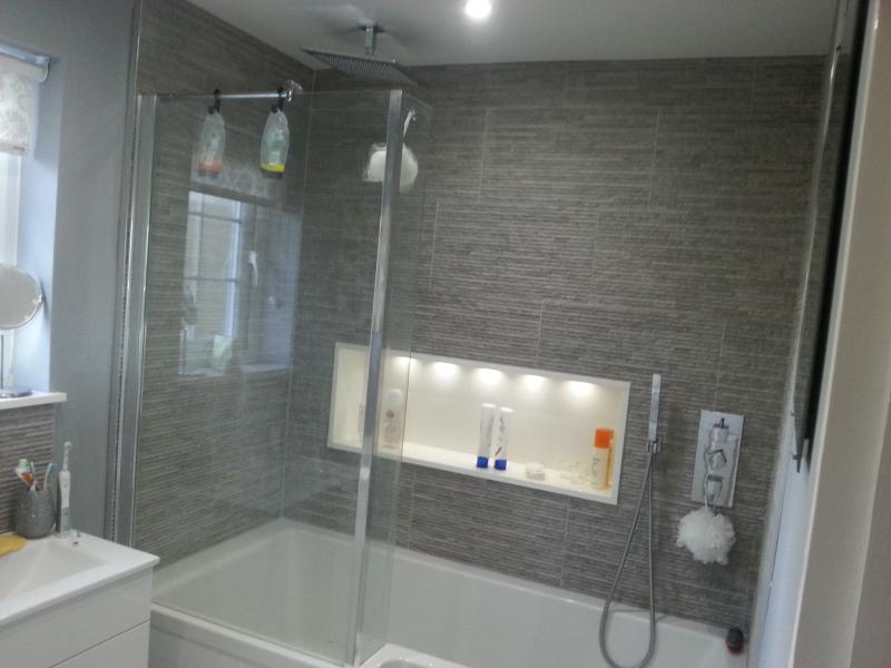

Gents, thank you for all the advice provided,
The stratum tiles are an absolute ball ache to grout but for my first attempt at tiling I'm rather happy with the outcome....
The recess is manufactured from five pieces of white quartz, didn't realise how expensive the stuff is but I did manage to locate a reasonably priced chap in the Luton area who I wouldn't hesitate to recommend.....
Here's a photos of the finished product.....
Thanks again, this website is testament to the work that can be achieved with some helpful & friendly advice....
