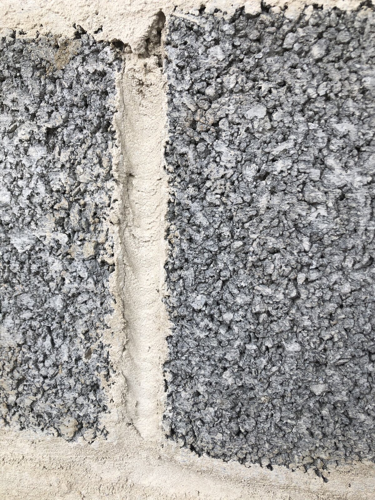

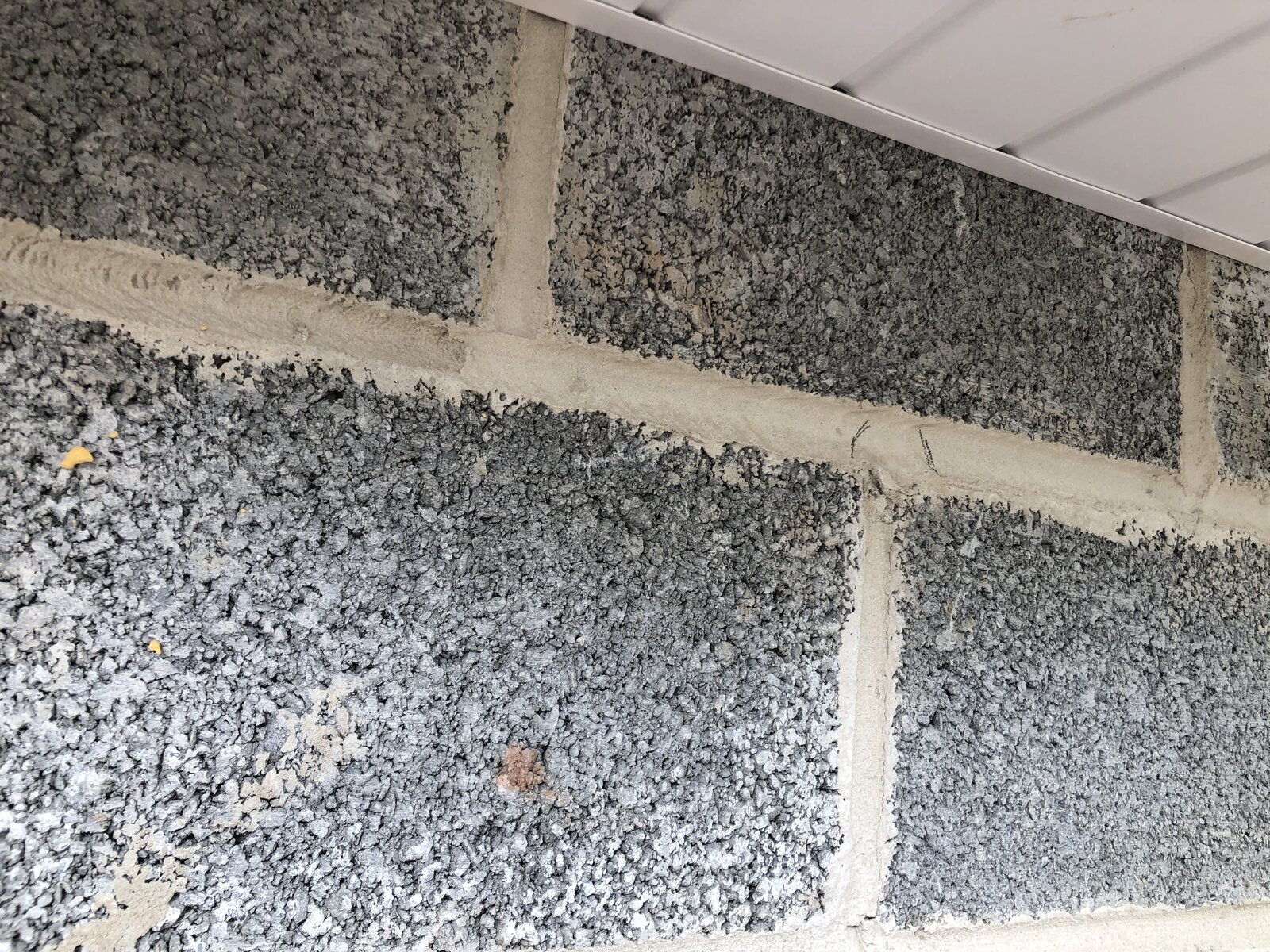

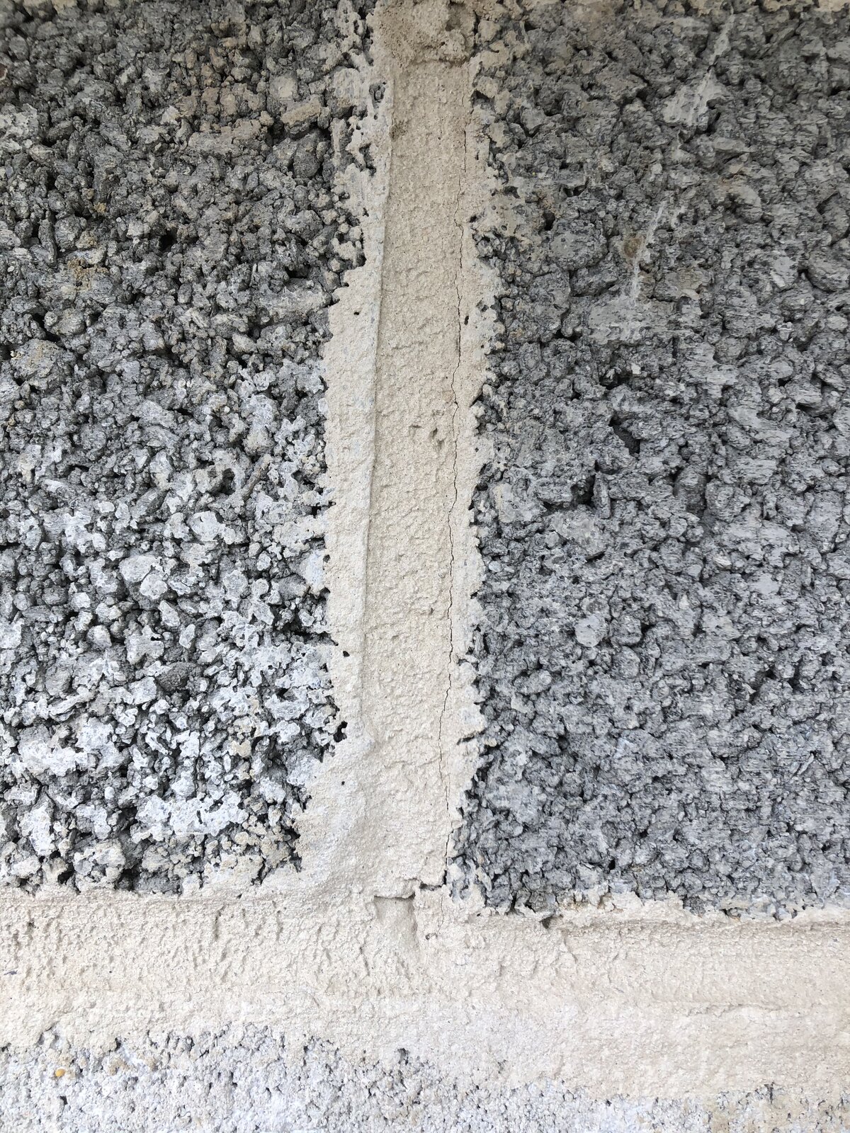

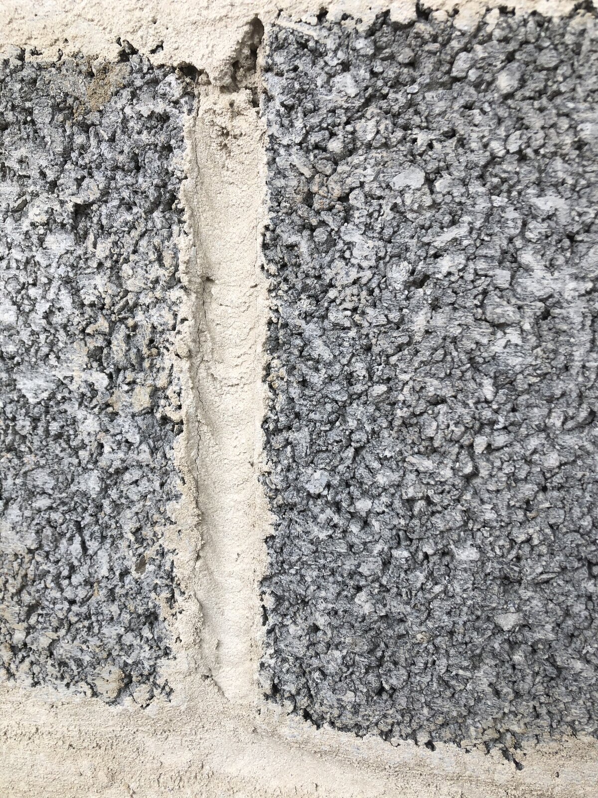

Hi.
There are few photos attached.
Can I get some advise on what cause these cracks please?
the blocks have been in place for about 2 or 3 months.
the cracks are less than hairline.
mortar mix was 4:1 sand cement with additive.
Is it any if the following reasons?
Thermal.
Shrinkage.
Drying out.
Minor Settlement.
Mortar mix ratio.
Damp blocks during building work.
or, a sign of more scary things like foundation issues?
Any advice would be great as I am low in experience.
thanks

With blockwork it's generally shrinkage cracking as they dry out. Blocks are normally at their largest when laid, clay bricks at their smallest.
Thanks for the reply!
fingers crossed that it is nothing more than that.
the other thing I should add is that the blocks were all stored outside and uncovered, and I didn’t cover the walls while i was building them.
hopefully this all adds to the evidence of them being wet and drying out!
thanks again!
