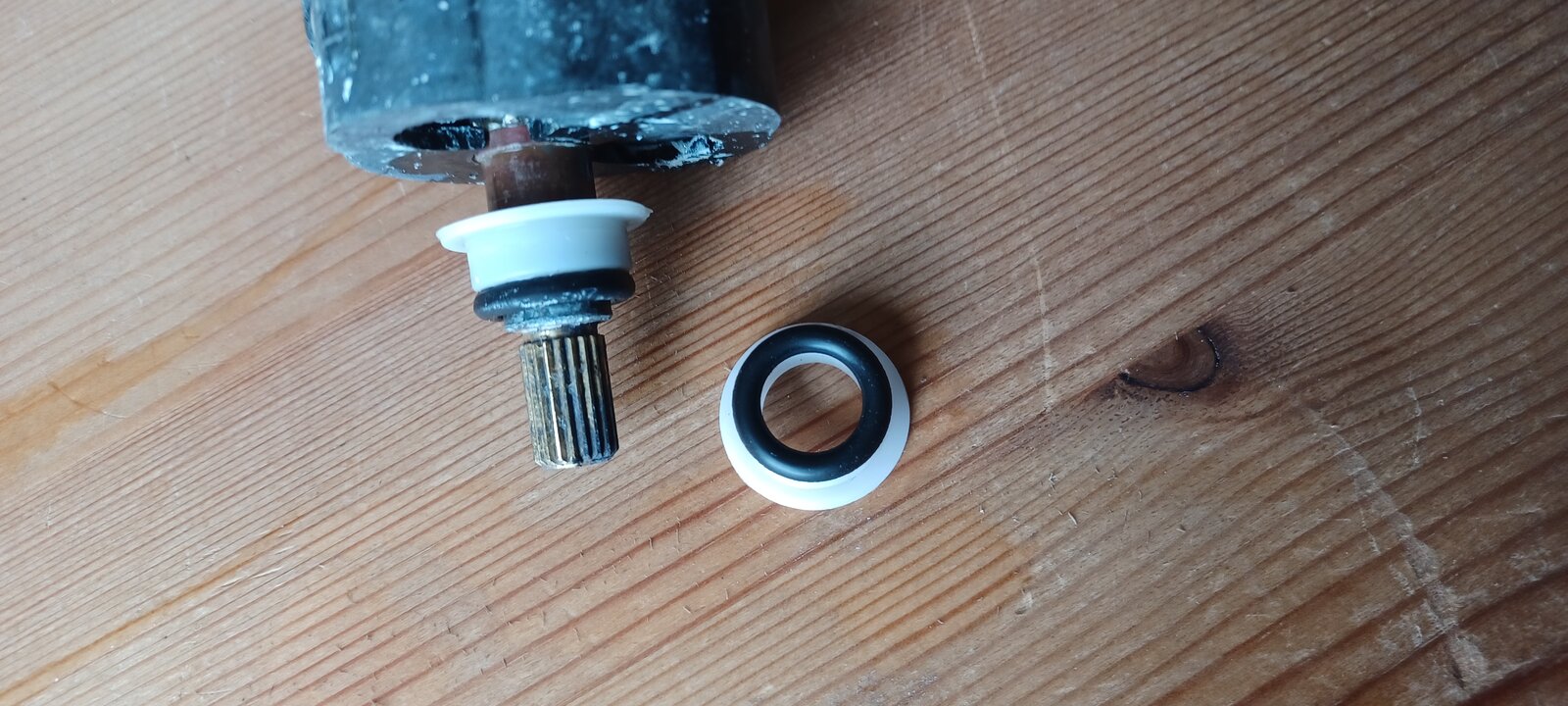

This is what you are missing. I did exactly the same and didn't notice the collar and rubber washer, shown here on the old cartridge. Once replaced working perfectly.
Available on Ebay UK
