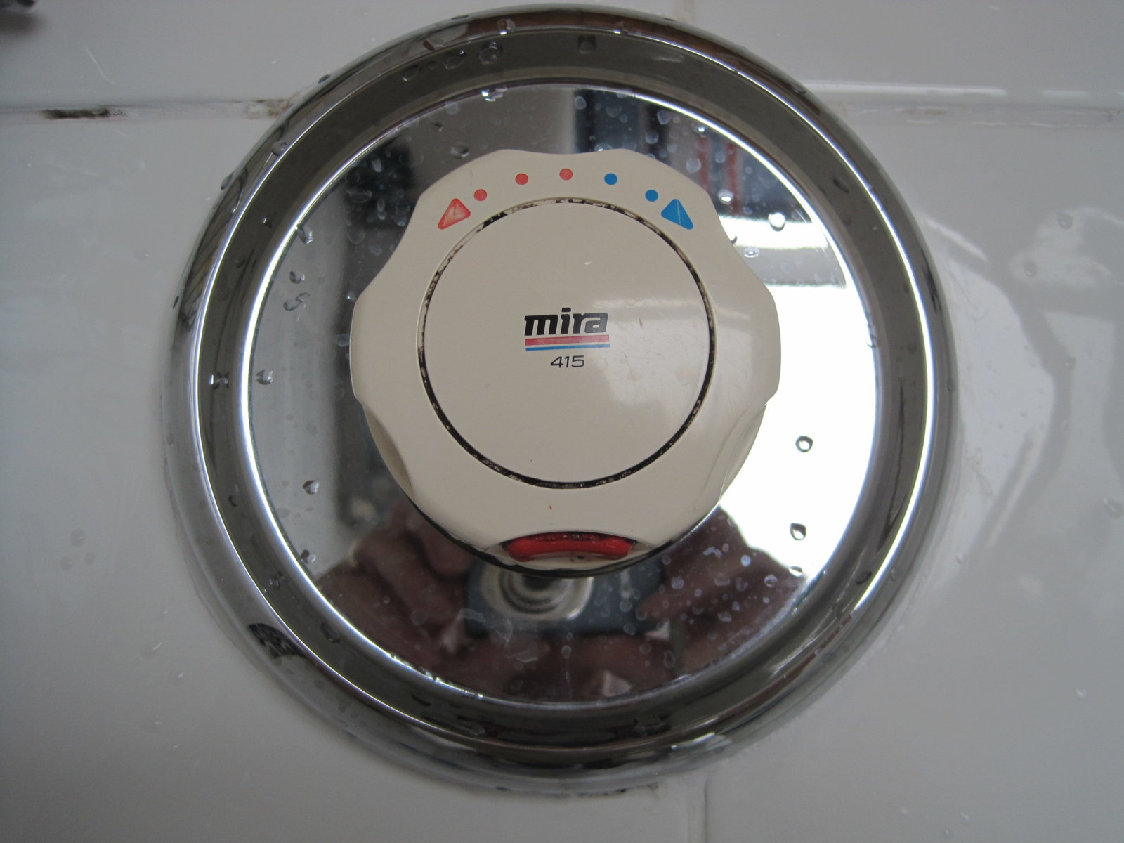

The unit has overnight developed a problem, after using the red button to allow the temp control to go to the hottest position when I try to turn the unit back down again or turn the unit off it sticks and I have to use force to return to the normal range.
It would seem its a problem with the red button catch, how do I get into it to effect repair please. IMG_0269.JPG
With the proviso that I’m not an electrician you may be able to lever off the cap and if you’re lucky the red lug can be accessed and cleaned out, and the problem sorted.....
But don’t attempt it unless you feel confident you can safely isolate the supply
Blup

It isnt an electric shower, the middle bezel prizes off with a screwdriver, underneath the bezel there is a posidirive screw , remove that and the front will pull off and clean everything out it will be full of crap
