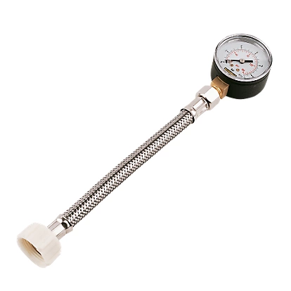

How would I tell? I assume there is a meter of some sort? Might have to call in the experts!
Would pressure vary from house to house on a new estate? Thanks
buy a water pressure gauge do it yourself on outside tap.
screwfix or toolstation do them.
