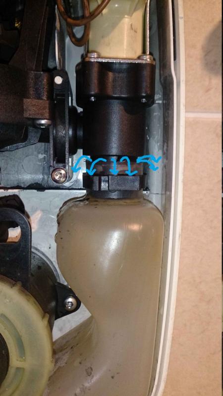

Hi all,
Today I replaced the Solenoid Valve Assembly (part # 453.13) on my Mira Event XS Thermostatic power shower as I suspected the old one was no longer working correctly. The shower seems to work ok now, however I have a leak where the Solenoid Valve Assembly meets the Damping Vessel. I have disconnected & reconnected the damping vessel a few times to try to ensure the seal is good but I just cannot seem to stop it leaking. I have attached a couple of photos, please can you advise if I have done something wrong here? Have I connected it correctly? Do you have any advice on how to stop it leaking?
It only leaks when the shower hose and head are both attached. If no hose is attached then it does not leak. If the hose is attached but the head is not, it does not leak. It seems the pressure build up is just too much with the head on.
Any help would be really appreciated.

Is it leaking from the hose at the bottom? If so the clip is probably just junk (plastic rubbish). I'd try a proper jubilee clip, being careful not to let any of the metal touch anything else.
Thanks St0rmer66 for the suggestion about the jubilee clip I will give that a go.
What happens is when I turn the shower on the clear plastic damping vessel fills up with water as it should but when the water reaches the top of the vessel where it meets the solenoid valve it spills out of the top. I have added a picture with blue arrows showing where it is leaking.

I'd try the metal jubilee clip then. Doesn't appear to be any electrical contacts anywhere near so I don't think it'll be an issue in that regard.
Well great news, I put a metal jubilee clip on last night and it worked a treat! The leak has completely gone, even with the pump on full pressure. Well chuffed!
