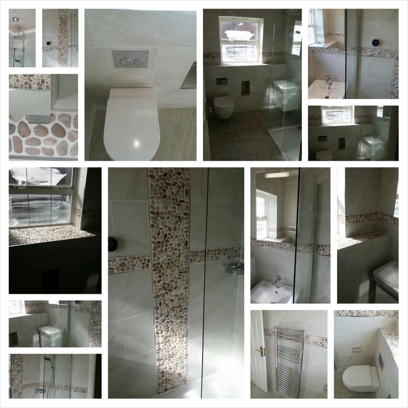

Just about to refit my en suite at home, that's getting a Platinum with fixed and riser heads
