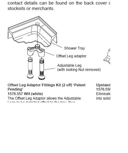

I have some tiling planned for my en-suite. In preparation i took the side of my raised shower tray off.
Underneath looks like a horror show to my untrained eye. Rather then have manufactuer fit legs the house builder appears to have the try sitting on some chipboard with 4 legs screwed into that.
So I have started looking at replacing the tray. The tray is in the corner with plumbing around the side of the wall which will interfere with legs on a shower tray if they are fitted on each corner. I notice Mira have an accessory for their trays that allow the legs to be installed offset for such a scenario.
I was wondering whetehr anyone has come across these adapters and if so do you just need one leg fitted still or two at each corner. see the attached.

We use these offset legs regularly along with the Mira shower trays for getting the pipework round the leg to supply the rest of the bathroom.
They are very straight forward, if you only need one you don't need one at the other end to stabilize it or anything, one is fine.
You just fit the offset leg adaptor into the position where the leg would go, then choose one of the two slots to put the regular leg in, whichever suits you best. Strong and sturdy, no worries.

thanks for the quick response.
do these adaptors rotate 360 once fitted to the tray so you can place the leg where ever is most convenient within its circumference?
