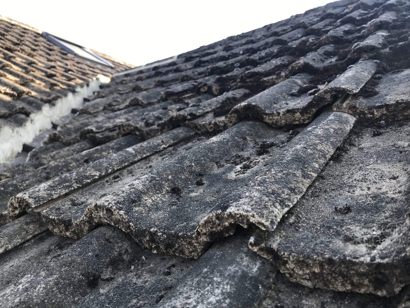

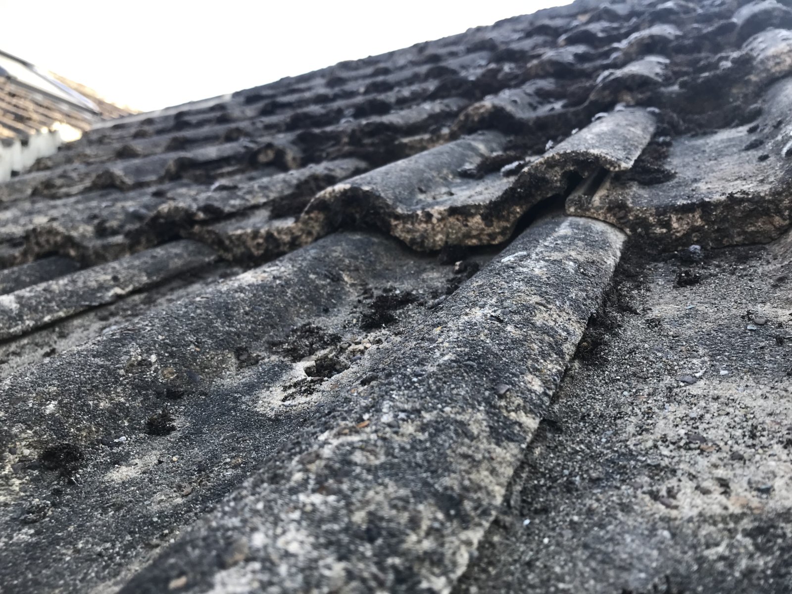

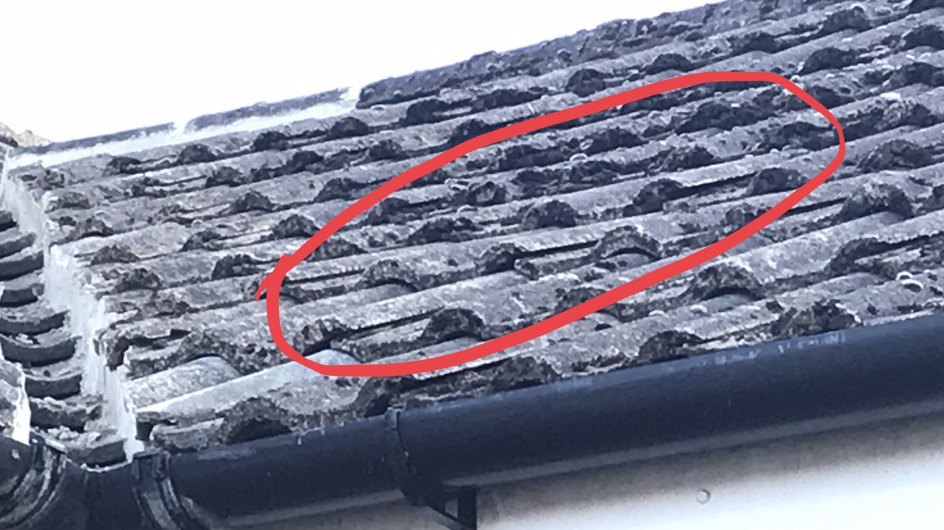

Hi, I have just had a valley repaired, this included removal of roof tiles around, lifting and rebed of valley tiles on new felt. Now it appears though that a number of tiles are misaligned next the the cut ones. The roofer has been back today and packed a couple of tiles on the lath, and is now saying he’s happy, I have had a look and I don’t think I am! There are gaps at about 5 interlocks in the tiles, and my thinking is these gaps are new as there is no moss in them. He’s now wanting paying - what are people’s thoughts? And any thoughts on why these gaps have appeared, has he set the cut tiles wrong?

It looks like a typical 'creep' situation whereby the tiles are rising towards the valley and away from their intended plane (seating correctly on the batten), because tiles do not bend. This is more common with those awful valley tiles you have presently.
I would have refused to repair that valley, instead insisting on a new dry fella and a much better looking roof.
should have had the valley troughs skipped while they were out.
They are often the cause of leakage so why put them back?
Thanks for reply.
Should I just accept this in your opinion? Is there anything that can be done other than rip out and redo with lead valley?
