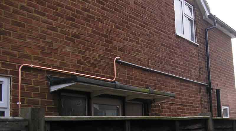

My neighbour is having a new bathroom installed. They have run a gas pipe from the gas meter along the side of the house, round the front door and into the upstairs bathroom. The pipe is completely exposed on the side of the house. (picture can be supplied). Doesn't look safe to me - can they do this?????[/img]
yes a picture would help.
but as kevplumb says,exposed pipes are allowed, but there are regulations on type and distance of pipe clips, etc;
it also depends on what you mean by exposed
I have followed the FAQ answer and sent a photo to be put on the post.
It just looks strange that gas pipes are going up the side of the house - the picture will show exactly what I mean.
Would be grateful if you could help.
Alison
Fine but do they still need coating in bitumastic paint?
David
They were only fitted today so maybe there is more work to do.
As a complete layperson here putting gas pipes up the side of a house seems a bit strange - don't they usually go under the ground or under floor boards?

Just re sat my CCN1 and there was no mention of bitumastic paint
you can run your pipes externally but you must take care that they are portected against damage.
running them under your floor boards could have cost more and caused major disruption so maybe it was easier to run them externally??

What's more dangerous: A gas leak inside the house or a gas leak outside?!
It may be legal but I wouldn't be happy with that pipework on the front of my house, gas or water.
Apart from the uglyness what if the window cleaner caught it with his ladder etc.
Boxed in or sheaved would still look ugly.
no worse to look at than that waste pipe.
cheaper on installation costs to
whats wrong with that....lovely. once its weathered u wont even see it
