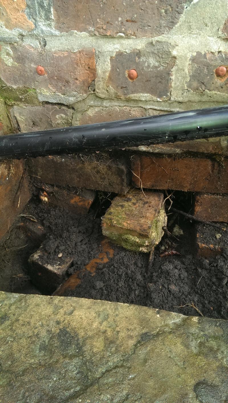

I have been digging a trench to alleviate a rising damp problem. While excavating I have found a old unused soil pipe running through the brick footing.
There is no lintel and one side of the bricks are slumping down.
The idea I had was dig out the area a bit more without affecting existing footings, pour in concrete into a wood template over the pipe and once the concrete is set put bricks back where they should be.
I know the pipe is unused because the drain repair guys capped it off before it entered the mains in a previous repair
Are you certain that the clay soil pipe is redundant? Do you know what used to discharge into it, from where? Where does it go to?
I noticed a gulley to the left. Probably, wherever the gulley drains to eg. a manhole, is also used to take the soil pipe.
If you are satisfied that its abandoned, then why do you still want to preserve the pipe? Why not cut it, and plug up the old pipe entry hole in the manhole chamber.
You could then brick up the hole below the DPC.

The soil looks v. wet, perhaps its worth checking that the gulley isn't leaking? The pointing is merely smeared on - it needs re-doing with a 30mm rake out.
I'm pretty sure the pipe is not in use it used to lead to a sewer but was filled in when the guys repaired the other drain.
I'm not sure what it's use was, it could well be an old toilet that was on the ground floor but is no longer there, the room is now a kitchen extension.
If I collapse the pipe should I be worried there is anything in there which might cause a problem?

Check at the manhole, find out what discharges into the MH and note the entry holes.

I will clear the gully and check for leaks.
I think rebuilding the footing is the only way to go - If I want some solid ground to build the footing on should I -
1) Smash the pipe and remove
2) Excavate some more
3) pour in concrete
4) lay bricks
5) tidy up mortar
Thanks for your help
There's no need to re-build the footing. Simply smash the pipe out of the way and clean up the brickwork around the gap in the wall and then relay some bricks, and replace any "slumping bricks".
Temporarily move the black waste pipe out of the way.
