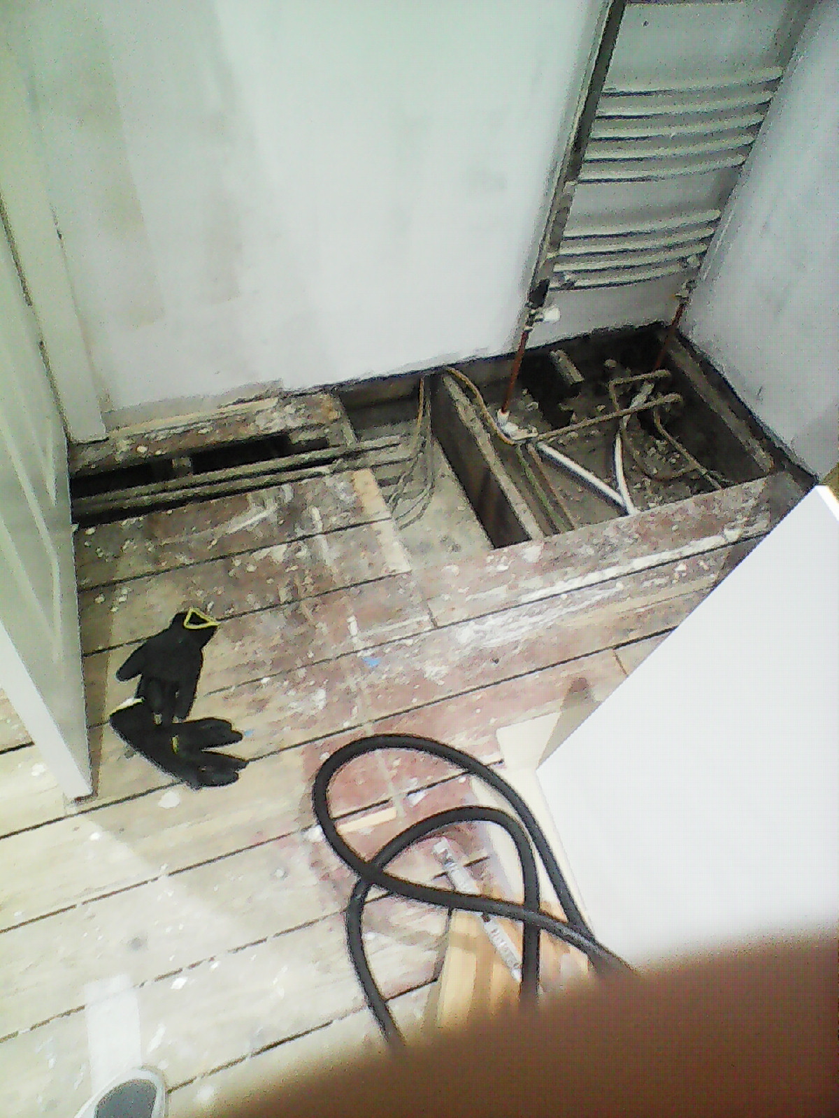

Hi. I removed a stud wall in my bathroom as I am updating it. When I removed the wall I noticed that there was just plywood where there was once floorboards. How would I go about fixing this? I am putting 6mm ply down in the whole bathroom as I am getting Lino put down. Would I just need to get some new floor boards and if so do they need to be a specific typed where would I get them?

As you are going to cover it all in ply, all you need is to fill the missing area with the same thickness as the floorboards.
You could you new/reclaimed or ply, just get the SAME thickness.
or 18mm chipboard with 2mm ply on top?
I used 18mm chipboard and it seems about the same thickness as my 20mm floorboards. Doesn't make sense I know!
