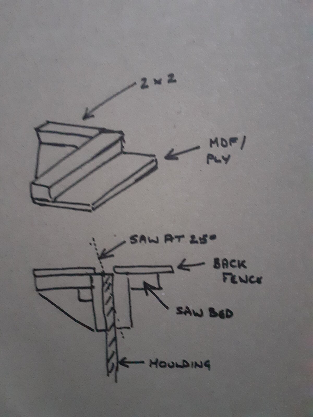

Make yourself a support fence from a piece of sheet material and a couple of pieces of 2 x 2 softwood or the like, thus:
This is planted on the bed of the saw and screwed to the back fence (which may mean drilling a couple of holes, so not for those who think tools should never be modified)
The 25 degree cut is then set on the mitre scale and the material introduced from the front of the saw.. A sacrificial plywood or softwood hold down (with any screws well away from the track of the saw blade) is highly advisable
