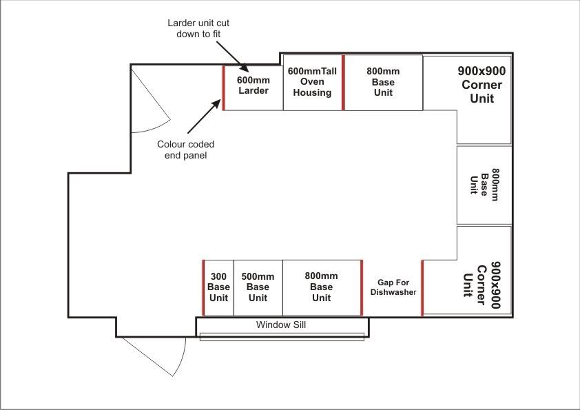

I wish I'd found that link to Fitters World earlier as they seem to have a lot of good stuff there at reasonable prices. I'm also after a 254mm (30mm bore) blade for my table saw. I am going to be fitting a kitchen soon and need to cut about 2 inches off the back of a tall larder unit and the colour matched end panel. So, I want a blade that will not chip the surface and was wondering if this one would suffice http://kitchenfitterstools.co.uk/in...oducts_id=57&zenid=5o0d4cl5aqrbuhjtibk0oljjs4 or would I need an even finer blade.

I'm not reducing it height wise but depth wise. This is because the larder unit is going next to a tall oven housing but the wall steps out a couple of inches. So, in order to get the fronts to line up, I need to reduce the depth of the larder unit by cutting 2 inches from the back.
you are doing it before assembling the unit!!!
how do you plan on reconstructing the corner!!
Ah, well I'm not sure yet. The kitchen hasn't been delivered yet so I'll see what the construction is like and then determine how to replace the corner joints.
Obviously, I will be cutting it down to size before construction. Assuming the existing corner assembly fixings are cut off then there are plenty of options to fabricate new fixings. However, I will wait until I've got the unit to look at to select the best method.
Anyway, back to my saw blade. Do you thing that the 64 teeth blade will be fine enough for cutting the side panels down length ways without chipping. The Fitters World website says that it is their most popular saw blade so I'm assuming that it is what most professional fitters would use.

I don't quite understand what you are trying to get across about the cut off piece. Here is a diagram of the kitchen and the layout of the kitchen units showing the larder unit that will require cutting down.
Could you explain a little more what you mean about the cut off piece.
dosnt apply i assumed a part width reduction [a cube out off the corner]
before you cut off your 2" or what ever it is
level and and fit in position take note off the overlap on the front add 10mm and remove that amount [assuming up to 5mm back panel thickness]
if you just measure the last cabinet to wall you will miss any bit off the wall thats further forward
you can then either glue and pin the back on or rebate glue and pin the back on
Thanks very much for your advice, I shall take it all on board.
I shall probably rebate the back and then glue & pin the back panel. However, until I've actually got the kitchen units and I can see their construction it is difficult to know exactly what I will do.
