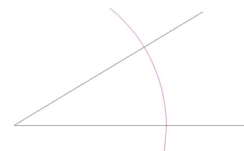

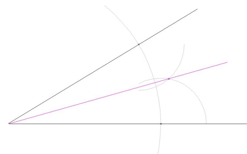

You need to use a pencil compass. Draw out the two edges on a piece of MDF/cardboard/lining paper. Draw a partial circle from where the two lines intersect. This partial circle must intersect the two divergent lines:
Using the points at which the two partial circles bisect the straight lines, draw two more (partial) circles which intersect:
Draw a line from the point at which the two lines intersect through the point at which the two smaller (partial) circles intersect:
You have now bisected the angle. This is a standard mathemetical approach which I was taught at school AND when I served my time. Anyone who calls themself a carpenter should have a pair of dividers or a pencil compass to achieve this - or know how to make a trammel (basically a piece of 2 x 1 with two panel pins knocked through) to do this.
Oops! I was fiddling about doing the same as Dave, but the dwgs take a bit longer......... :oops:

I was only faster by cheating and finding the drawings done! :)
