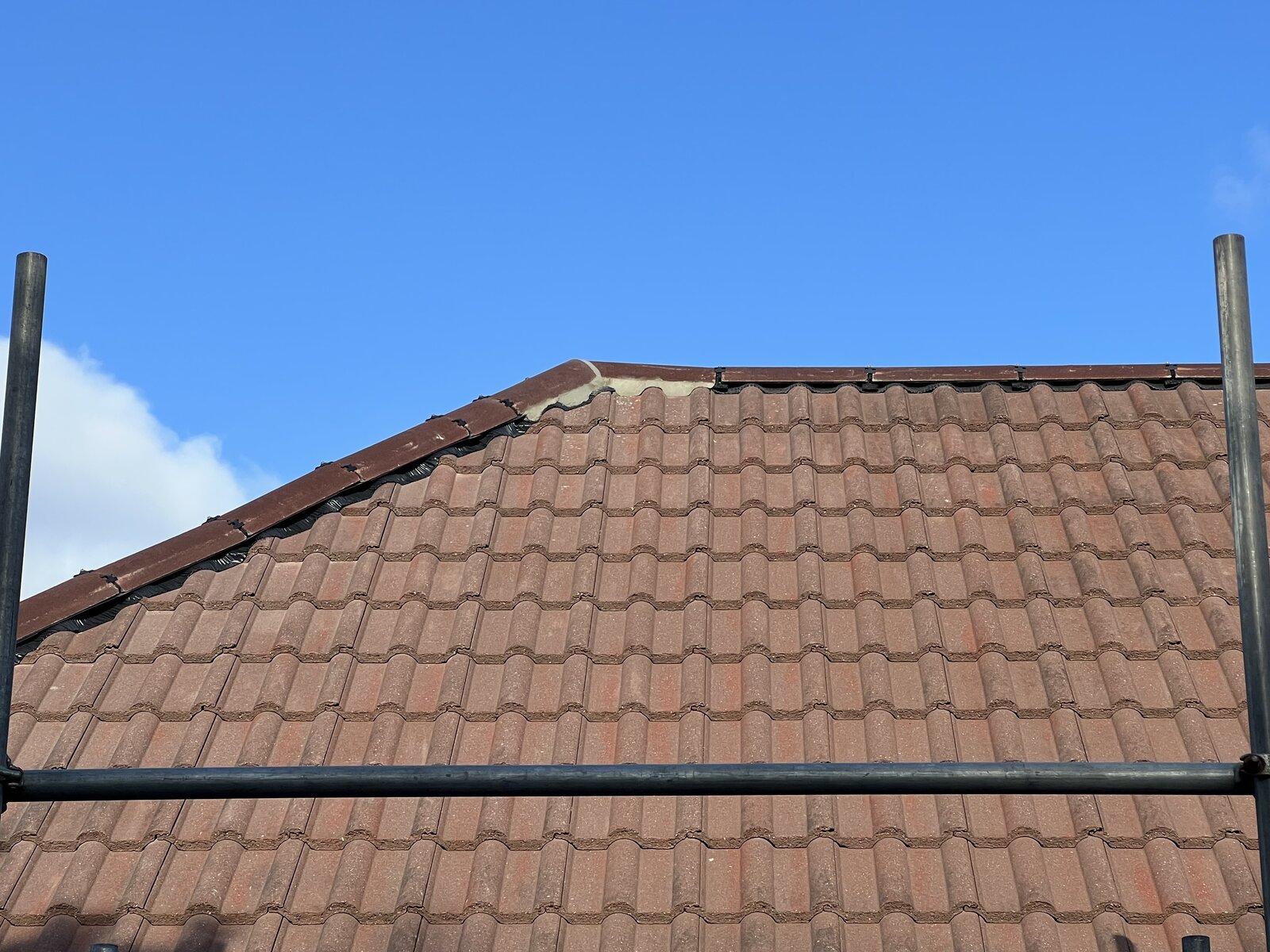

mitres joins to ridge and hips

I just wanted to know what people in the trade thought of the mitre joints to the ridge and hips. Should it have been in black, at a leaser angle, less cement? Wife is not happy!!

But very black would have been better at first , until it fades.. better still use remix.

I just been out and checked, they did use a remix product. Does that weather better?

but getting back to the OP, the end tile on the horizontal looks like it is not level, thats why it looks wrong

I believe that end is not horizontal as there are 3 layers of membrane on that "Y" corner. I do think it's too much.

Getting back to your roof, for me it looks wrong cause its not level, I have no idea how you sort out the 3 layers of membrane, but it must have been done wrong or badly.

remix they used. Bedding on the ridge roll isn't ideal .why the odd colored ridge?
Not a roofer however I agree with your wife, looks sh1t. Does the end need to be cemented, I thought no with these dry systems?
Probably because you are not a roofer you wouldn't understand why it's been bedded on this tile and ridge combination .
Regardless , it is untidy
Can you explain why required? Not asking in a pr1ck way, genuinely interested. According to Marley guidance an apex cap can be used with their dry systems and all concrete interlocking tiles. So why not here?
