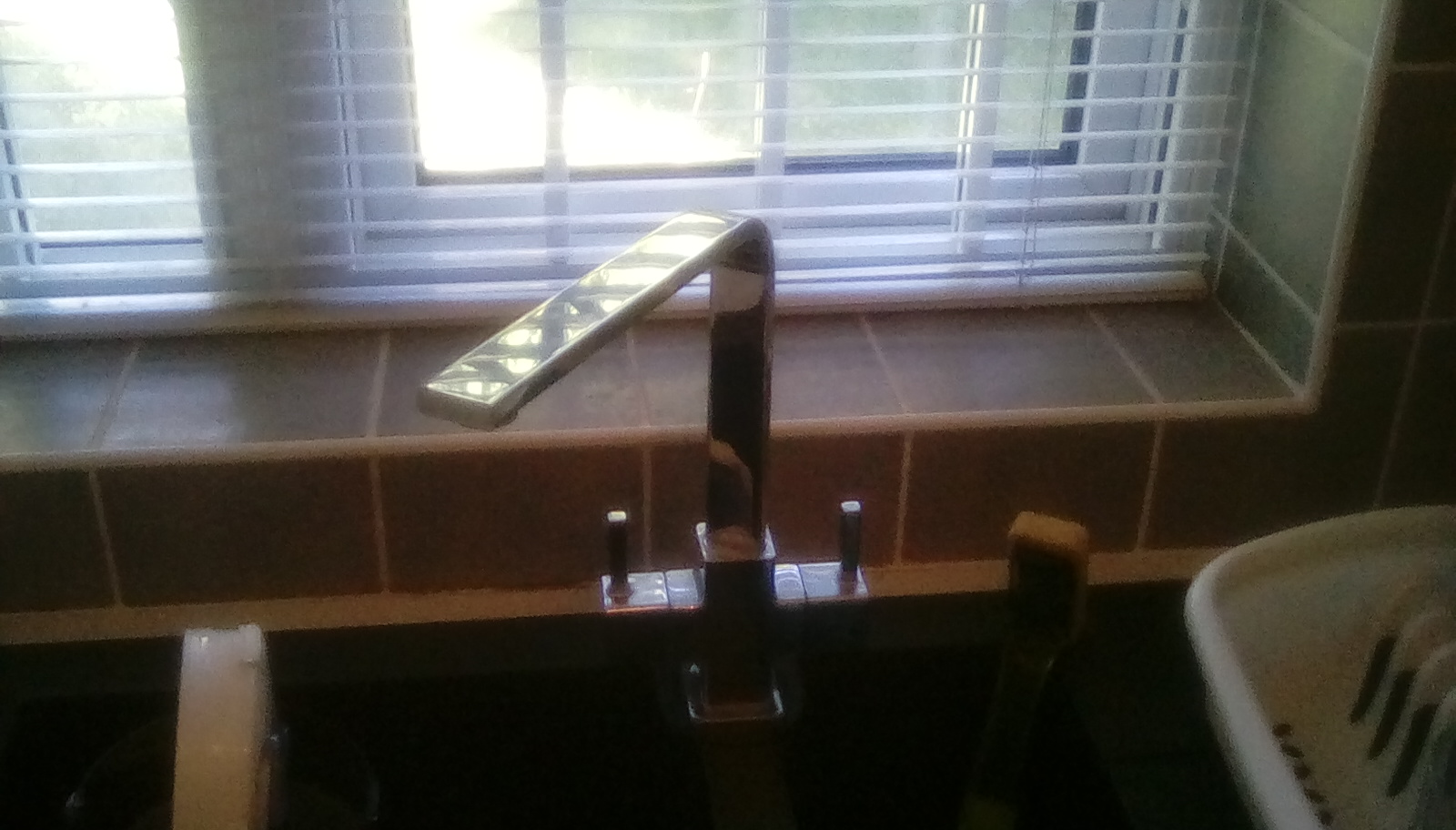

hi there,
i have a mixer tap which is dripping water.
do i need to take it out of the kitchen sink in order to repair it?
i could do with your advice.i
many thanks
rick
It's not necessary to remove the tap from the sink to repair.
It look to be fitted with 1/4 turn ceramic cartridges which will need to be identified and replaced.
Turn off hot and cold supplies, remove the 'handles', remove the cartridges, identify replacements and refit.
