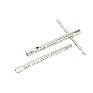

To change all you need is a box nut spanner set, its like a tommy bar with various sixe spanner ends. A few quid from plumding supplier.
You can use a pair of grips, but with no experience it may take you a while,so id go for box spanner
I take it the spout will/should pull out from the gland type of thing. and if i change the tap itself, Are newer mixer tap fittings/connections standard, ie this would be a straight swap....sorry to sound like a noob, but any chance of a link to these box nut spanner sets. MUCH APPRECIATED GUYS!!!! :)
By looking a tap, change it. Looks like its had its day anyway.
To change, its the brass nut behind the two pipes that neede slackening.
