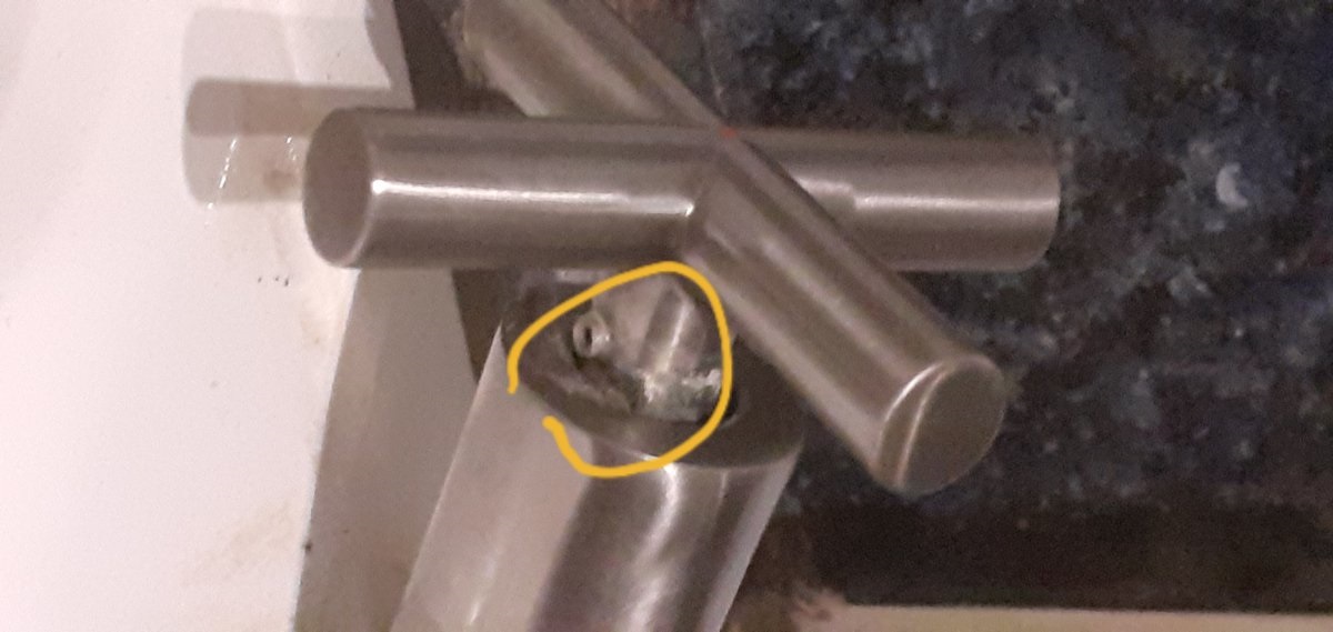

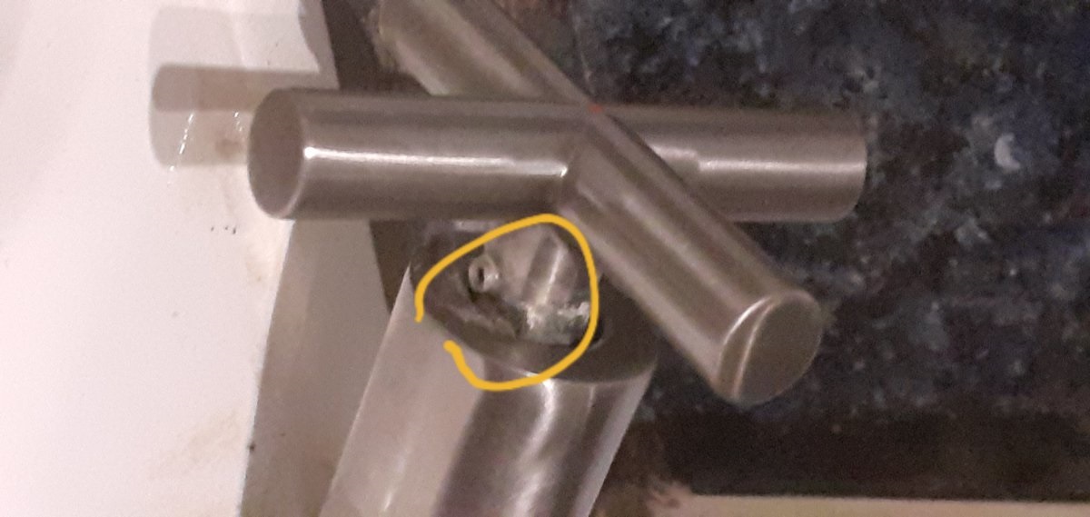

My tenant reported that he was unable to turn off the hot water on the mixer tap so was having to use the stopcock each time. I was hoping I could open it up to look inside but the unit is secured by a tiny nut that I have no idea how to get off (see photo).
Does anyone know if there is a specialist tool for this?
just a diyer, , so not an expert , and dont know the tap itself, but when i have seen that type of thing before - is there an allen bolt inside that hole by chance ???
Do you mean I might need a small allen key to do the job? Thats possible.
yes, as i say - i'm not sure , but that maybe where i would look and see if a small grub screw is inside with an allen head

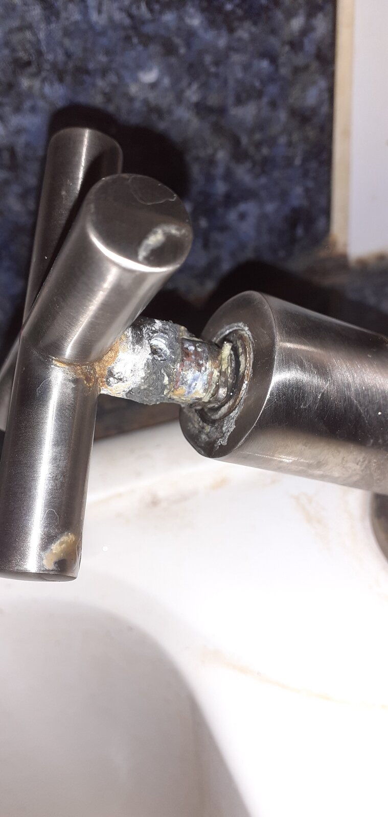

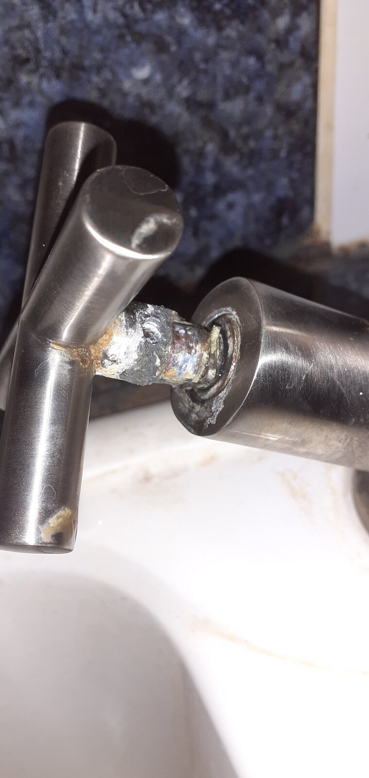

You were right. But having got the screw off this is what I'm seeing - a mess of limescale and rust, possibly corrosion? And although it's now loose I haven't been able to get it out to inspect, as I was hoping.
probably cheaper just to replace it all
I have soaked with limescale remover before , and managed to sort, but only comes back again
I was thinking that. Should replacing a tap be a DIY job? Just wondering (again) if some special tool would be needed to do it properly.

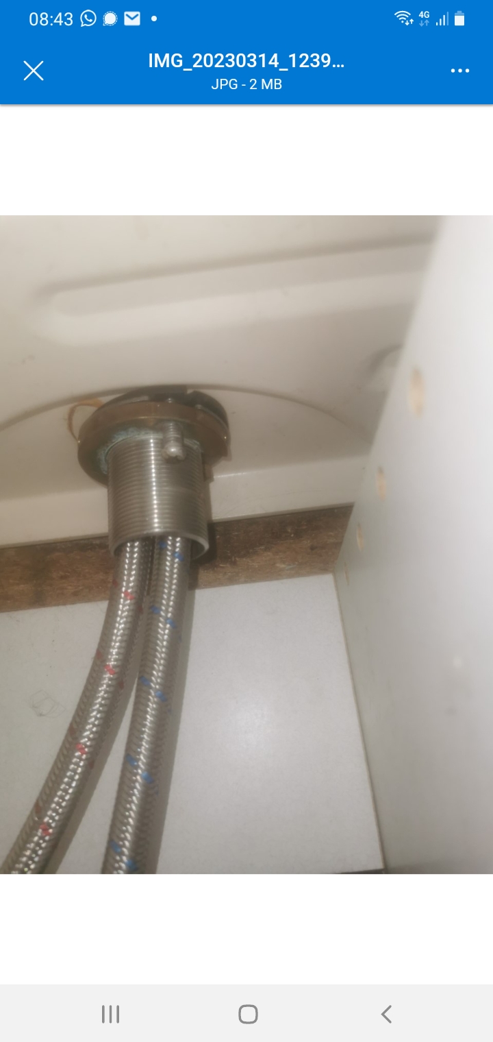

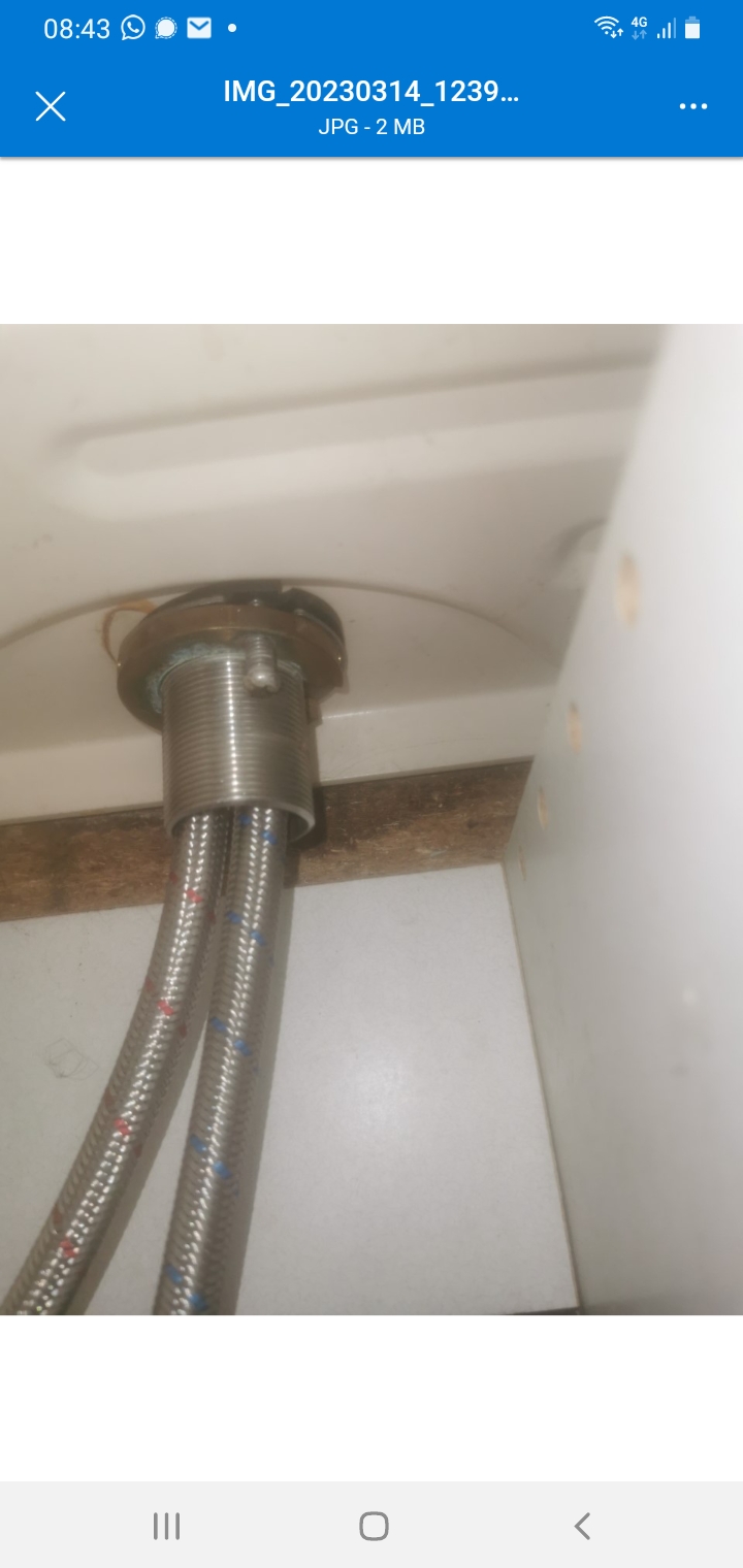

A photo from underneath would help
hopefully it has an isolation valve

This is what my tenant sent me. Looks like just a normal screwdriver needed. (Don't know why it's not properly screwed in unless he did that himself to make it clearer)
