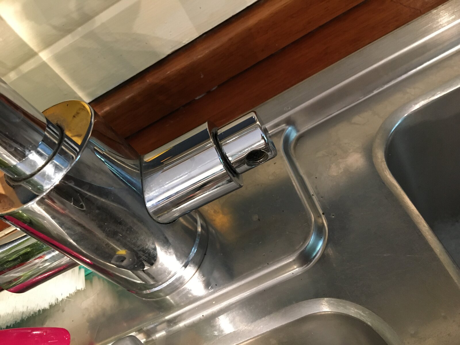

I've isolated the tap - thankfully installed with isolater, removed the grub screw which hold the tap end on but it doesn't want to move.
I assume remove the grub screw and then should be able to slide the chrome cover off but it won't budge.
I'm reluctant to start prising it with a screwdriver because the chrime is starting to go anyway and don't want to damage it
Any suggestions ?

Try a lubricant or wd40 perhaps or even just pour boiling water over it see if that gets it moving?
Err...well done on getting so far but you won't find a "washer" on a quarter-turn ceramic disc tap spindle.
Take both spindle (or "cartridge") and handle to your local plumbers merchant and ask them for a compatible replacement.
TBF Screwfix cover most replacement scenarios if you know what you're looking for.
