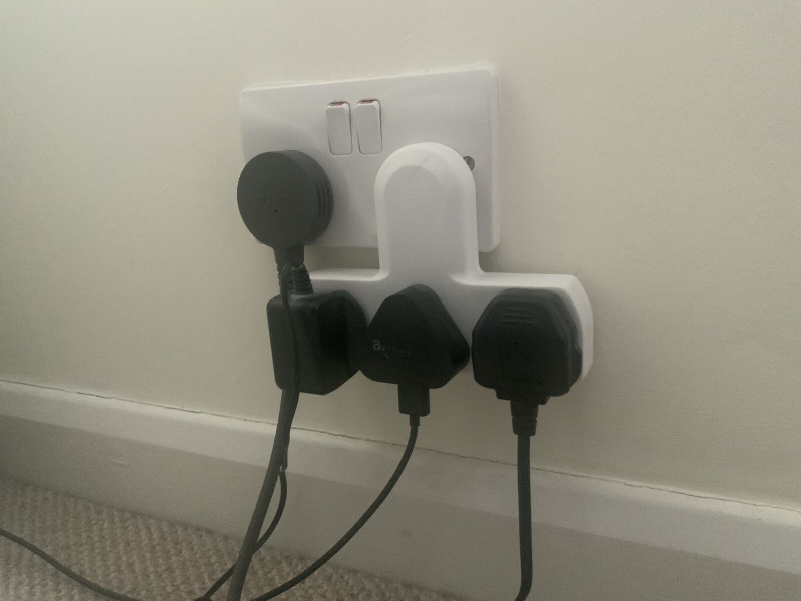

Here’s my triple/quad set up in the bedroom. TV, firestick, phone and in the summer, the fan.
