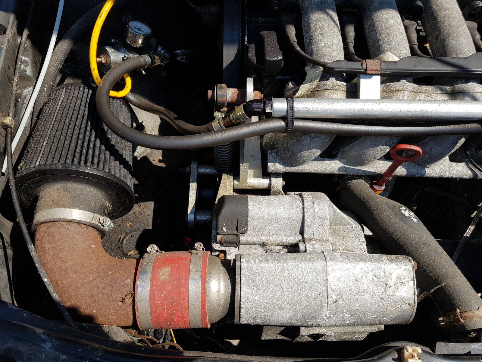

Owned her for 18 years, started life as a 16v (k-jet), over the years I converted it to EFI and bolted a G60 supercharger to it (sounds simple!).

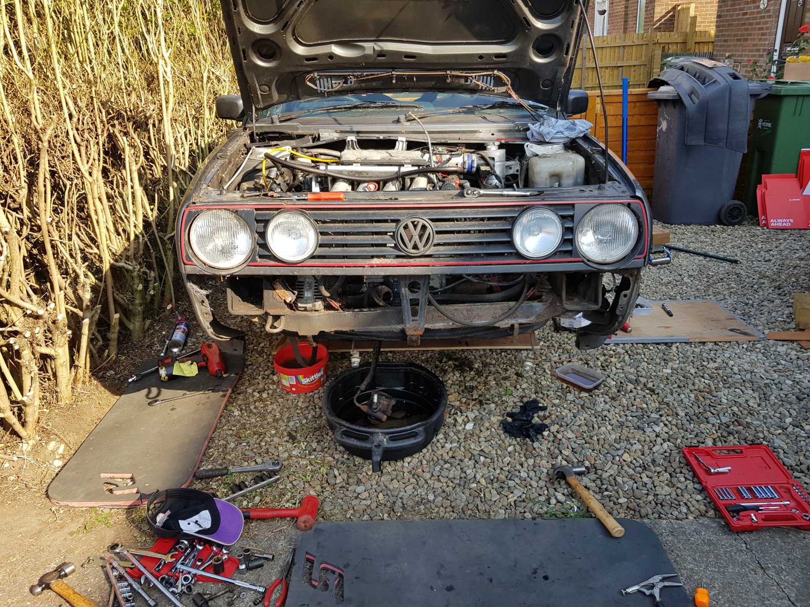

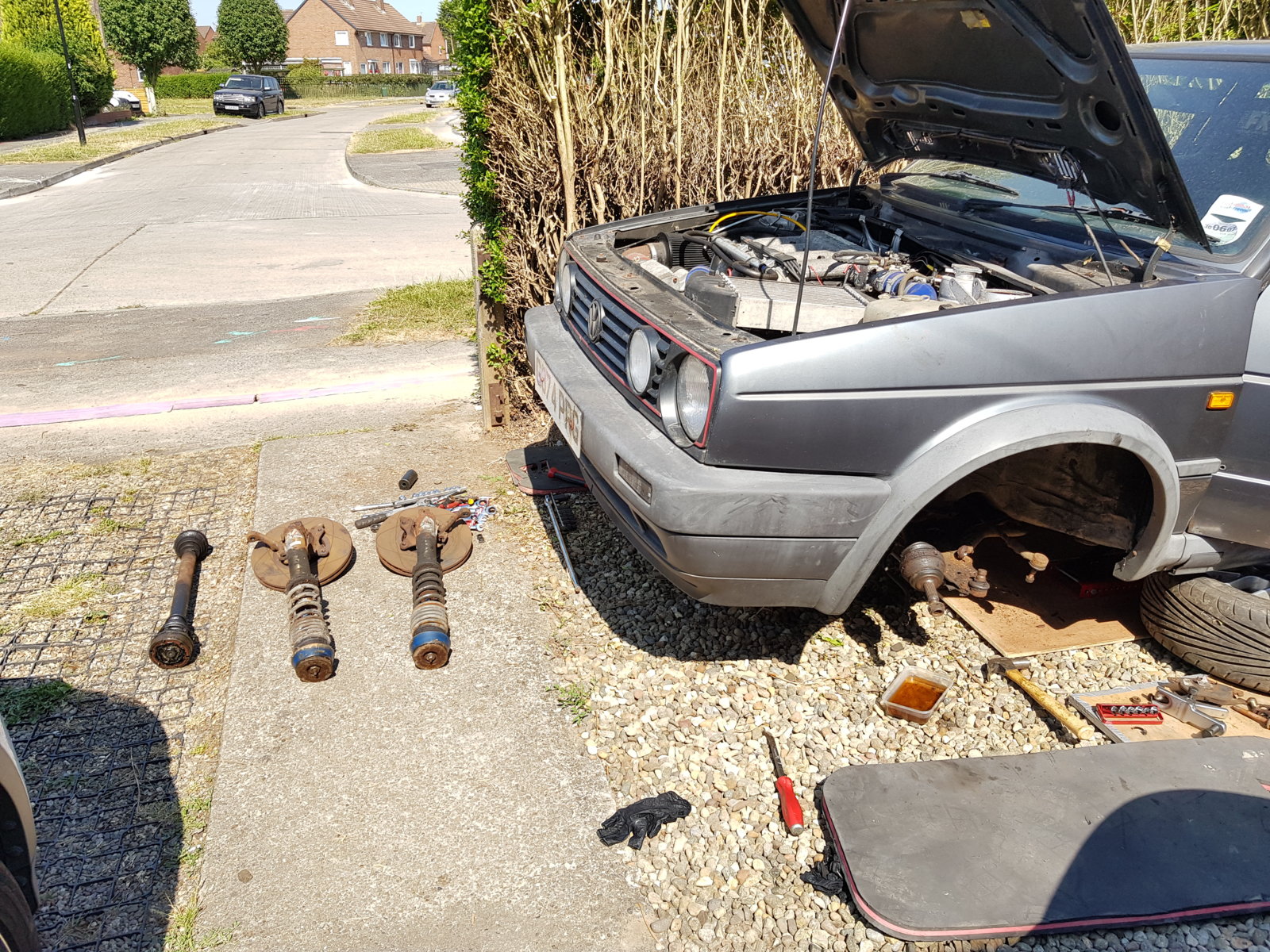

Anyway she's been stood for 10 years so time for a full strip down and refurb, engine out, new brake lines, crossmembers etc repainted, new steering rack, belts etc.
Made a start on Sunday (was baking hot!).

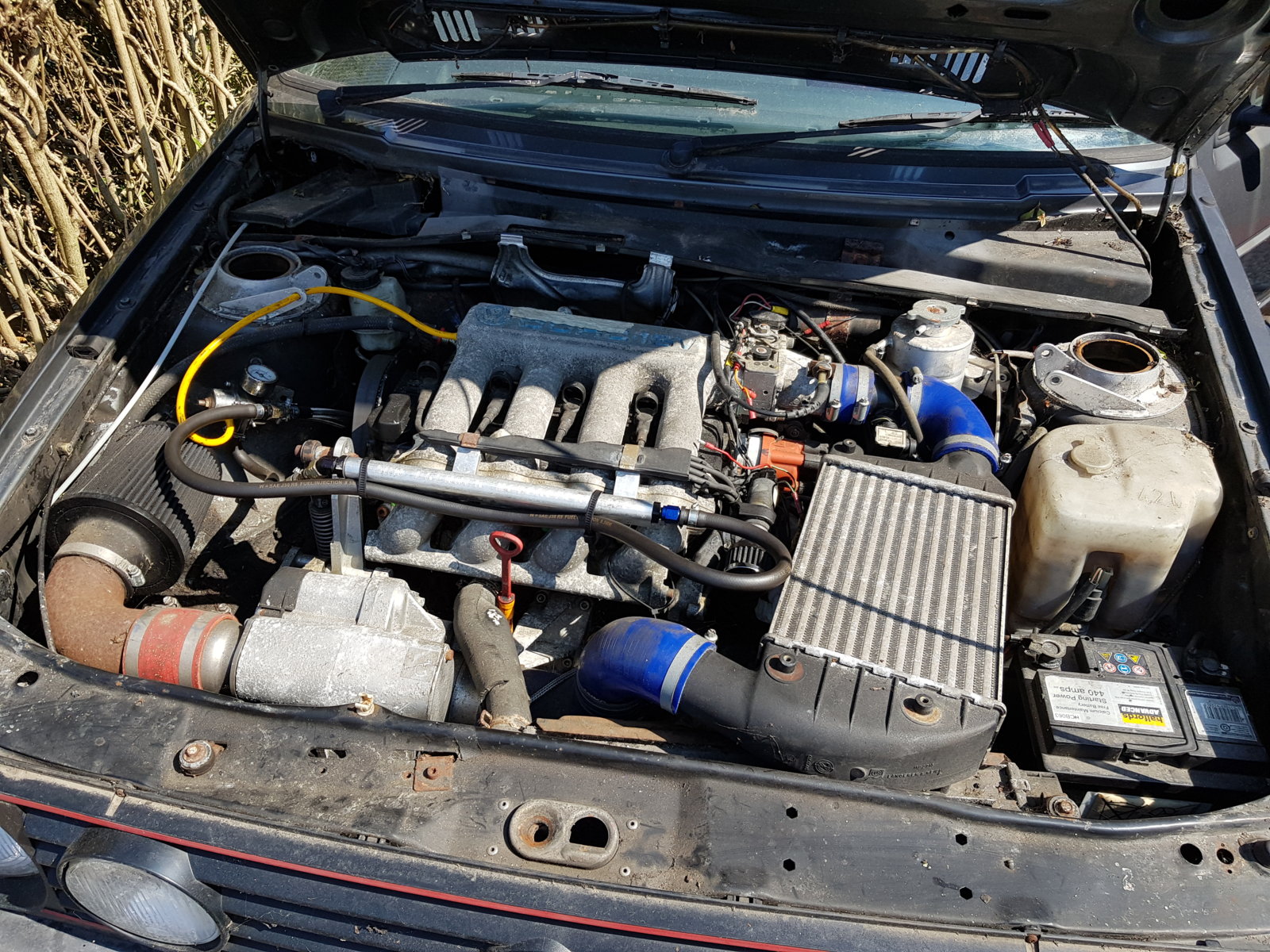

Keep the pics coming, Keith! How are you going to get fresh air into the inter cooler.....bonnet scoop, maybe?

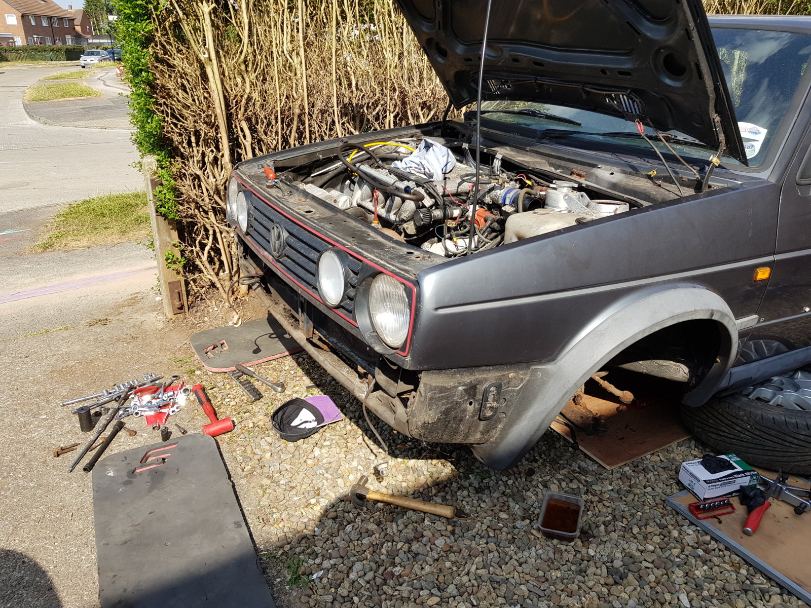

Is that flaky underseal and rust on the NSF A pillar under the wing?

I am mulling over a front mount IC or a scoop (bought one years ago), think the scoop may ruin the lines though?.
I had Aquamist water injection as well which could be going back on, had mutiple trackdays at Donning with no issues with WI fitted!..

Picture make it look worse than it is, any spots that look iffy will be getting brushed back to bare metal and inspected!.
Borrowed a ramp to fit AN-6 braided fuel lines a while back and had a good poke about, shes very solid still!.
I think a front mounted inter cooler would be best, if there's room to get it in.....
Not convinced about water injection though, it just hasn't caught on - wet steam was another one.
I can't comment about either , but lowering the temperature of the induction could possibly increase the oxygen content.

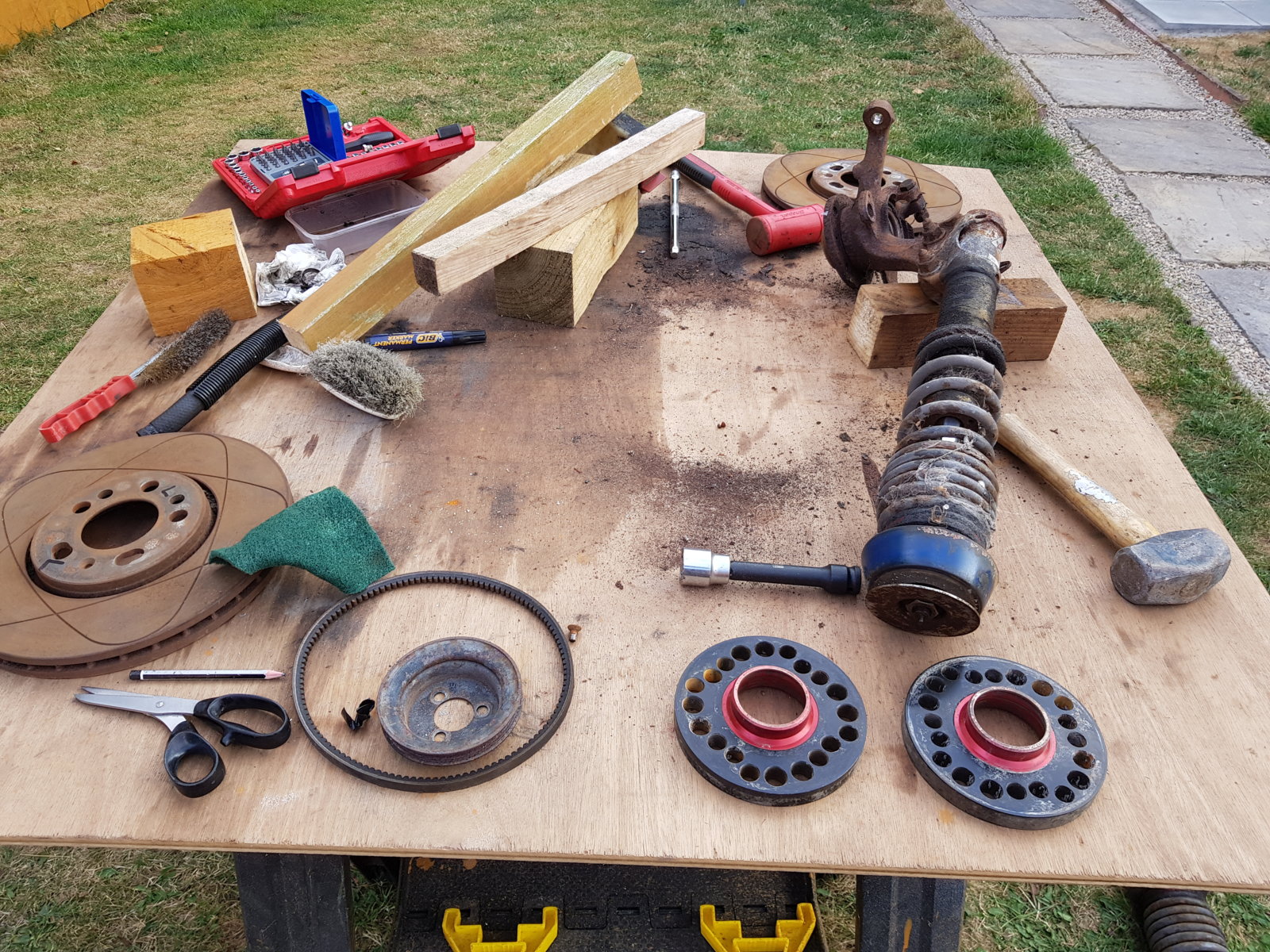

It's got Powerflex Poly bushings throughout (rear beam, wishbones etc), they all look good as new and will go again!. The Neuspeed ARBs have rose joints that look well past their best though, probably going to be hard to find replacements!.
I have used water injection on my GTO Twin Turbo to good effect, had the ability to log the factory ECU "Knock Sum" and was able to push more timing and boost with water on.
Gone for a manual steering rack as well, will be a weekend toy and the PAS setup islong past it's best..

Are you sure about deleting PAS? It's going to be a pig at low speeds without.
