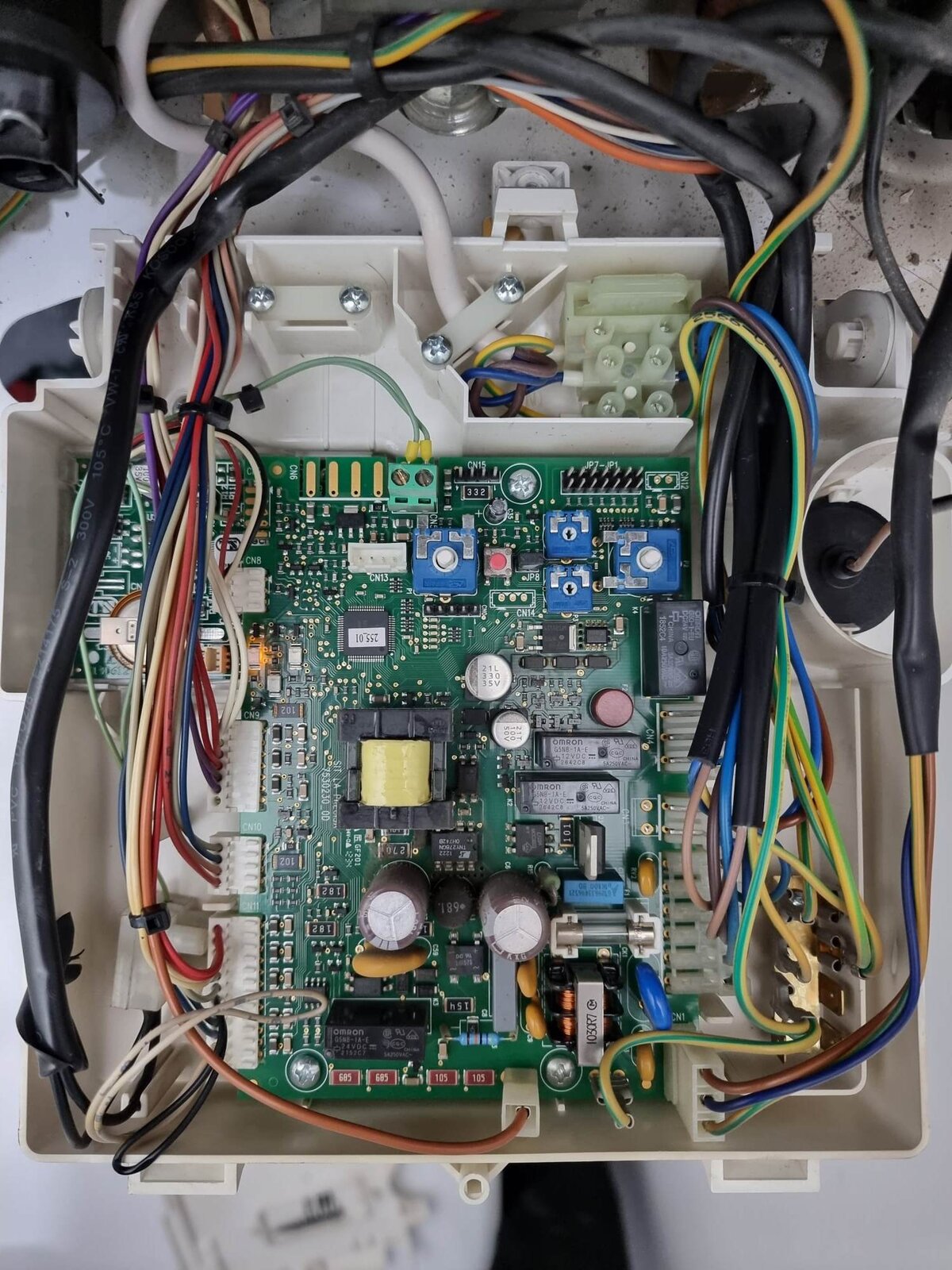

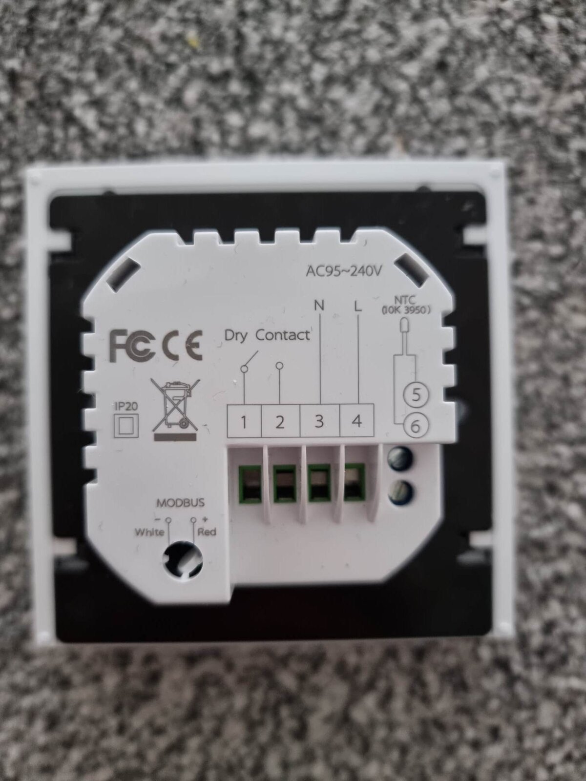

Hi
I would like to connect a thermostat because I don't have any so I bought a Moes ZigBee thermostat ( i want a local homeasistant control coworking with Mose zigbee TRV) and my boiler is a vokera vision 30c but I don't know on a 100% how to connect that and I don't want to damage my boiler on a winter time so im looking if anyone could help me

DO NOT make any links in the thermostat as you may have seen in other posts similar to yours
Dry contacts on the thermostat to CN 5 on the boiler control board (remove the two turquoise wires and make them safe).
The clock on the boiler will still be active but not used. Keep it as it will give boiler information.

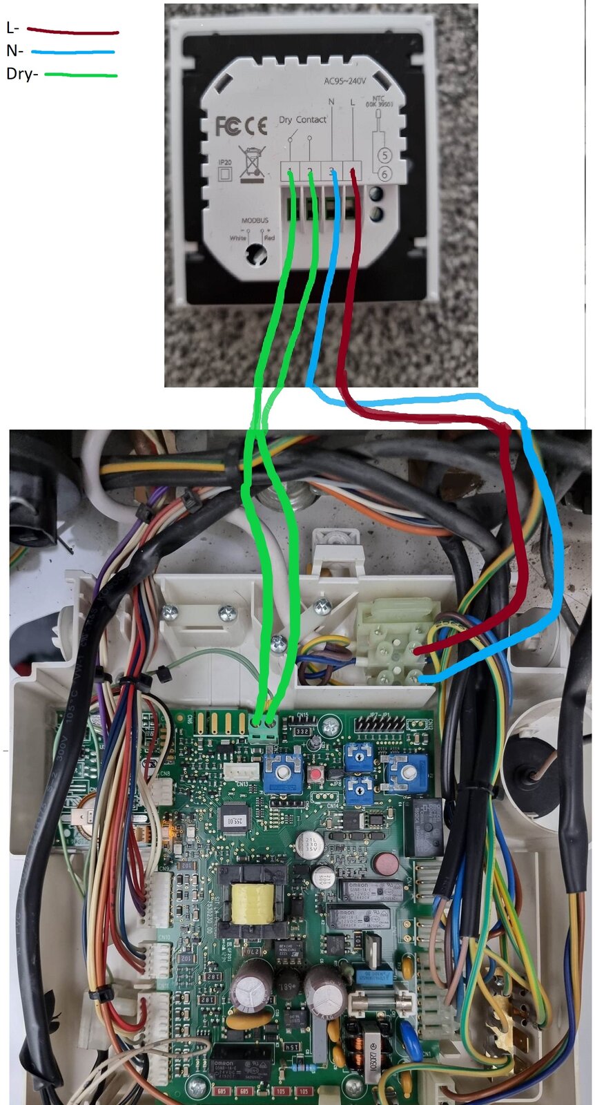

So it should look like this?
I did not mark the exact terminal from which live and neutral should come out, only the place from each I should connect

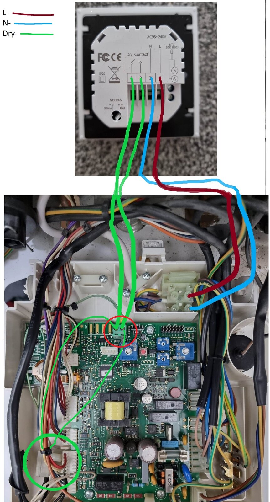

or like that, dry contact not in the place marked with a red circle, but a green one
