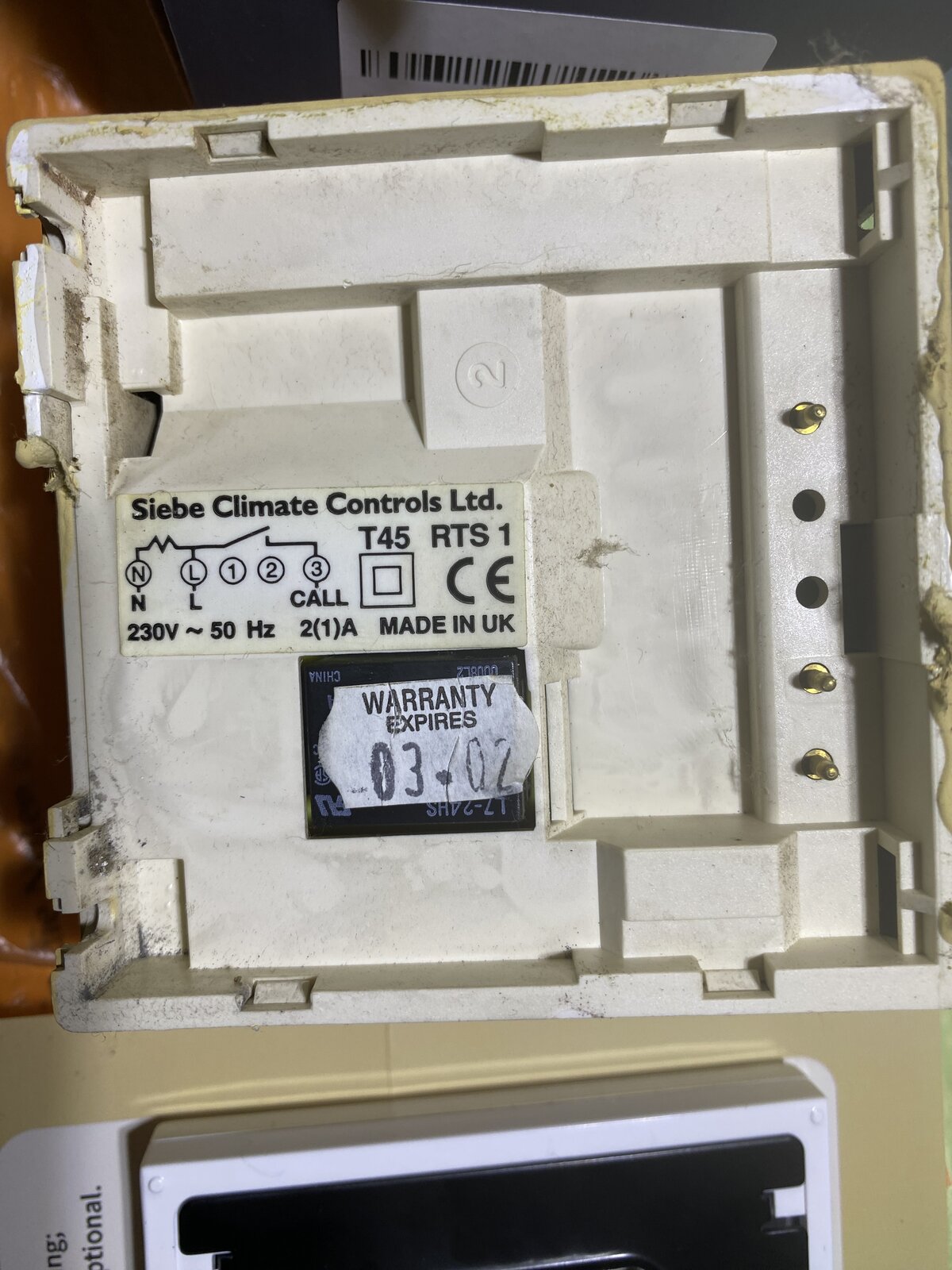

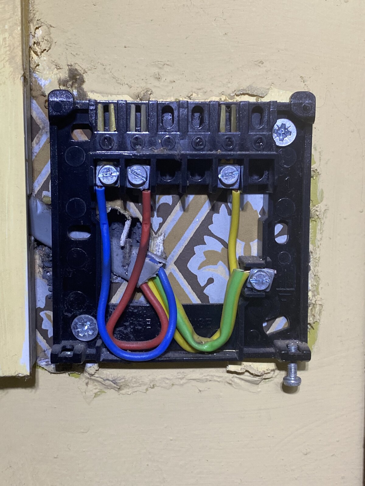

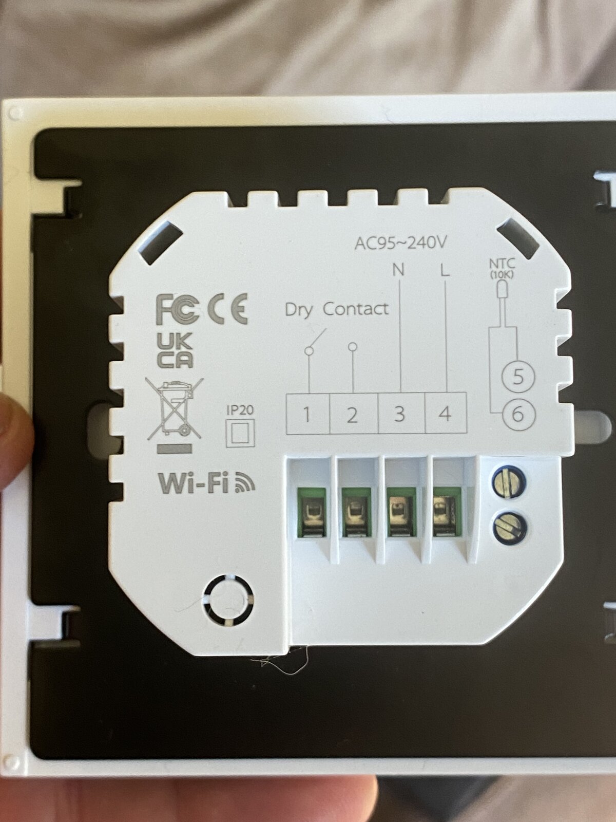

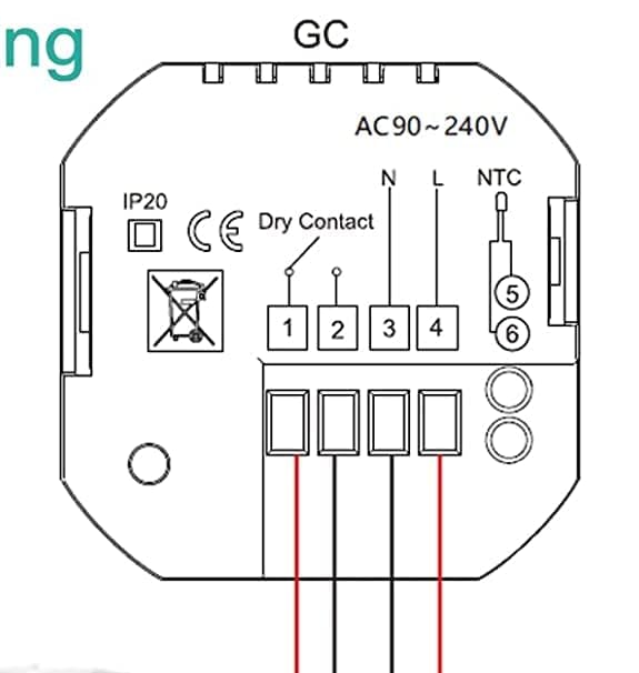

Looking for some advice please on replacing my old traditional thermostat with a MoesGoe WiFi Thermostat (GC model).
My existing thermostat has 3 connections plus earth (blue, red, yellow). The new one seems to want 4 connections (doesn't mention earth).

Brown L to terminal 4 (L)
Blue N to terminal 3 (N)
Yellow to terminal 2
Add a small link wire between terminal 4 (L) and terminal 1
And isolate the earth connection in a separate terminal block, tucking it safely out of the way.
All done - up and running - a simple job with the advice from here.

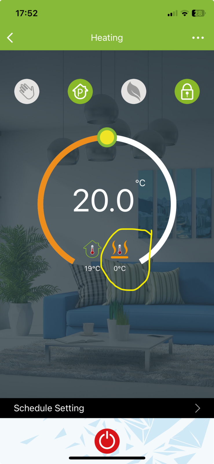

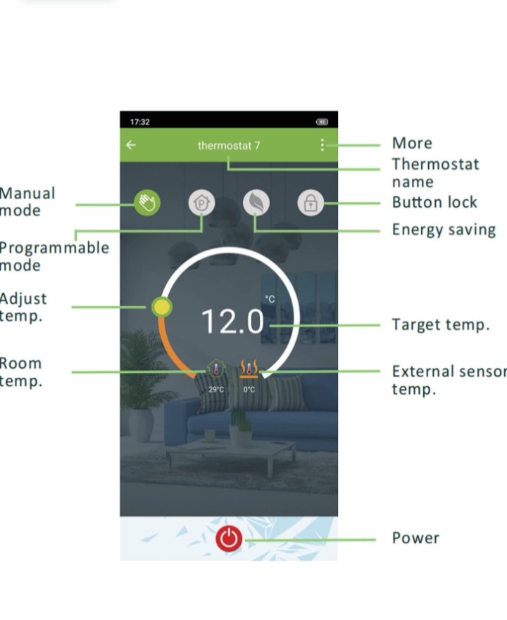

One question if anybody knows the Smart Life app that I am using with the thermostat.
Any idea what the 0 degrees icon means on the app? Wondering if it is a minimum temp level - but can’t see any way to edit it.
External temperature sensor reading, apparently.
I doubt you have one of them! :)
It may be possible to disable it?
Ah thanks.
