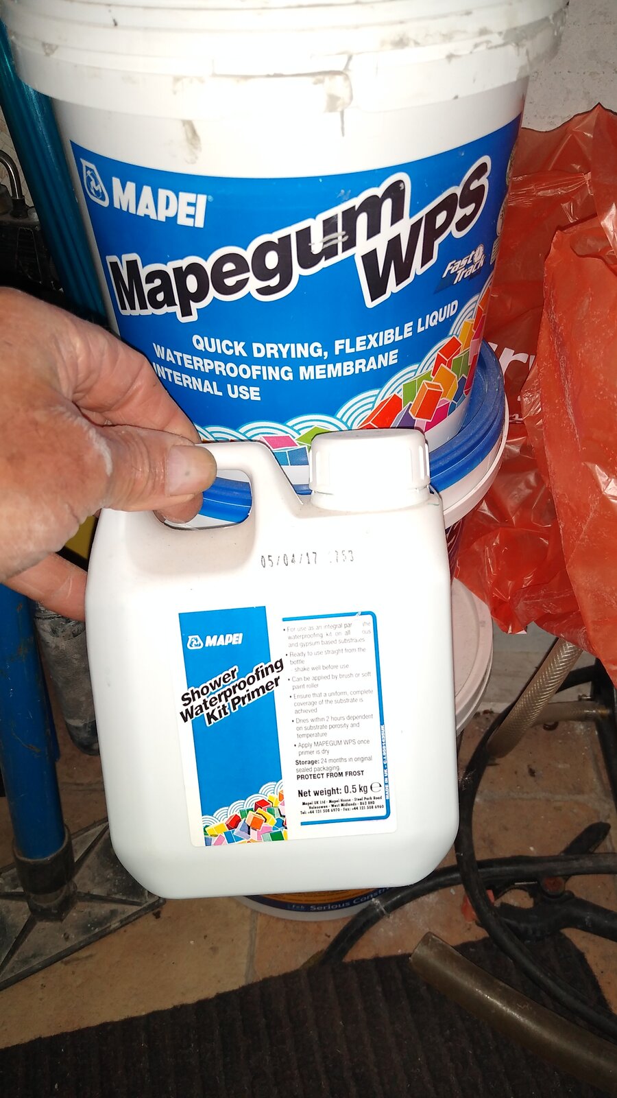

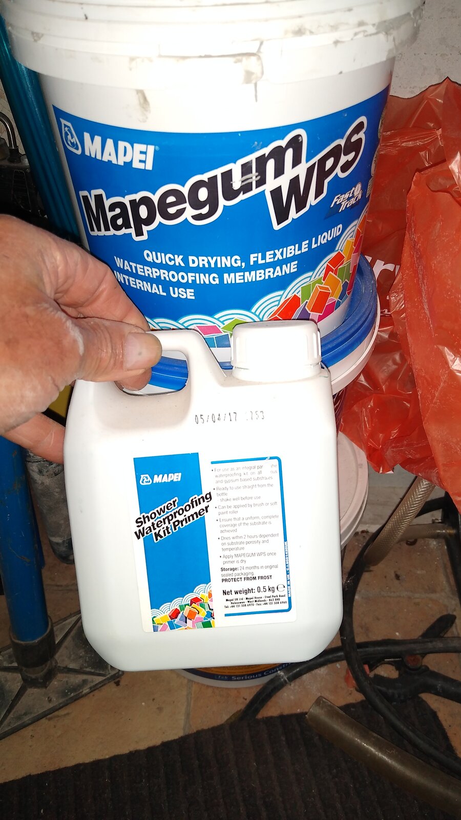

One question i take it i apply the sbr bal bond first before the tanking?
IMG_20200704_164433080.jpg Some tanking kits come with primer so check first.
