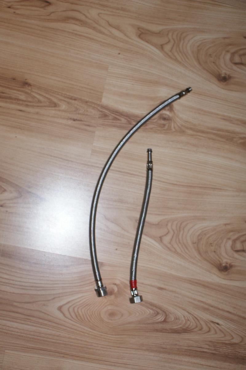

Hi All, I have just tried to replace the tap in my kitchen sink and all went well until I tried to connect the tails to the water supply. The old tails had a female screw compression fitting and the new ones have a male compression fitting. I have been to B & Q, homebase and Wickes to try to buy a 15mm female x female compression coupling but none were to be had at any of these. Can someone give me any idea how I could fit these new tails.

Hi, the old tail has a female nut that screws onto a male fitting but the new one has a male fitting on the end, here is a photo.
GALLERY]
the old ones would of connected to something like an isolation valve.
to connect the new ones you'll need a length of copper pipe in the isolation valve to the new compression flexis.
you can take the iso valve off and fit the new compression straight to the pipework but it's handy to keep iso valves in the pipework for later on.

Hi, Thanks for that but as I am a complete novice I am not sure what you mean, is it possible to post a picture of the set up you are talking about on the 1/2" iron with a flat face. You are quite right the old tail was fitted to an isolation valve and I did think about taking it off but as you say it can be handy to have this. I'd rather go the other way.

all you need now is another nut/olive fit that to the isolation valve with
a section of copper pipe, then fit your new flexi to the copper pipe.
this is a male iron elbow
you'll notice the end of the thread is flat as the iso valve has a chamfered edge for the olive to fit.
which can damage rubber seals of flexis if tightened to much.
in your case won't matter as you have no need o use them on the new tap.
Hi, Thanks very much for that, I'm off to get my pipe and nuts and olives and I'm sure all will be fitted soon.
