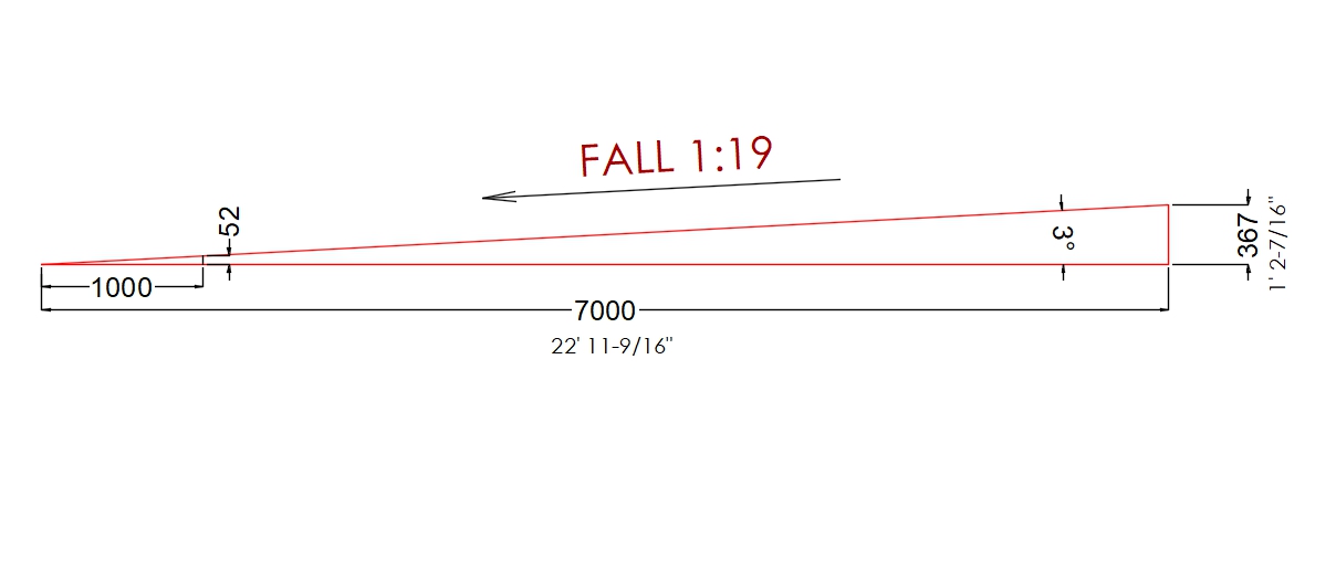

I have done a fair few cut and pitch roofs but strangely have never done a Monopitch "Flat Roof"
I'm trying to work out the rise over the seven metre length.
My maths says the rise over 1 metre is 5.24cm
I normally work in feet and inches but to simplify it I've gone to mm.
Could one of the learned people on here confirm whether my Maths is correct please??
This help?

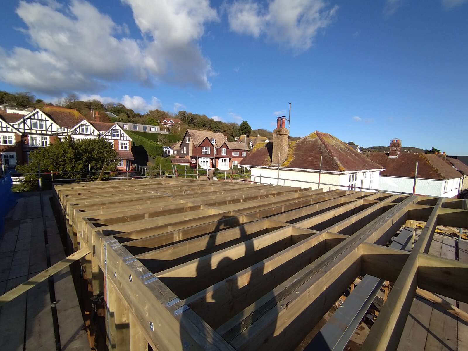

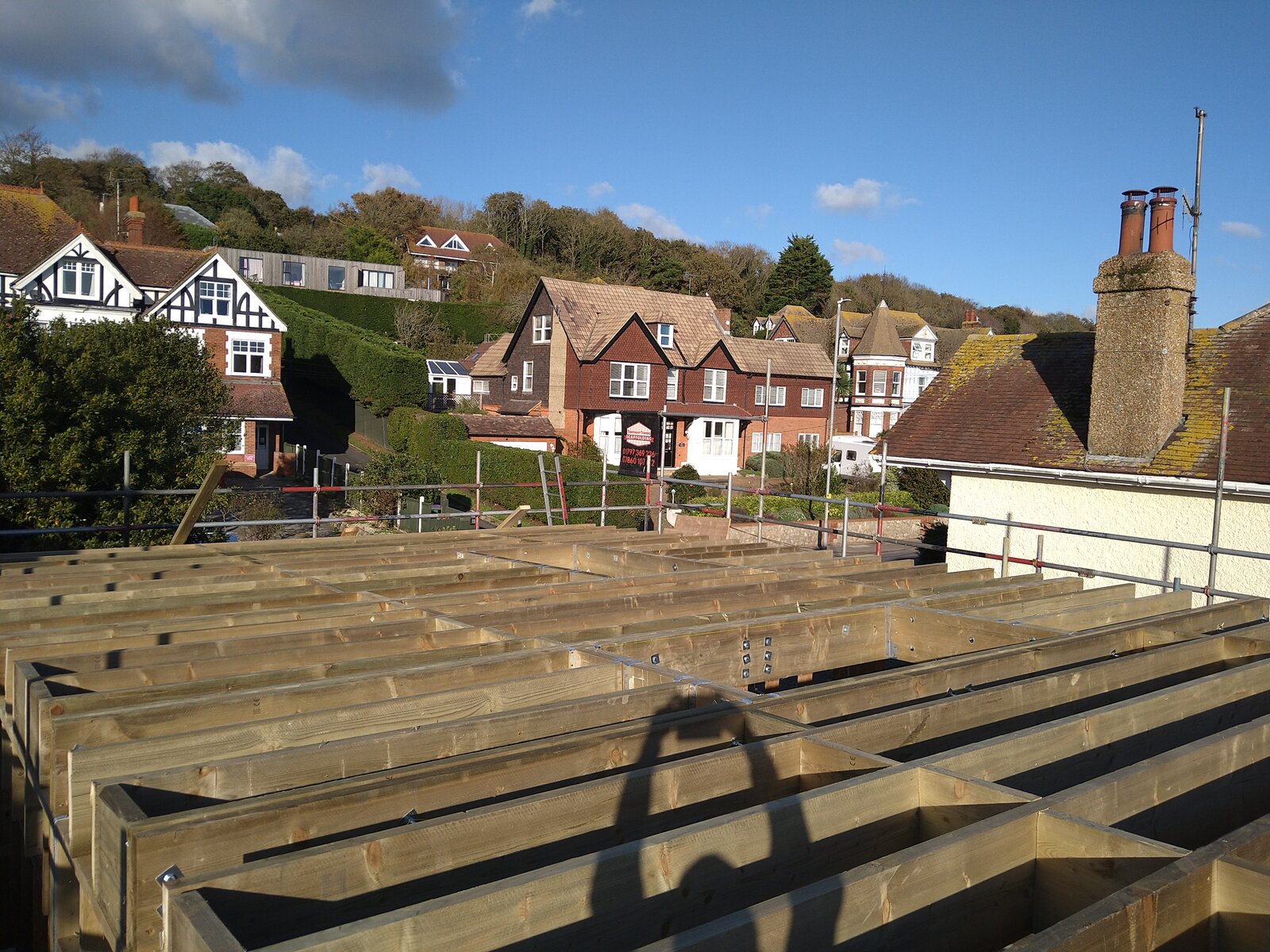

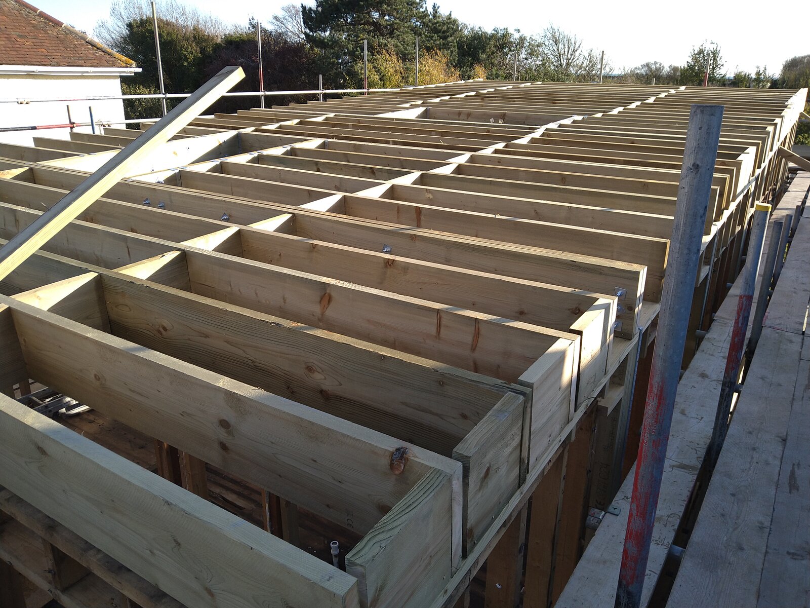

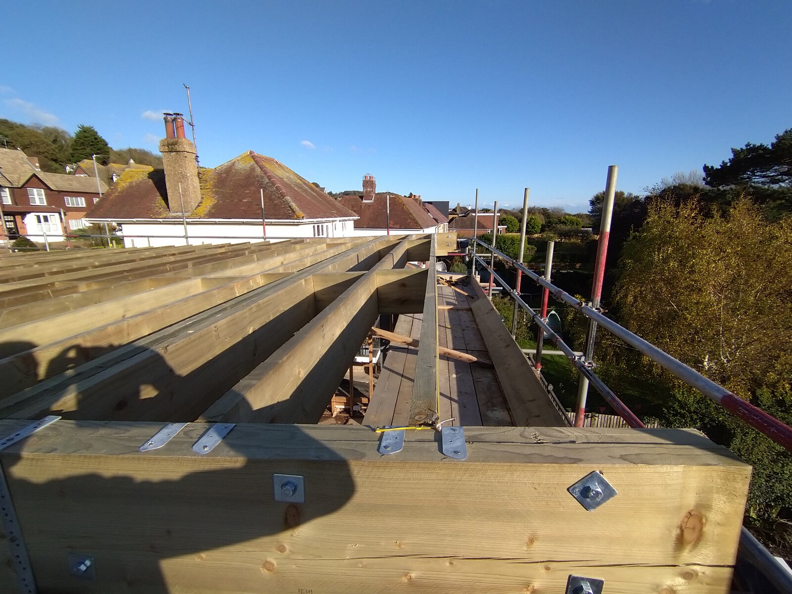

Thanks again freddiemercurystwin, roof done, incidentally the random noggins were to stop the joists falling over from 40mph winds, heavy blighters they were.
