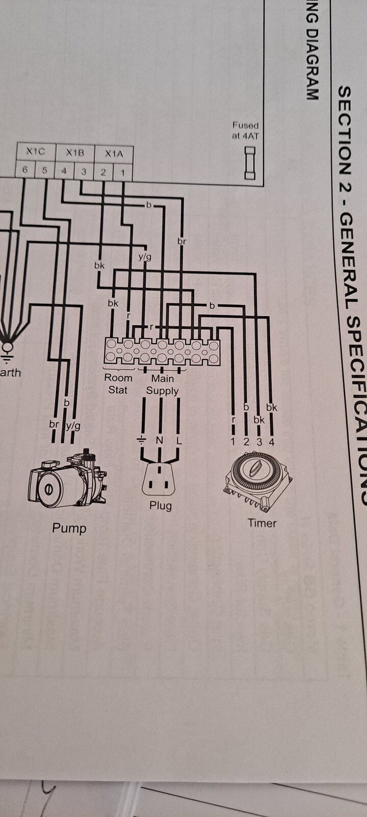

Hi, I am looking to add a Salus RXRT510RF digital wireless room thermostat to by Morco boiler that has the old style manual on of dial timer. It seems straight forward. I wire the receiver to the mains supply and remove the link from the block marked room stat.
questions.
- Is there a correct way to wire the wires from the room stat block in the boiler or can they go either way round. (which is NO, which is COM)
- Do I leave the old timer to ON.. and allow the remote unit to control?
